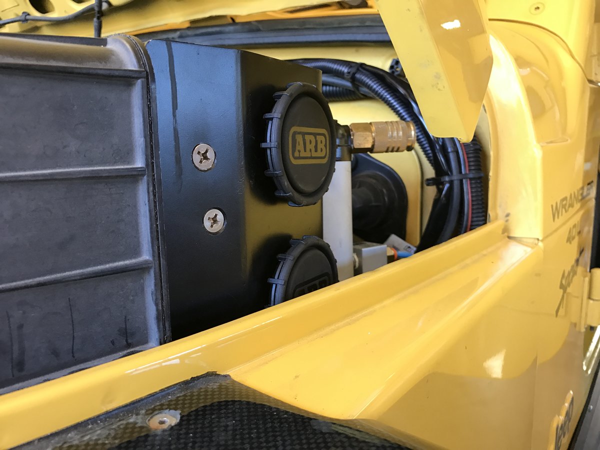

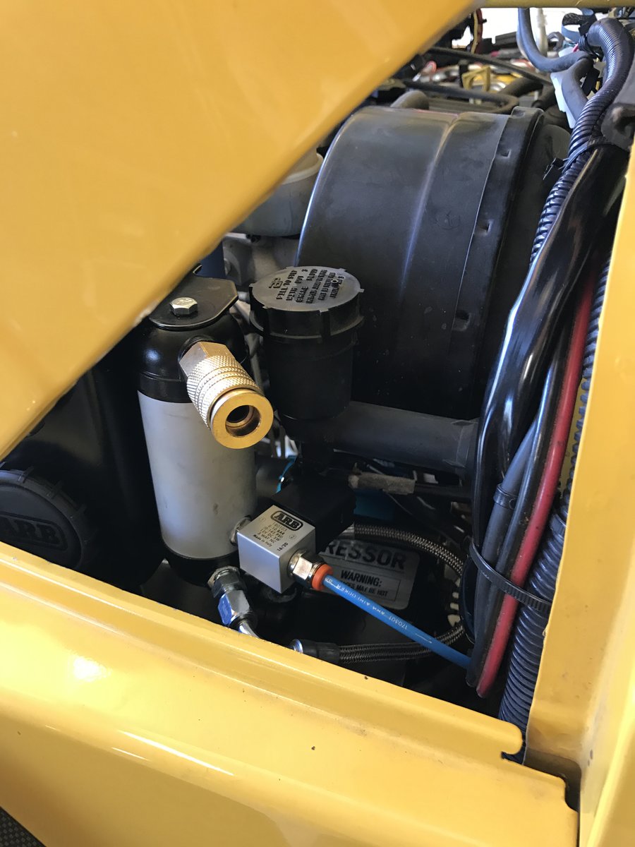

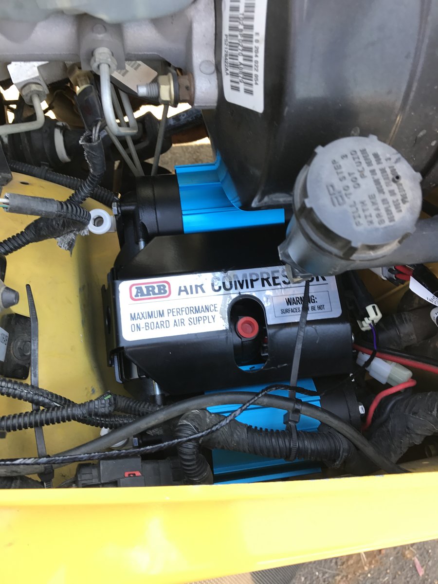

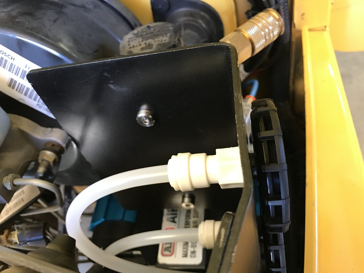

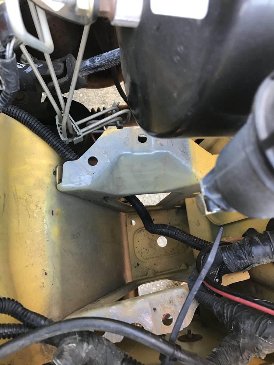

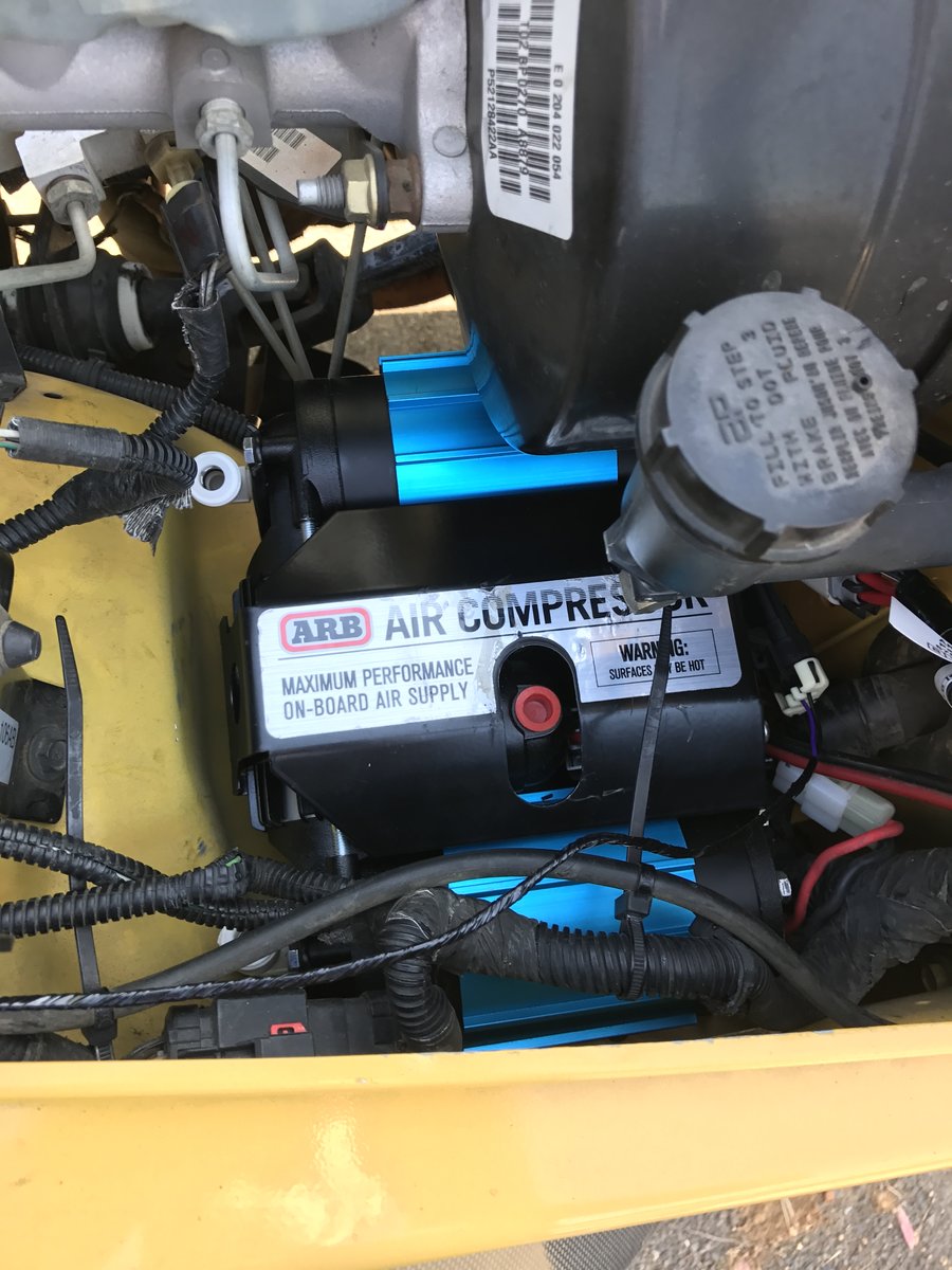

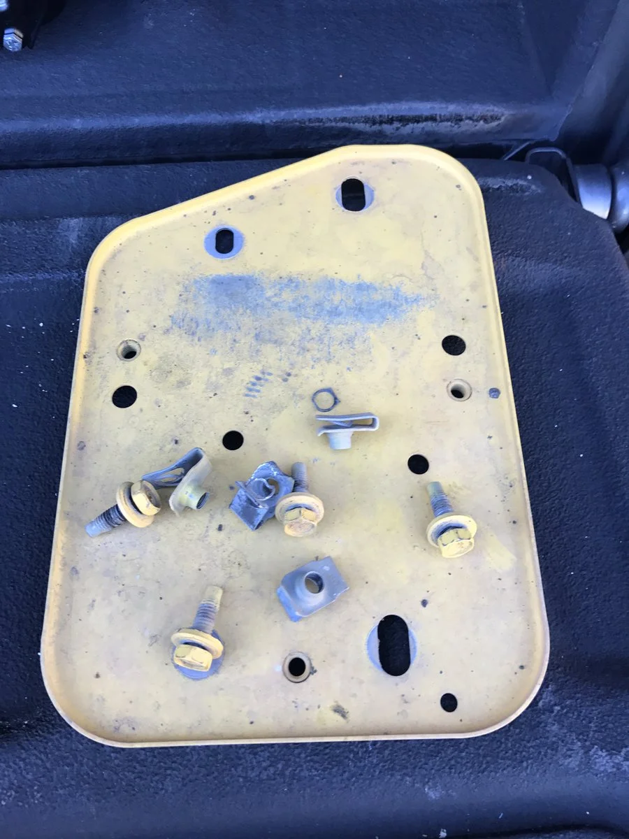

I took the servo tray out to let air circulate under it better, also I did remote filters to get cooler air and protect them from water splashing on them. Here’s a few pics I found.

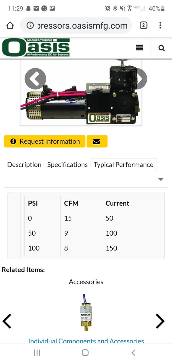

Almost never mentioned, probably due to the very high price tag. The Oasis compressor is quite impressive. Not sure it belongs in the conversation but if you want some serious air, this might be worth looking into.
I looked up the XD-4000. That actually is pretty impressive. 180 amps is going to require quite a large alternator, especially at idle. Constant duty cycle is very nice. $2,000 is a lot of money though.
But for half the price, you could have a belt fed compressor system that provides very similar performance and doesn’t require a $500+ alternator.

I took the servo tray out to let air circulate under it better, also I did remote filters to get cooler air and protect them from water splashing on them. Here’s a few pics I found.View attachment 156611View attachment 156612View attachment 156613View attachment 156614View attachment 156615View attachment 156616
Assume I can figure it out but as I have minimal (read as no) fabrication skills hope you don’t mind a couple questions. Thankfully I have a younger brother who has such skills so questions really are to make easier for him when I say please install this.
First question to make clear my lack of mechanical knowledge. What is that tray for?
Did you mount the compressor to the supports for the tray or remove middle of tray to allow air flow, mount compressor to tray, and then mount tray back to stock holes?
Did you put any type of isolator between compressor and where mounted? I’ve seen it mentioned but not sure if is enough vibration to make necessary?
For the filters and manifold is it just let Jeep/space tell you how to create the bracket?
The tray is for the cruise control servo, the compressor is mounted to the brackets sans tray. The isolators that come with the ARB are used but I substituted the hardware. The bracket was a “Jeep space” thing.

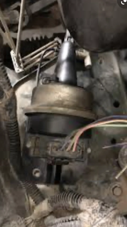

That tray is actually for the ABS module. The cruise control servo is typically mounted higher up on the fender, just behind the washer fluid bottle.

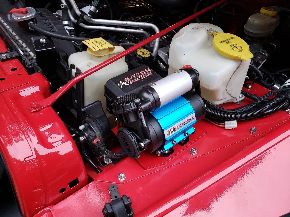

I use the ARB single. I didn't want to rob a lot of real estate under the hood with the twin. I just finished plumbing it a few weeks ago and takes about 2 minutes airing up from 15 to 30psi.

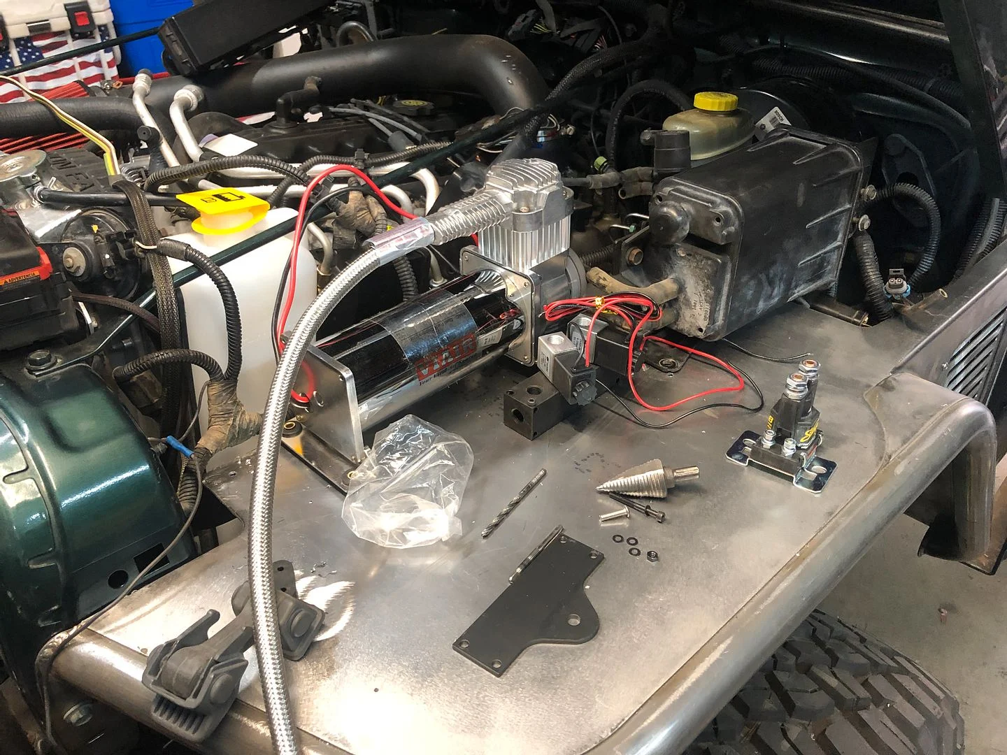

I am running a 400 series Viair and a 2gl tank. I can fill up (through my powervavles) in undert en mins. With the powervalves and tank, the first is about a minute. The tank rcovers a little while I switch and the second is about 3 mins, etc...

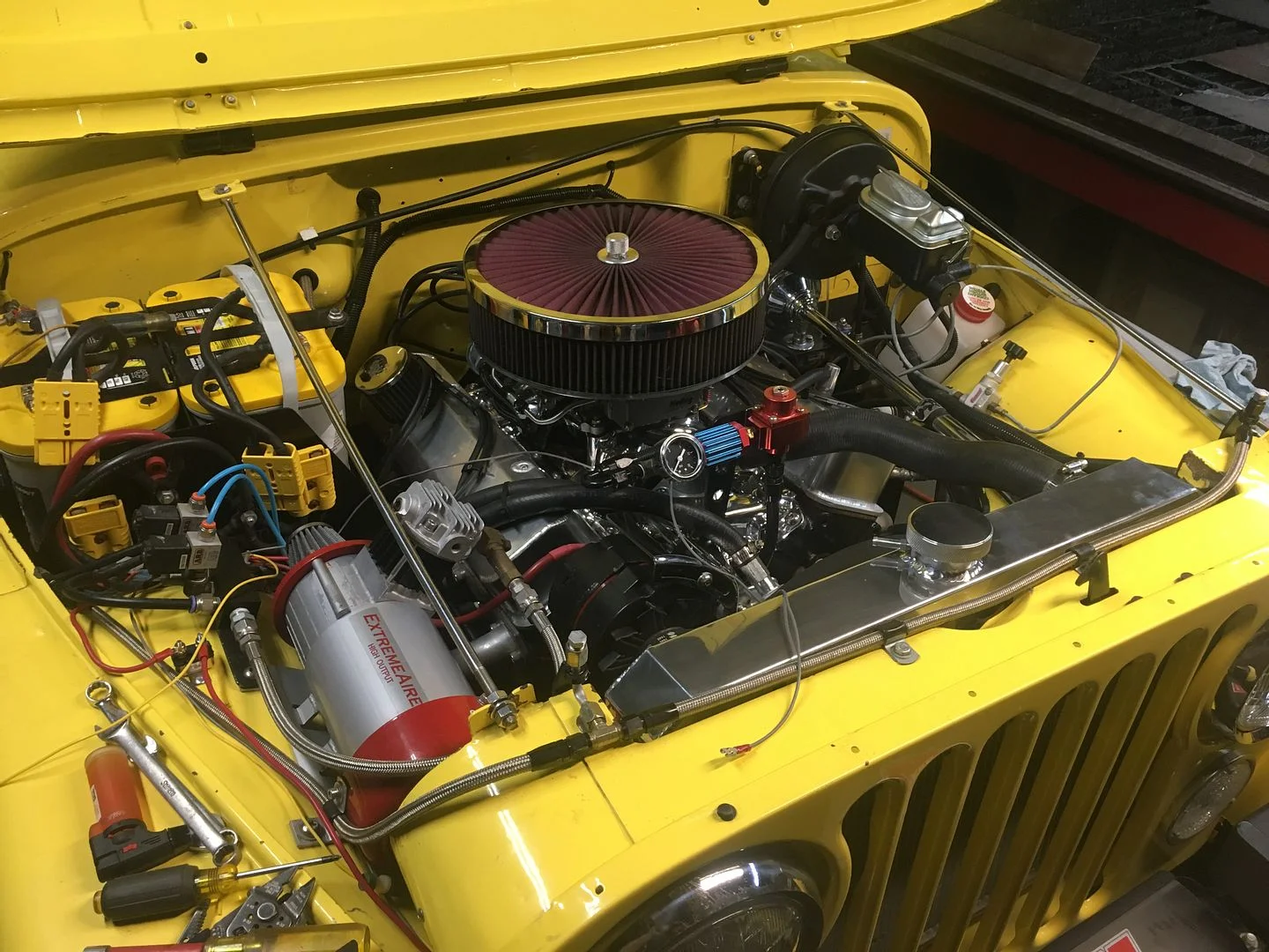

About the only pic I have of the compressor mounted

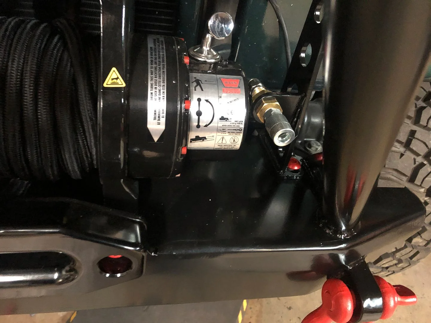

Have this on the front, I switched it to a Milton universal QC, it takes all the plug styles:
