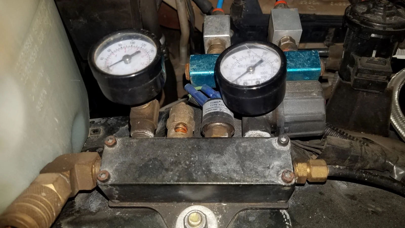

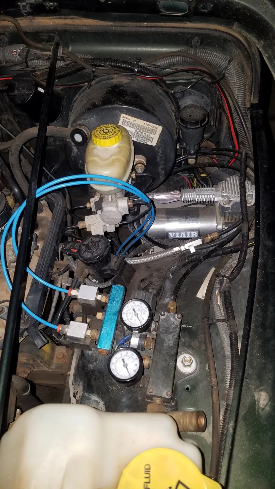

Picture of your setup? What parts are needed to get air to the locker?
Here is a photo showing my air distribution manifold. The gauge on the right is on a regulator that lowers the air pressure to 90psi for the lockers. The one on the left show what I have in the tank. The pump air goes to the tank then from the tank it goes into the manifold. The manifold has the pressure cutoff switch to turn off the compressor. And it has a 165psi blowout valve. On the end is a coupler for the air hose to run an impact or air up tires. The pump intake hose goes through the firewall inside cab and has filter on it.

oh and one thing to know the ARB air switches are metric, so you need adapters to mate up to the NPT in the regulator.
