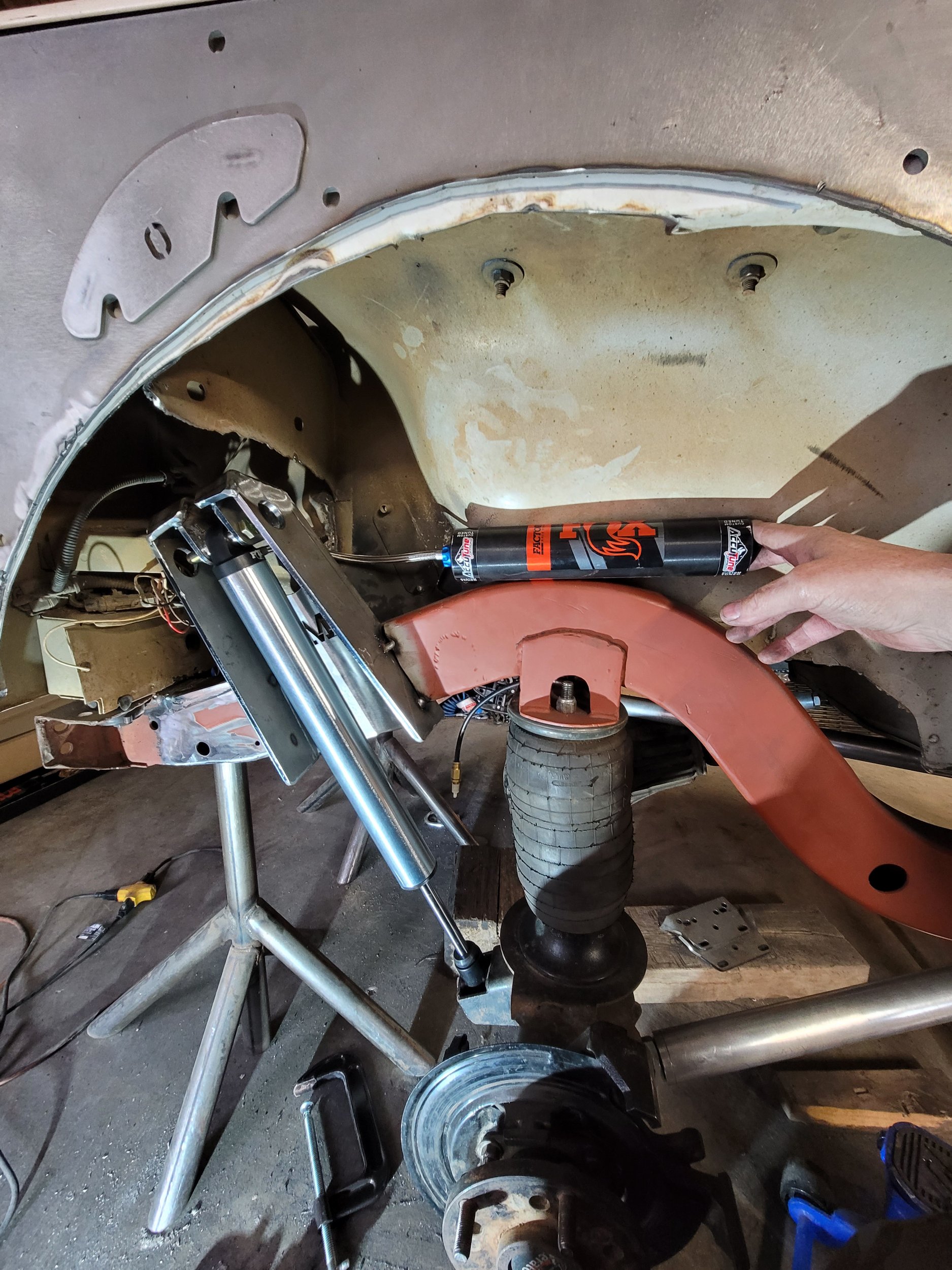

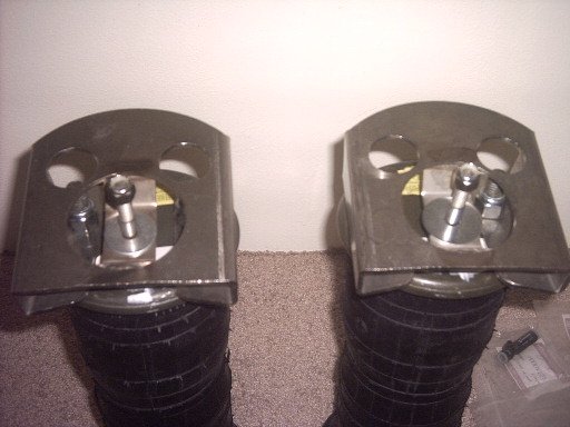

Did you try inflating it with that slight angle? Not suer what it's could do but just curious. The AiRock kit had these brackets that make the air spring sit a little more level but it still bowed some.
When I made my own brackets I have them centered over where the axle sits.
I slightly leveled out what the factory brackets were set at, I’ve never done this before, but felt like I should straighten it out at least a little
I would flex it out by filling it with air and see what it does. Just don't want to see you have issues with it. Since you've still got the trackbar I don't know that you could push it back anymore. Hope it works out for you.
