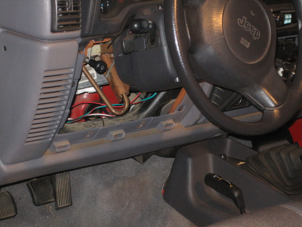

The blend door and actuators are located behind the dashboard. If you're looking at the dash, they're to the left of the AC selector switch and down about 6 inches. You can see them if you stick your head in the floorboard and look up underneath the dash. I removed the plastic knee blocker piece under the steeringwheel and the metal piece beneath that so i could get some more light.
I had seen other posts where guys laid upside down in the driver's seat with their heads in the floor so I tried that for about an hour and almost killed myself. I couldn't fit my arms under the dash so I ended up taking out the driver's seat and I highly recommend going that route. I was intimidated by this prospect at first but it's simple. Mine just had 4 bolts connecting it to the body. Then I had to remove the seatbelt sensor wire from the seat which is just a little plastic clip by the seatbelt which comes right off. Once I was finally able to maneuver, I located the problem.

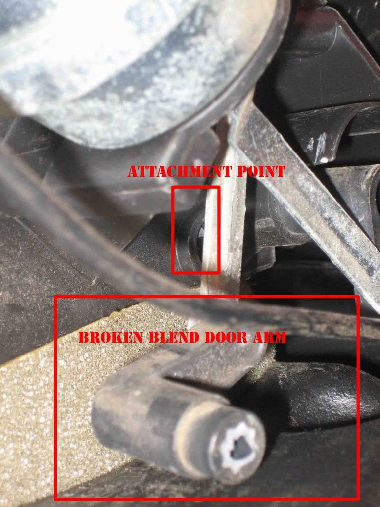

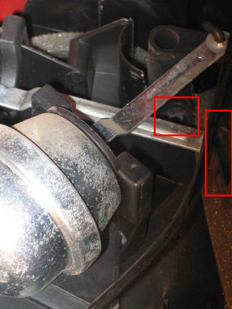

If you look under the dash, the blend door and actuators are a few inches up and to the left (if you're lying upside down). I believe the actuators or diaphragms are 3 round silver ball looking things with silver arms coming out of them. They look like the picture below:
This image has been resized. Click this bar to view the full image.
The arms attach to the blend door and this is where my problem was. The plastic part that connected the silver arm to the blend door had broken and it was very hard to get my hands into that little area. If you have the AC on and move the vent selector between the various positions, you will see the arms move and you can see what position gives you the most access to the area. I found the broken arm and reattached it by getting a 1 inch #10 sheet metal screw from Home Depot. I put it though the hole in the arm and screwed it back in without even worrying about taking the original broken piece out of the blend door because it's hollow anyway. here's what the broken piece looks like and where I reattached it
I think the blend door for the dash vents was the middle of the 3 actuators. I ended up having to hold the plastic door attachment piece in place with my left hand and taking the screwdriver in my right hand through the removed knee blocker I referenced earlier.

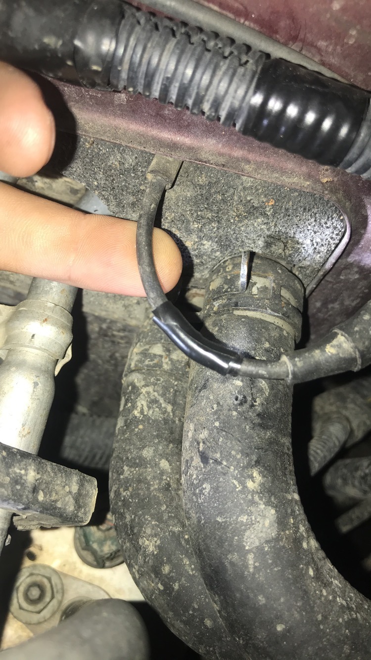

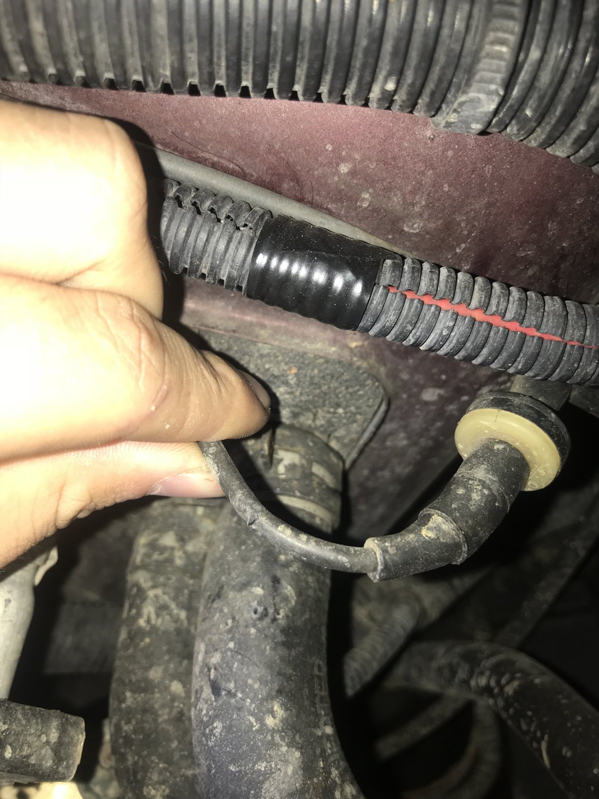

Just like everyone else has probably already said, I had this exact same problem for about a month now. I looked at the AC vacuum lines, I checked the canister, I checked the actuator arm but nothing. Well a month later (right now) I decided to take a second look at the vacuum hose. This time I started from the engine and followed the hose to the battery side, looking for holes. As I was following it, I would twist and bend the hose looking for hidden cracks. Low and behold, I finally found my crack. Clear as day. Mine was at the little “T” just in front of the fire wall where the coolant lines go into the heater core. A little electrical tape fixed the problem instantly. I have already ordered a new hose. It’ll be here Monday. But just a heads up, check your vacuum hose THOROUGHLY.
I recently put tube fenders, and now that I think about it, around that time my A/C quit blowing as hard. Most likely I cut a vacuum line yea?
It’s worth a look. Take a bright light and follow the vacuum line, twisting and moving it around. Cracks like to hide and you can’t always see them unless you move them. I completely looked over mine until I took a second look.

This is the EXACT spot I had a crack in mine. electrical tape and heat shrink wrap solved the issue. Anyone know the replacement part and how to replace it? Looks like the hose goes through the firewall?

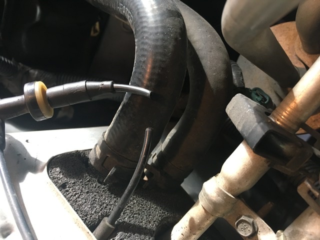

As you can see, mine is completely broken. Does the end towards the firewall pull off? I’ve given it a gentle tug but want to be sure before I try harder.
Go to your local auto parts store and get a 12" length of rubber vacuum line and attach to each end of the plastic vacuum line. If needed cut the rubber line shorter to make a clean bend in the line.
I tried with some that’s 2” in length and none of them fit, unfortunately.
