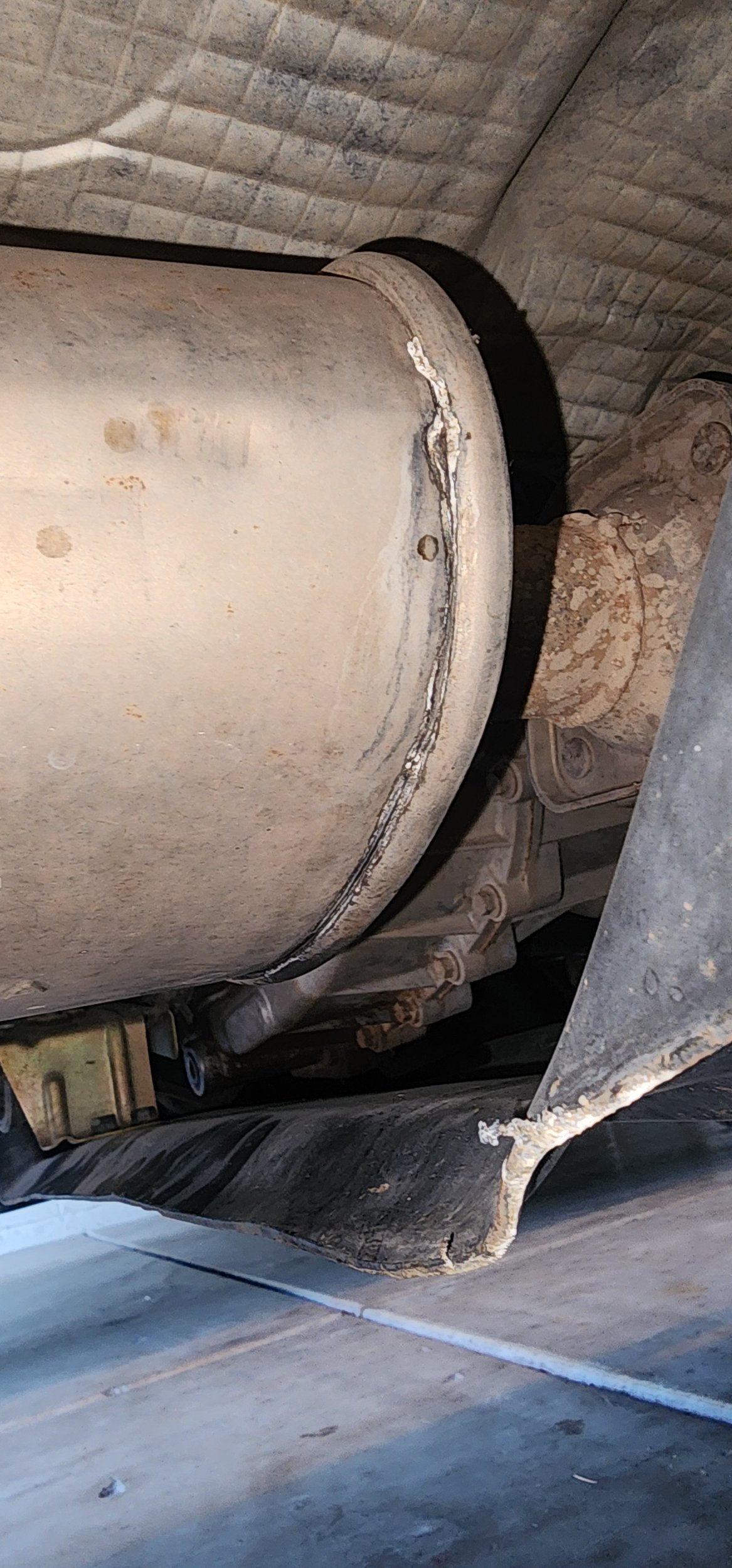

The probing with the scope revealed a hole in the side of my muffler, but i held the probe directly on this hole and only heard the low hum that can be heard in the background of the OP video.

I was hoping it was a blown cat. When I was listening around i checked the front two near the engine and the third, but wasn't able to definitively find the source. The noise is most noticeable after the engine has been running for a bit which makes me wonder if it is media from the cat that went bad, and starts to rattle after warmup. Many have said the cats can fail around the 70-80k mark from what i have been reading.
That combined with the new trans mount makes me think the issue isn't internal to the drivetrain and it can be isolated to the trans mount, the mount bracket, or some exhaust racket.
