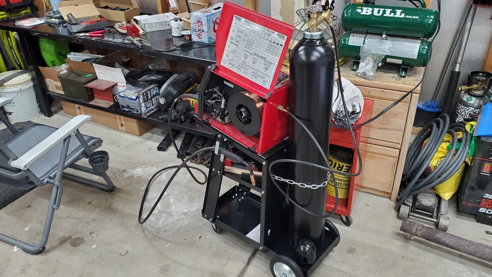

Following. I have a small Lincoln Weld Pak which uses 120V. It didn't take long to figure out I am pretty much limited to 5/32" steel. The welder is able to use flux-core which would help with some of the thicker stuff, maybe up to 1/4"? I haven't tried the flux core though. I've been casually looking for a 240 machine. Likely a Hobart or another Lincoln.

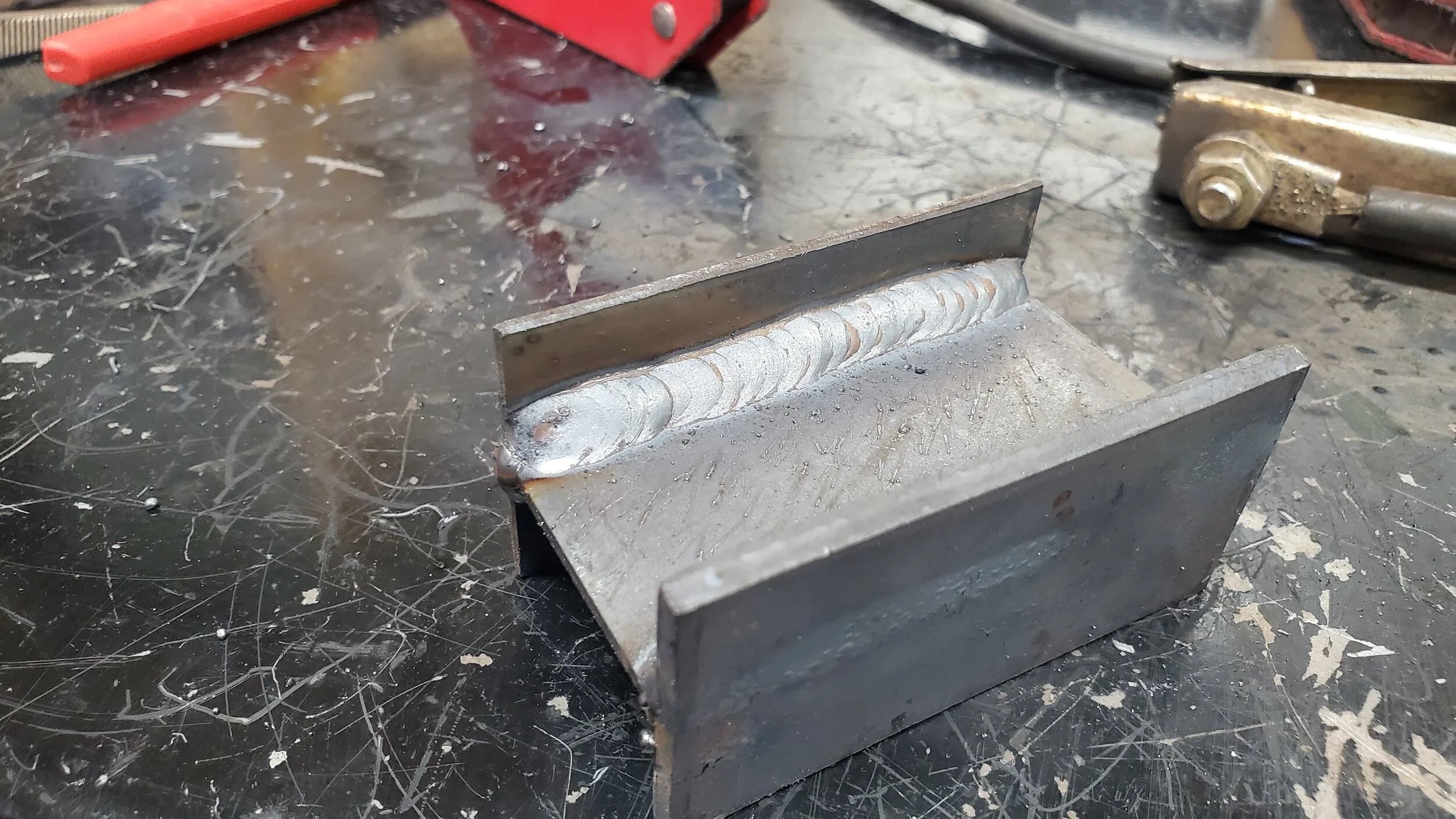

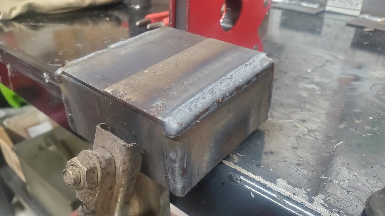

Its fun, but I need to practice more. I probably turn it on every few months and weld a coupons together. I've also been trying to pick up scrap where I can find it. This has been my best weld (I think), but it was also 7 months ago😅
Since you're playing with coupons, do you ever test them or cut them apart?
I've placed them in a vice and tried to bend the piece with a pair of channel locks. My table isn't secured to the floor so I ended up just moving the table. I haven't cut anything. I really should though.

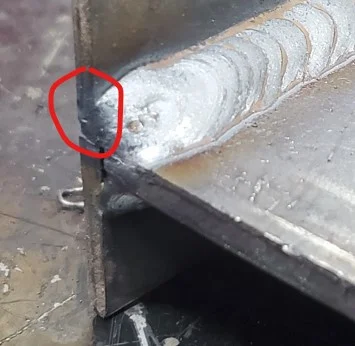

This is a close up of another weld. It looks like good penetration (at least to me), but you can still see a gap between the two pieces, so there is no material filling that void. My guess is if it wasn't welded on both sides, that this would have broken apart easily.
I think you need more heat with that one. It looks like you didn't get into the base. Let's see what the other more experienced guys say.
Your welds actually look pretty good. you have good fusion where the weld touches the base metal and the profile is smooth. It's difficult to tell from this angle whether or not you have good penetration or not. I would need a picture facing the edges of the coupons to make a better assessment

I think it was this piece...
You can read your penetration on the bottom plate in the pic, started on the cold side then a third of the way the heat is building. How's you wire speed set.
It's a lincoln. So Volts are on setting D and wire speed is 8.5/9. I dont know what that is exactly for ipm
