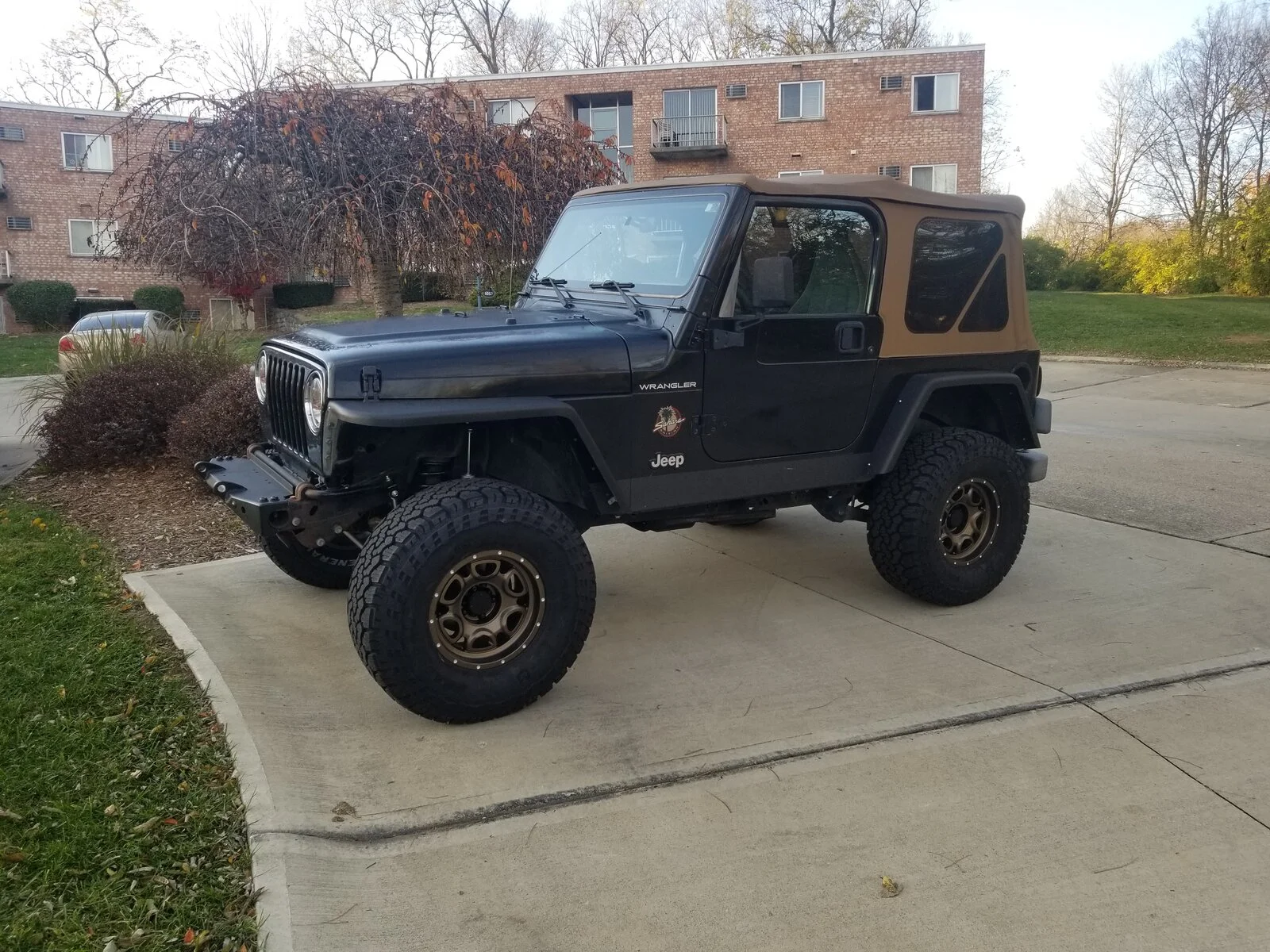

I have MCE 4.5, and I like them. Easy install, just have to get a can of touch up paint for the side of your grill.
Motobuilt is 30% off for black friday and I believe they make a 4 inch flat fender. That being said I don't know much about them, just saw it in my email box haha

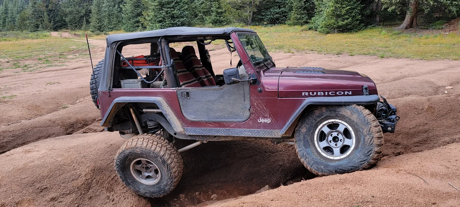

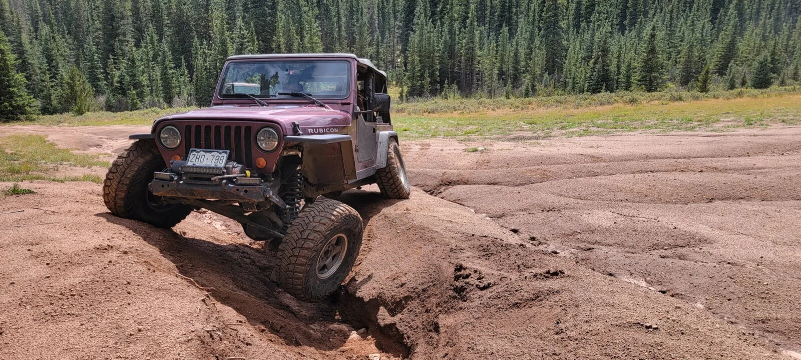

Is there much practical benefit to the rear MCEs (or any other replacement fenders) or is it just about aesthetics?
They are designed to detach if caught on a rock or tree. They will also fall off on the highway. But that is fixed by adding a small washer to the tops of mounting posts to make them a bit more difficult to pull free.
