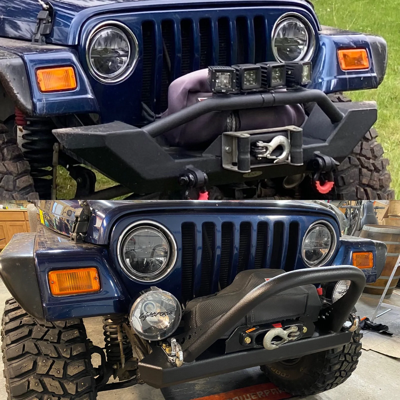

I literally just finished swapping a steel Smittybilt out for a GenRight full aluminum. It saved nearly 40 pounds and I gained almost a full inch of ground clearance on the front. I tried for Savvy but after 6 weeks of waiting and continuous delays I bought the GenRight. I’d argue that Savvynis the best, the GenRight is very nice and FULL aluminum instead of the steel winch guard on the Savvy.

Maybe if one could actually get a Savvy without waiting for months and them telling you weeks I could see if it’s the “crown jewel”. I will say that this GenRight I picked up is a VERY NICE piece of worksmanship and being FULL aluminum u like the Savvy it is no doubt lighter.
