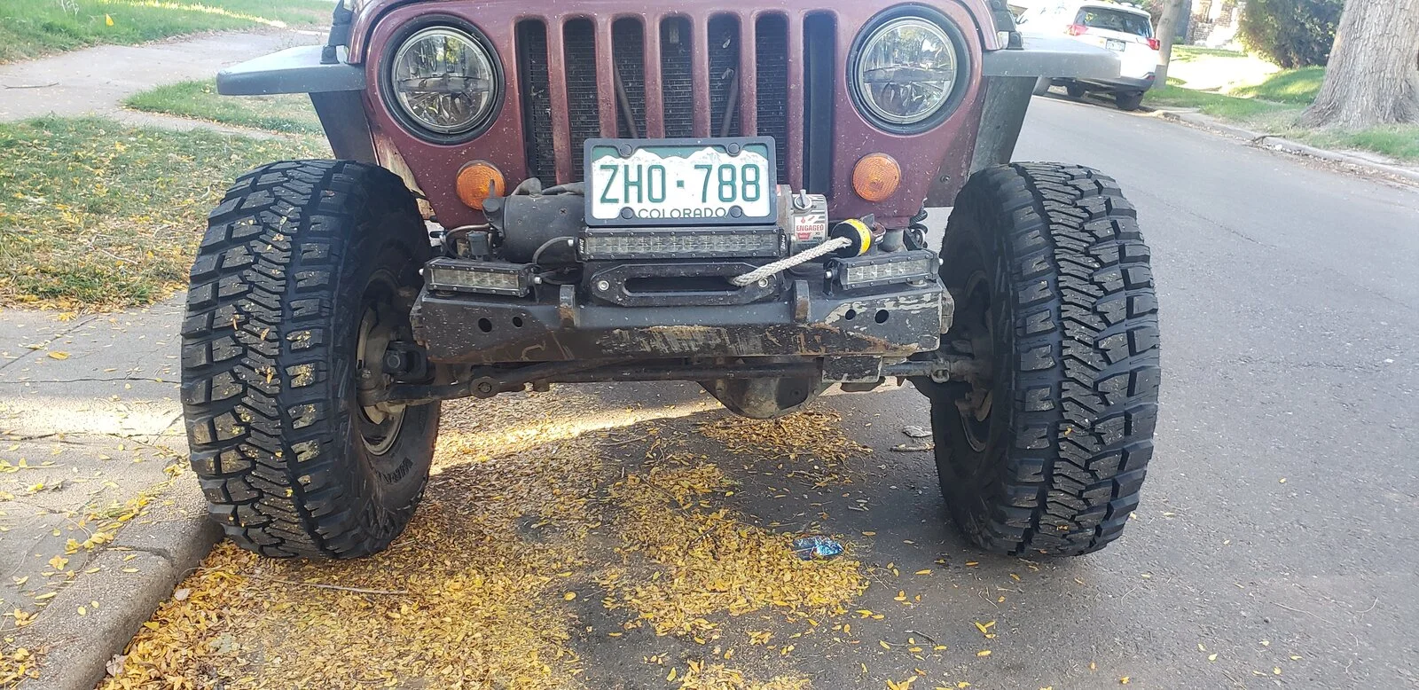

Didn’t you add extra Frame mounts to duplicate what savvy offers?
Every frame hole I could. The winch deck is extended and the winch sits against the grill. The bottom lip is extended up to contact the crossmember so it can't collapse. Lights are mounted close and tight to everything else. A keeper holds the thimble away from danger.

I would encourage the Savvy over what I did to mine. It's a lot of work. And the extra lights, license plate, thimble keeper were all done that way just because I could weld it. Most can be done similarly on the Savvy and what can't, I could easily live without to have less weight.
