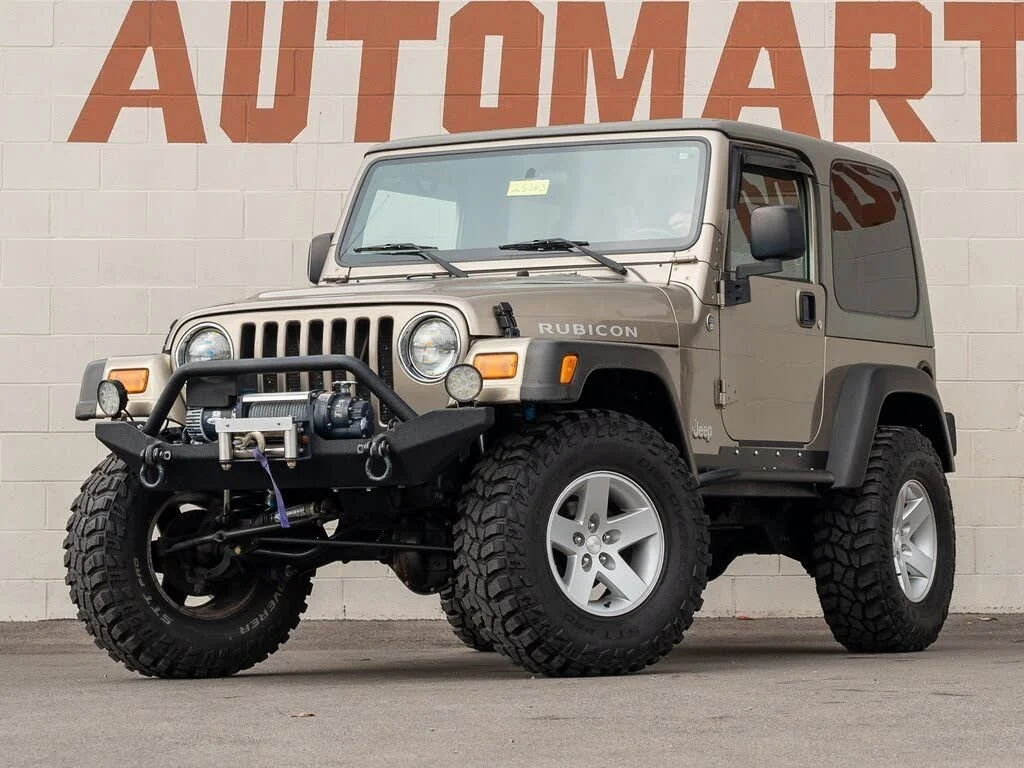

So I recently bought myself a nice (interior and exterior) looking 2005 Rubicon TJ. I had it checked at a shop and they told me a few small things but said the suspension and motor and all the important parts were great. No rust at all, no damage, great CarFax, and only 40K miles. It had a crappy steering problem and I knew that most of them can be fixed fairly easily. I took it in to the shop that was recommended to me in town that is known for Jeep work. They have a great reputation and seemed really nice, and I don’t have anything bad to say about the experience…. BUT, the rubicon was certainly in WAY worse shape suspension wise than I thought it was.
I am going to post the estimate for work here, and am looking for some advice. I don’t have the garage or tools or (mostly) time to do this work myself, but does this seem legit? It is all skyjacker parts which I am a little scared of as I read such bad reviews on that stuff. Any advice would be great here… not sure if I should just bit the bullet and go all out with a better or long arm lift and 35’s (needs new tires too). The money isn’t necessarily the big problem, although it seems excessive to me, but more looking for input on if there is something jumping off the page at you guys.

No chance in hell I'd pay anywhere close to that. Skyjacker is garbage as well, so that's a big red flag.
All of that stuff is easy to do yourself if you have decent mechanic skills. You could also do it for probably half the cost.

What's it regeared to? I would never pay that for Skycrapper parts. I'd bring it back to stock before I would spend that much.

There are far better components out there.
Those control arms are horrible, your better off keeping the stock versions. The clevite on one end with whatever other joint they use will start snapping control mounts if you wheel at all.
Dual stabilizers aren't needed--stick with a $25 monroe version.
The JKS disconnects are fine--though there are better options available. The JKS track bars are ok--but again, there are better options available. Specifically ones that fit and dont interfere with the diff cover.
NAPA brakes--what size tire do you want to run?

These clowns aren't just trying to con you, they want you buried. It also seems like they have no idea what's causing the problem and they just want to fire off a parts cannon.
I kind of felt the same way, but they are very well respected in the jeep community here… so I am told. I am thinking of getting a “second opinion”.

Listen to Chris and find somebody to do the work that will do it the way it needs to be done even if you have to stay on here for days to get an idea-
It’s going to need probably a little bit more than they think and you don’t need to spend too much to start with-
Unless it was wheeled hard you may just need some things torqued down And some new sway bar and control arm bushings
I’ve got a 2004 Rubi that I have gone through it front back and will not spend close to that including some bed tred and in a winch- You will not find a better place to get the information you need than here
