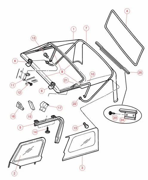

So i am going to put my soft top on this weekend, but i think it might be missing these screws:
#s 23 and 13.
Does anyone know what size those are? Can i get them at a local auto parts?

#13 is Mopar 6036311AA Soft Top Shoulder Screw
#23 I dont know the exact size but its just a small Philips sheet metal screw about a 1/2 inch long (it holds the metal bracket to the body)
Reactions: JonTX
Before I spent $20.88 for four 10-24 Shoulder Screws, I'd be looking at places like ACE Hardware or maybe even somewhere online.
I'd guess the #23 screws are #8 sheet metal screws. The #8 being the size of the screw, not anything to do with the #8 from the drawing posted.

I was missing one screw, (23)they're correct it just a small sheet metal screw. I happened to find one in my bag of random bolts I keep around. I would take one with you to your local hardware store and match it that way.

I know this is an old thread, but I need number 12, number 13, and number 23 from the diagram. Someone mentioned that one of them is a number eight drywall screws. What are the others? Can I just get them from the hardware store. Need them today.
Drywall screws are no good you need "Self Tappers"
