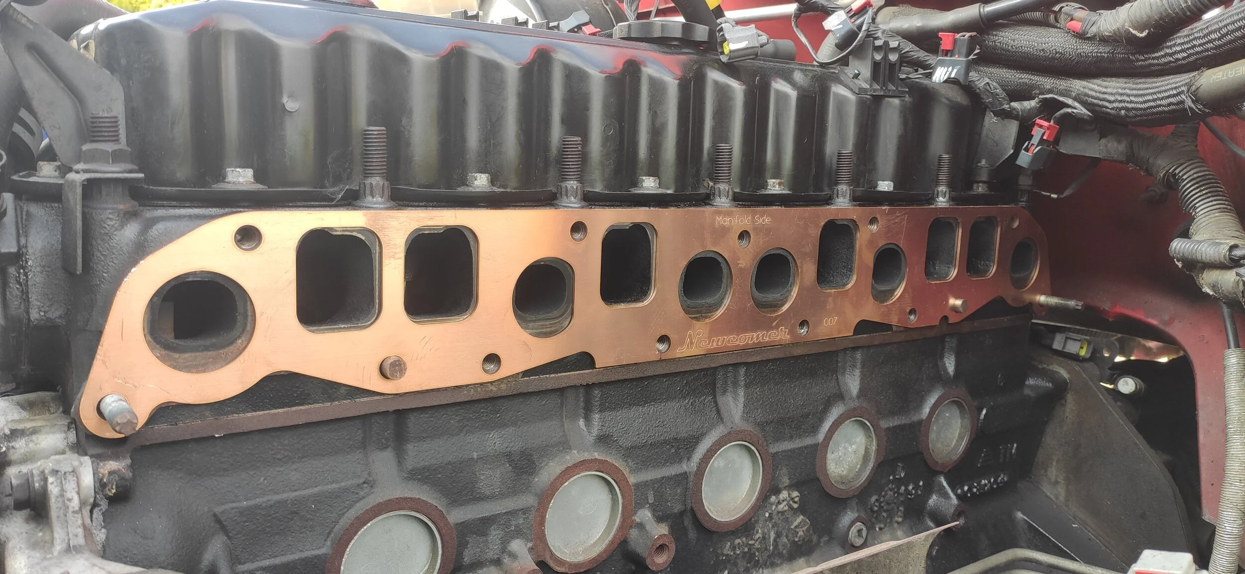

To be 100% certain the gasket I ordered wasn't an issue too, I bought a copper gasket from NewComer Racing, which fitted the block like a glove.
Had the machine shop use the copper gasket as a template and they re-drilled the holes on the headers.
Perfect!

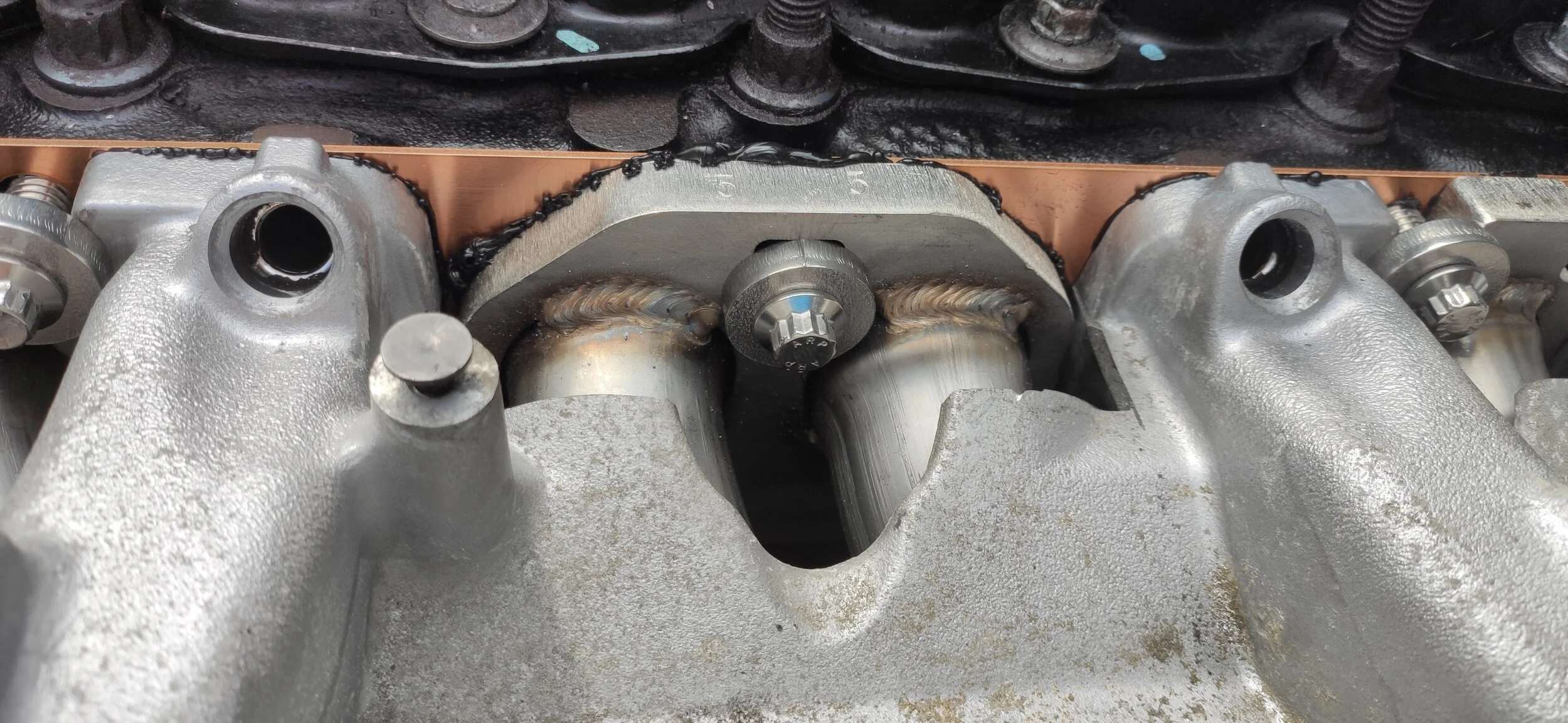

Onto the next issue, the stock inlet manifold didn't fit.
I ended up taking a angle grinder to the inlet manifold in a couple of places...
