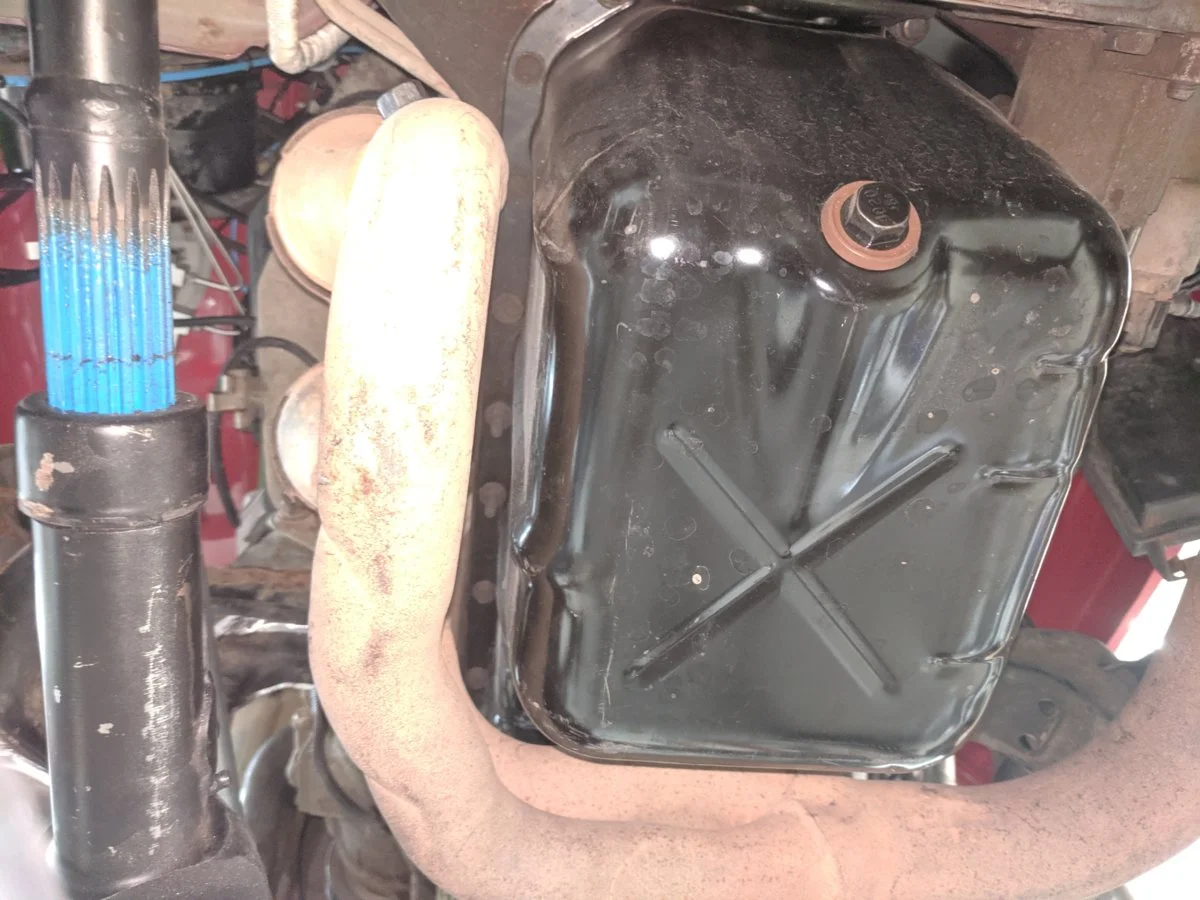

Would you mind taking pictures of these angles?
Reactions: Powdermonkey
Good to see they’re in production. Hopefully with the pic around the oil pan we can get a better idea of the chance of it fitting.

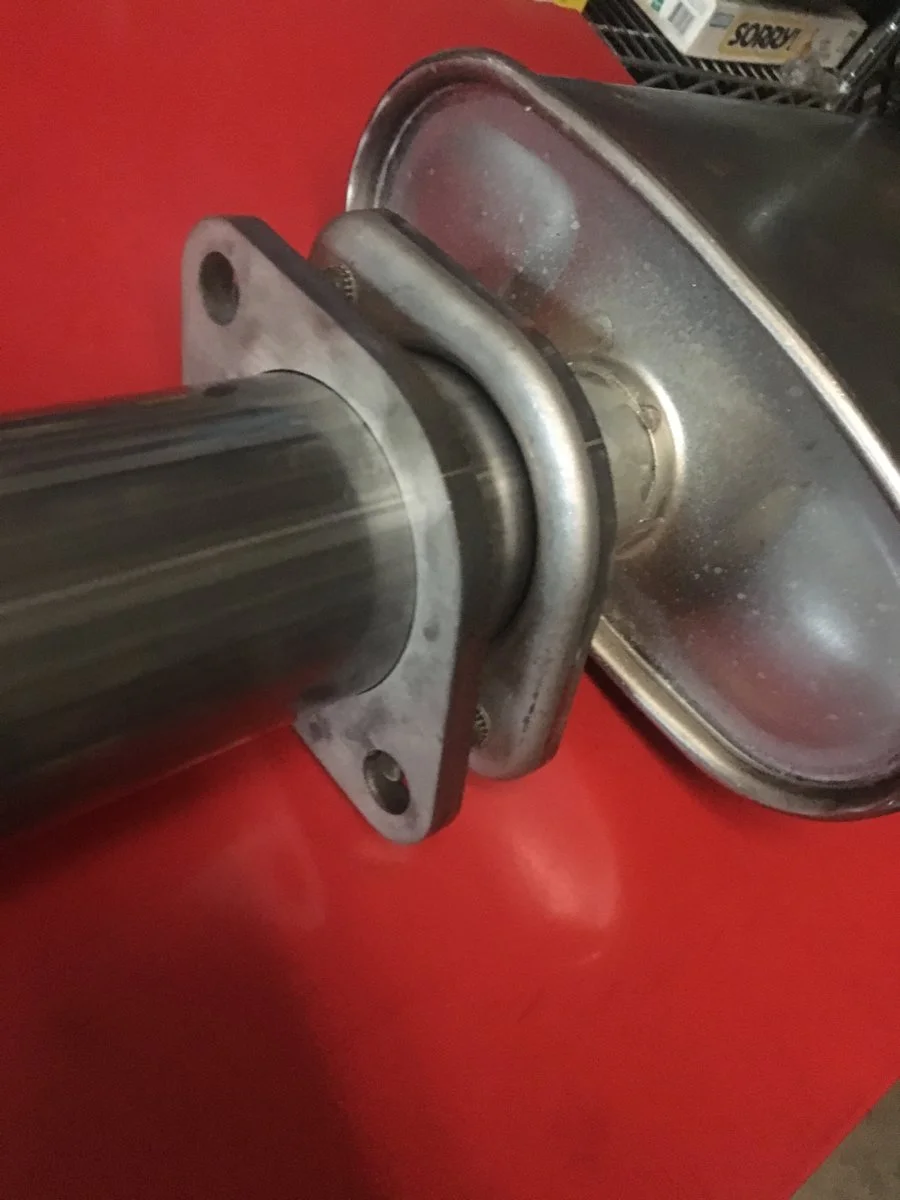

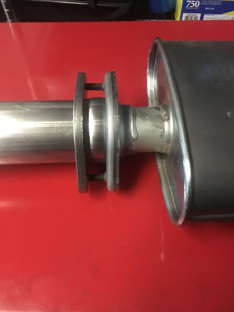

ow. ANYONE KNOW IF THIS IS SUPPOSE TO connect LIKE THIS AND YOU USE A LONG BOLT AND NUT TO HOLD IT? this oem muffler WALKER 21456. I dont think it is gonna work, maaybe im wrong ? im going to definitley call tomorrow to see what they say because it gonna work with the bolts pryed in

No you shouldn't. Are the mating surfaces the same style flare?
@toximus I ended calling them spoke to "Sal" , telling me that i need to jest get new hardware and his own tip adding that I should apply red temp high rtv around the flange. Sal is a super great guy and knows his shit.

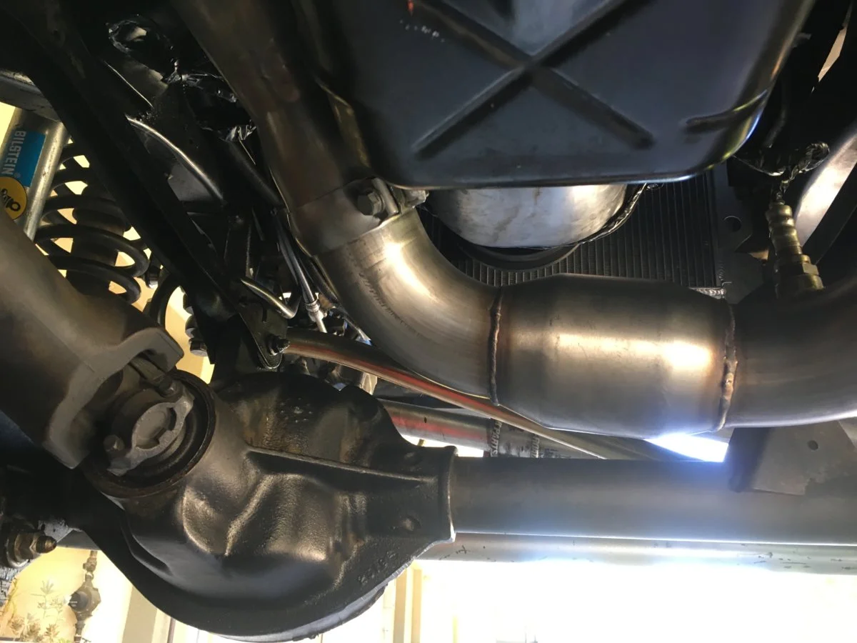

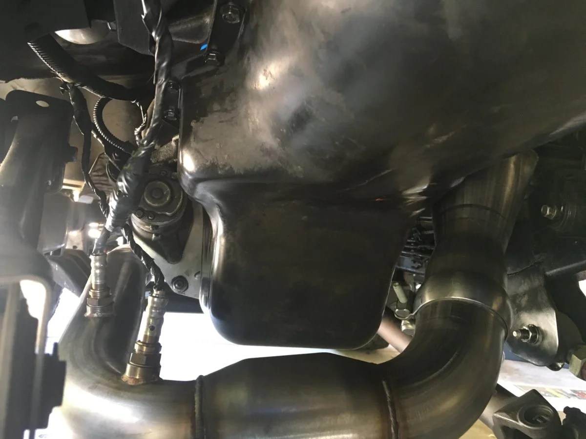

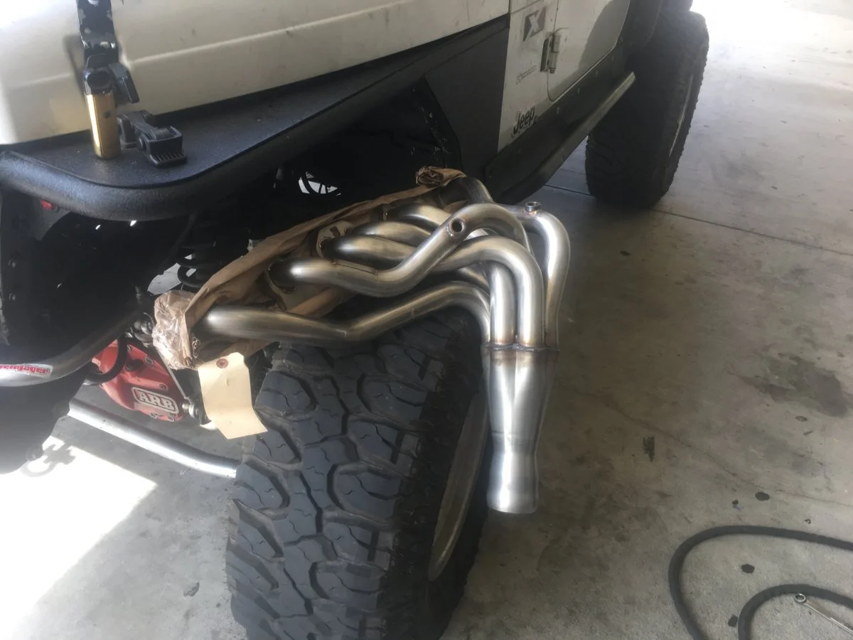

But anyways, I havent installed the muffler, however; I did finish doing the most annoying job ever ....I had to extended the two downstream o2 sensors which took sooo long as I clamped all 16 ends ....making sure everything is in ... I turned cranked it up sounds crazy as fuck without the muffler super loud!!!!!!!!!!!!! it was poping . I had to turn it off and wait till tomorrow for the hardware shop to open to get the correct bolts to attach the muffler. Here are the photos you were asking for .
^^^^^^^^^^Fyi when i was installing the two lower pieces here i was holding up as close as possible to the transimmsion idk if thats correct ?? I just want it to run higher up ... should i re adjust it ? What do you guys think will it cause to over heat????? the transmisson possibly????

Thanks for those picture. Based on those, I don't think this could work for me. I wonder why they didn't put a tighter bend around the pan?

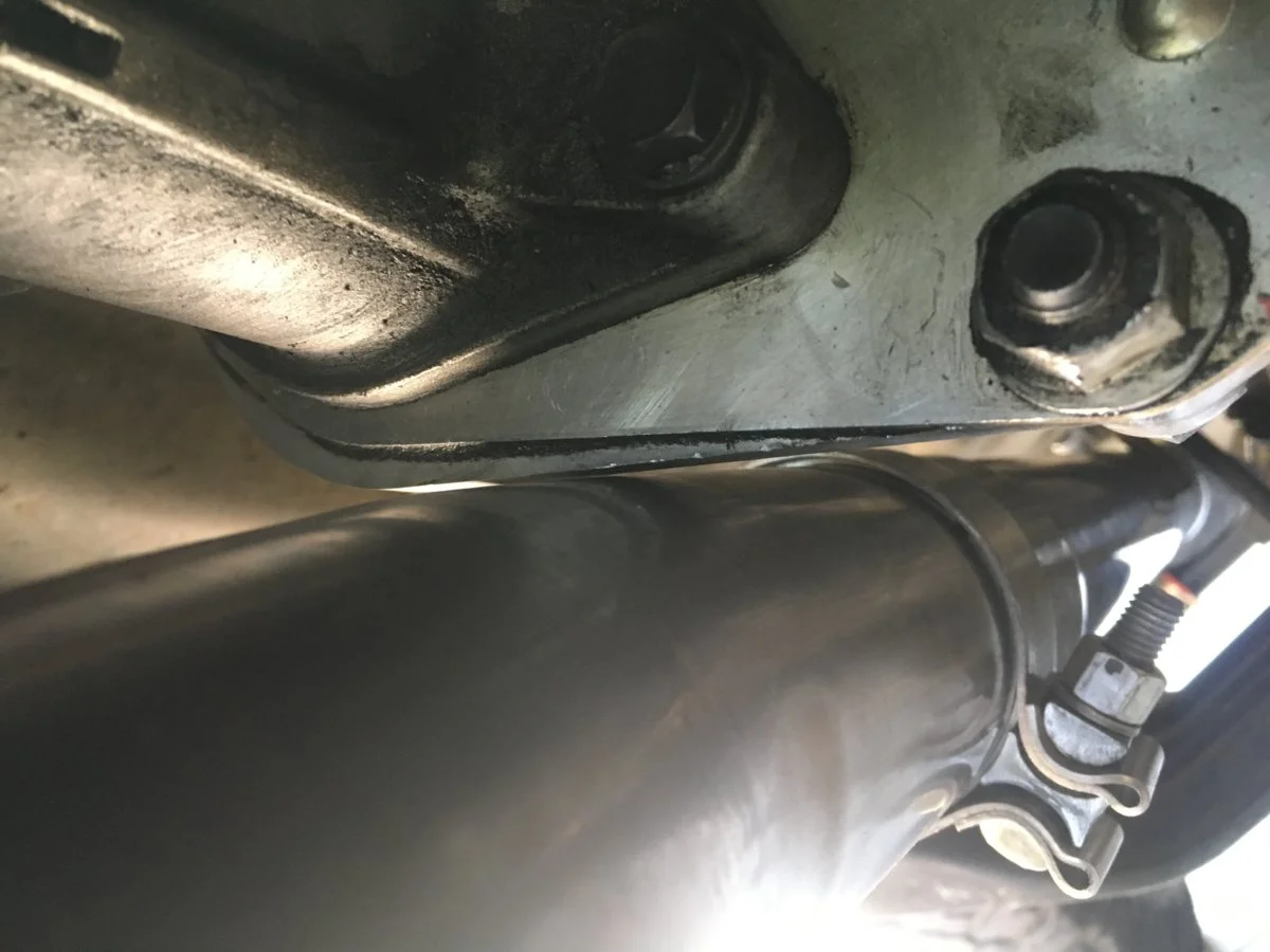

If it's touching, I would bring it back down.
Looks like you wouldn't want to run them on a rock crawler though. From the photos it looks like low hanging fruit but maybe it's an optical illusion.
I can retake better pics from a diffrent angle , although there is a gap .. it doesnt seem that low... although for rock crawling it would be tough say unless you have a higher lift. I only have a 2 inch lift
I'm pretty sure it could work .. if you maybe ask them ? they make a shit ton of headers and its like 3 pieces that third piece is only tubing its not anything special ... mine just has a cat maybe thats why
