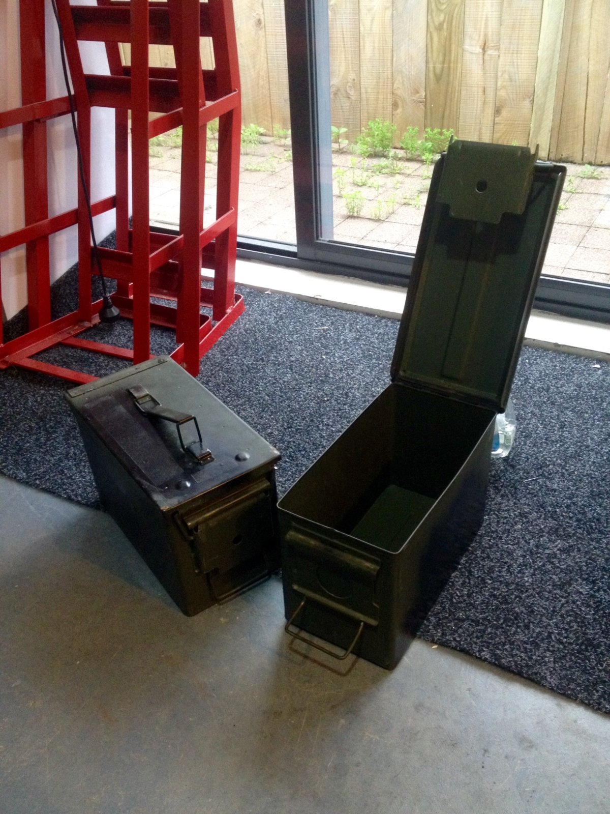

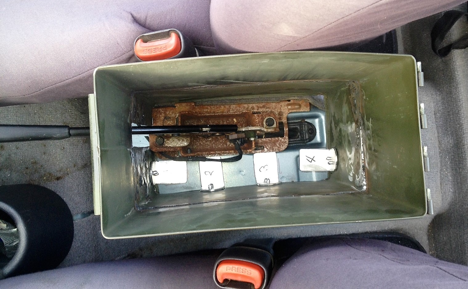

Start off with 2 50 cal ammo boxes....( Fat 50 cal boxes would be better as they are wider (but rare down here)

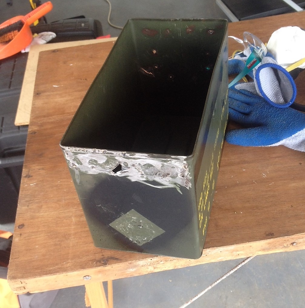

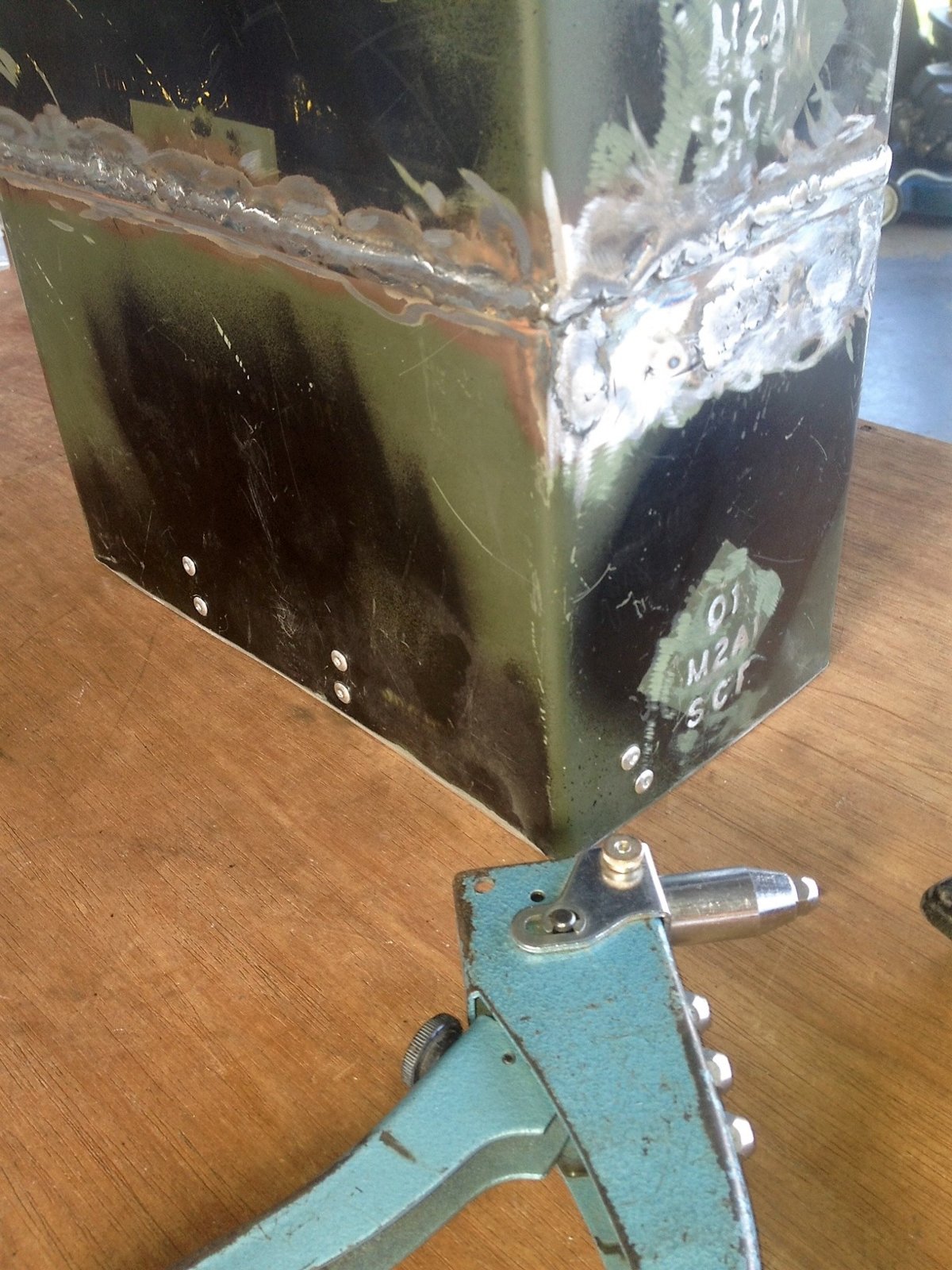

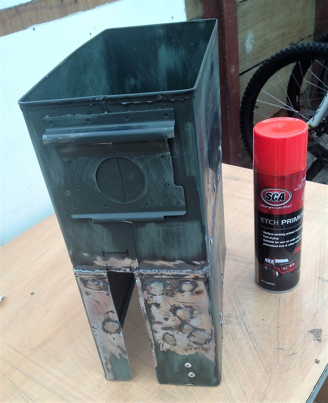

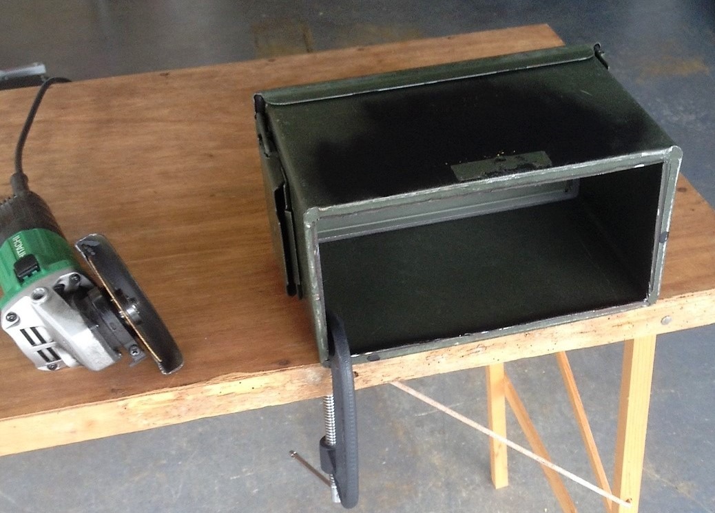

Cut the bottoms out of both and shave the handles too and weld together and of course grind down the welds.

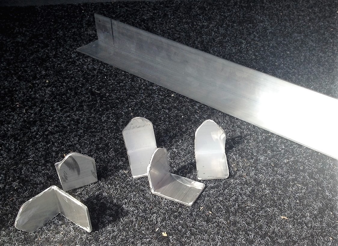

I then made 4 brackets out of some L shaped aluminum I had laying around.

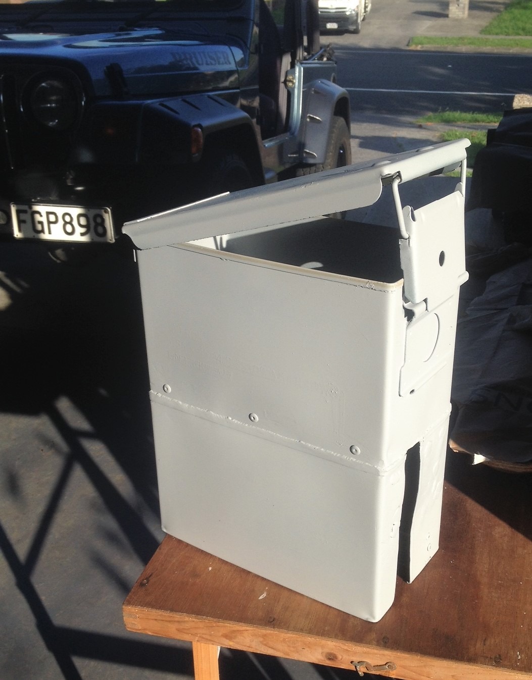

I rivetted those to the bottom of the stacked boxes making sure they will clear the handbrake bracket between the seats.

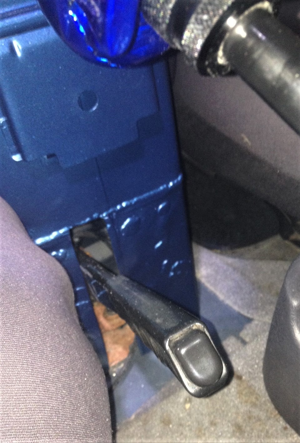

I measured how high the handbreak came up and cut a slot adding another inch to be safe.

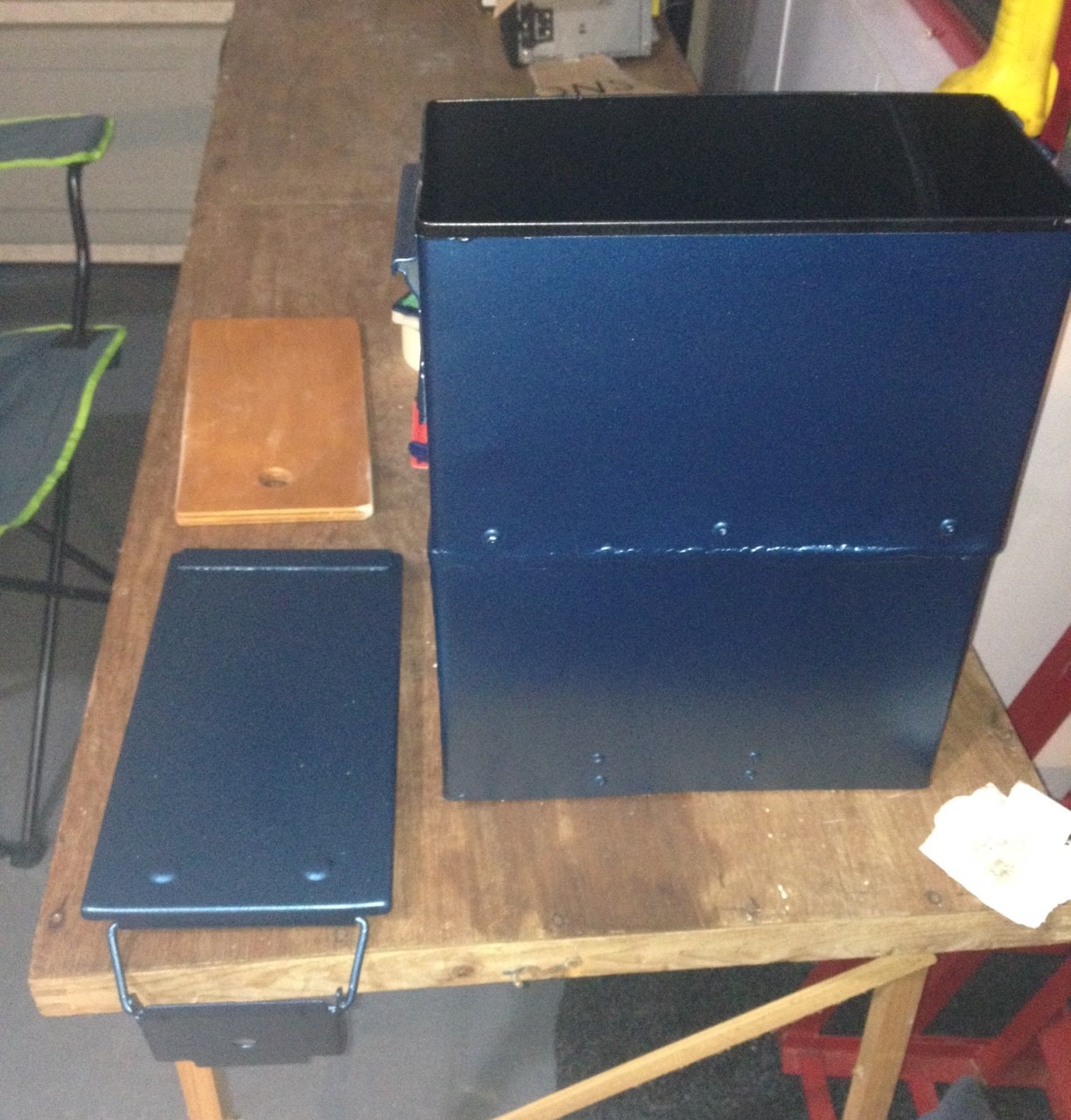

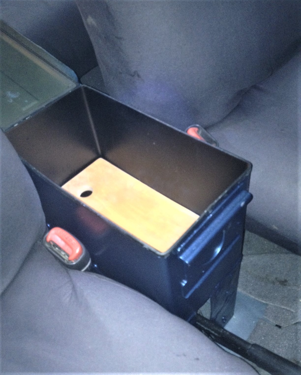

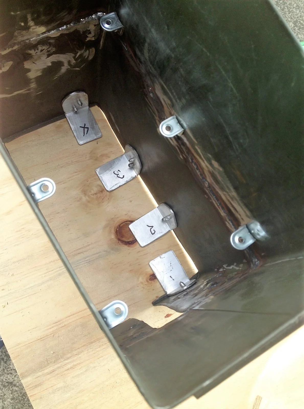

Found some smaller brackets and riveted 6 of those to make a shelf

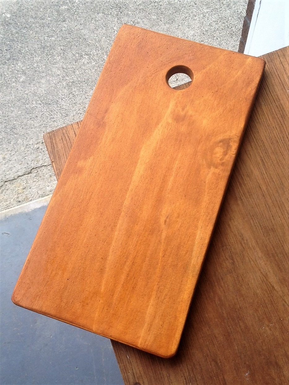

Grabbed some old plywood measured and trimmed down to fit inside followed by a stain.(Made a hole on the top so I can take it out if I need to get to the handbrake below)

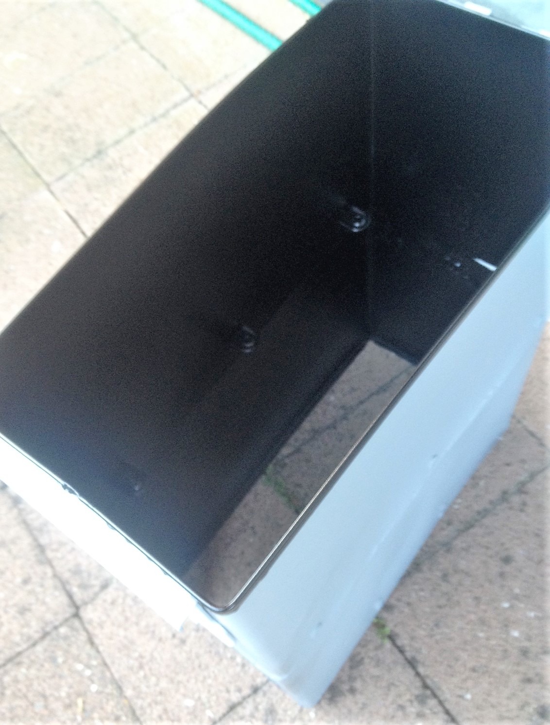

Next came the etch primer (2 coats) and a primer filler after that.....masked off the inside and rattled canned satin black.

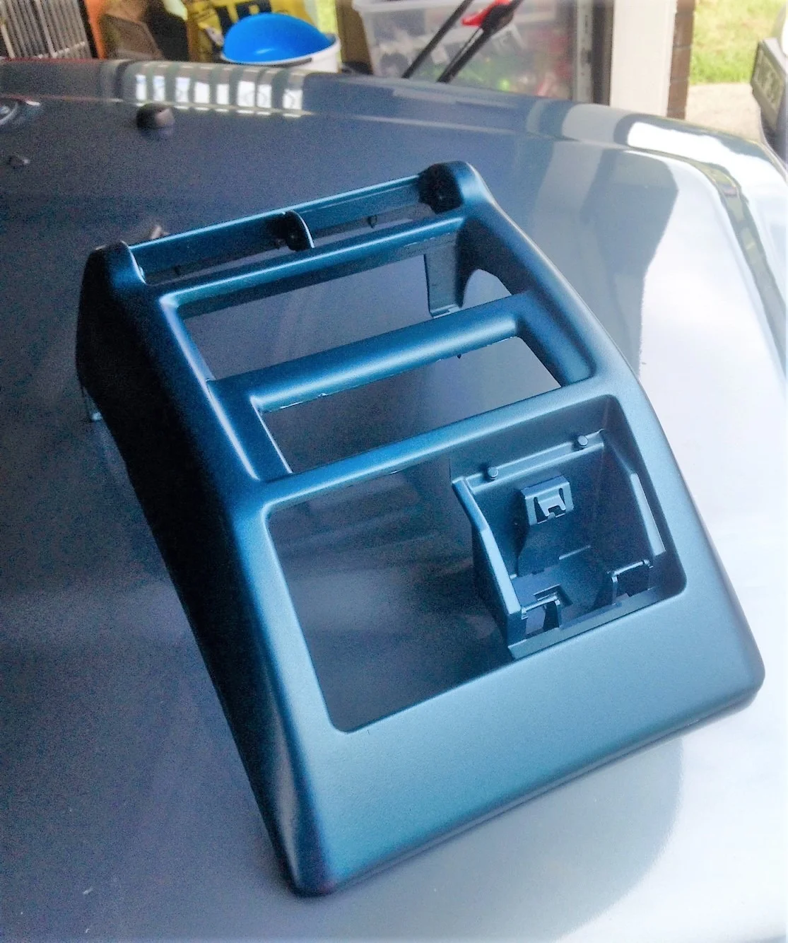

I had my local auto parts store make up 2 cans of Chrysler blue paint doesn't quite match the Jeep steel blue but close enough. Painted the box and dash console again to make sure at least they matched.

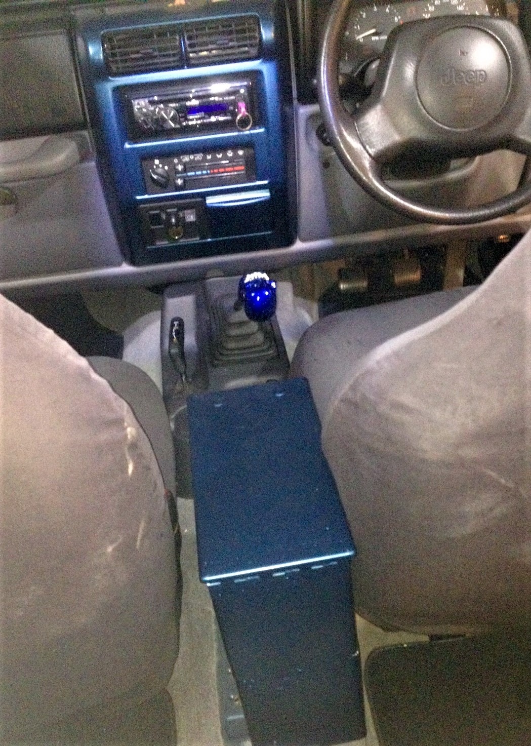

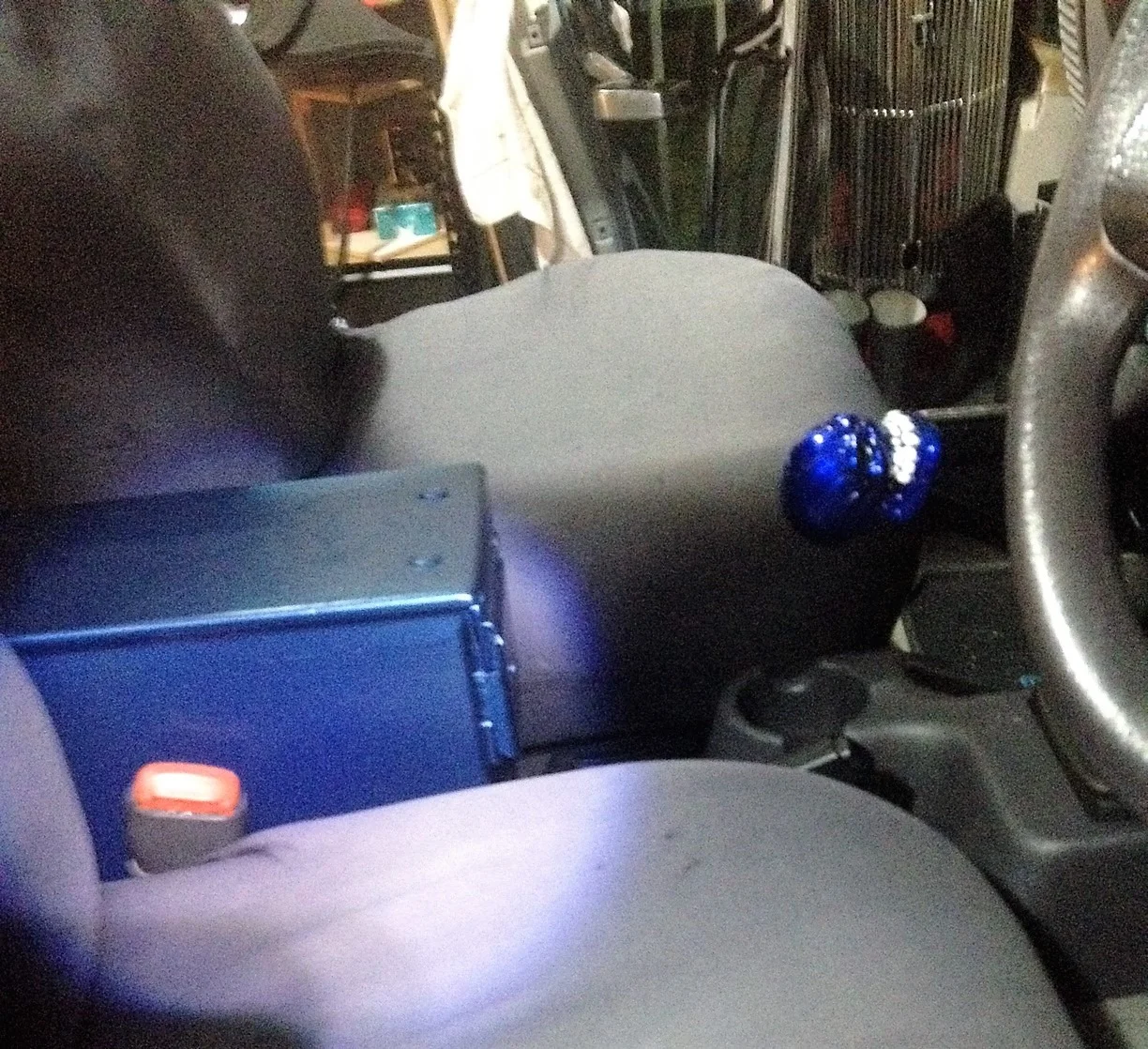

Assembled the box and fixed it in place …(will eventually bolt it down properly using rivet nuts, so I can take it out for touch ups and fixing the handbrake if needed)
Will probably tweak things as I need them (like being able to lock it etc)
