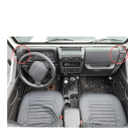

Hey, so I have 1999 TJ and lately I've been hearing this noise, like something rolling left and right behind the dash or air vents (it occurs on both sides) Usually over bumps and uneven roads it happens 100% and annoys the heck out of me. Has anyone else experienced this or have any idea what it could be?
Any help is much appreciated!

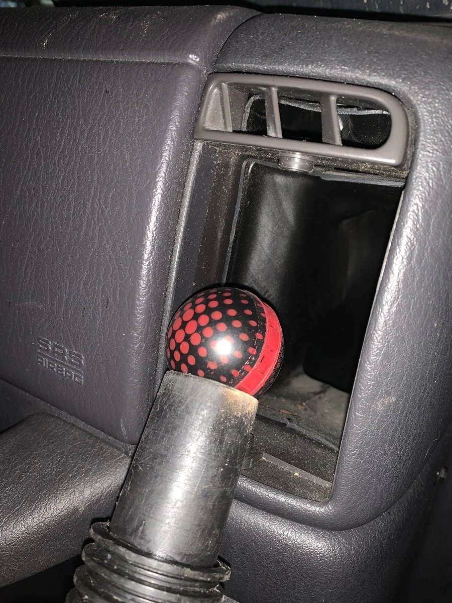

My son flushed a renuzit air freshener down the toilet when he was little , the one about as big as a skoal can ..acted like a flapper .
