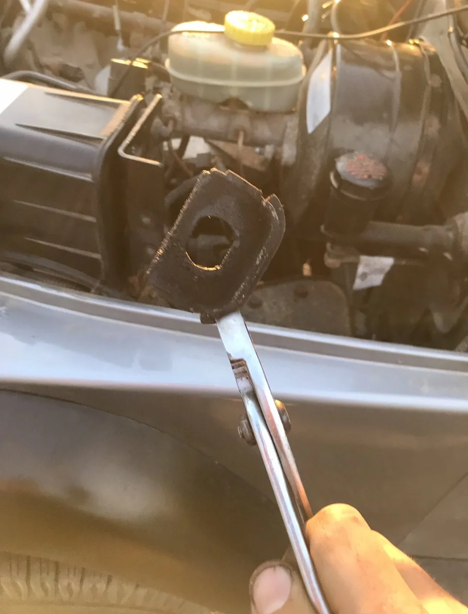

Oh — and BTW to anyone reading — be careful when replacing the CKP, I managed to pull the little slot cover thing it goes into out and drop it in a place I couldn't see. I got spent 20 or 30 minutes trying to figure out why I was able to see into my bell housing and another 10 or 15 messing around with a flashlight trying to find the piece (it was on top of the transmission).
Little piece that the CKP fits into - no word about it in any of the FSMs or the Chilton, but it definitely exists.
