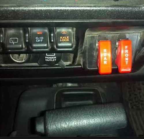

Just out of curiosity, what does the Rubicon do that needs unique PCM programming? I know about the 241 and the air lockers but I didn't know the pcm was involved in that. Locker pumps?
Reactions: Wranglerfix
The PCM controls the locking order sequence and monitors the status of the lockers. It's a needlessly overly complex operation. I completely bypassed it by rewiring my lockers and installing my own locker switches.
The PCM sends power to the 4wd dash light when the t-case is in 4 low. Only then will the locker switches get power to activate the lockers sequentially. In the manual trans versions, the clutch safety switch is bypassed so you can start in gear and there is a different throttle response to make it less touchy in 4 low.
Some of us prefer the rig to function as designed by the OEM. Given the number we've fixed, that is likely the majority. In all the time we've been tinkering, only one has ever had us bypass the PCM functionality. The rest have had us restore it to factory including a few that had the bypass done.
Ah. Yeah I would want all that stuff operating as OEM intended too. I knew about a lot of that behavior, just didn't know it went through the PCM. I didn't know about the throttle response thing; that's pretty cool and now I want to know how it works with a cable throttle. Ignition timing?

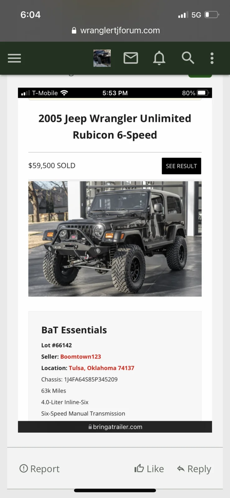

Cussing 2005-2006, Mayor Bransford hit the Wranglerfix button, the panic in Gotham city began to subside. Numerous PCM’s new they would soon be saved.....late model values skyrocketed.
The attached photo is real.
Not saying it was worth it, but it sold for that -
For $59,500.00. Time to sell mine and start over.
Reactions: TheBoogieman
Man I’m tellin ‘ ya- with 2 or 3.
That bidding war got out of hand-
I bet someone woke up with a hangover like Ronald Reagan after a 3 day drunk going - “I sold arms to the who??”
