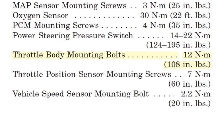

Oof this is no joke ask me how I know... 20 ft lbs, no more!
Actually it's only 9 ft-lbs aka 108 inch-lbs. 20 ft-lbs would probably strip the threads. Use nothing bigger than a 3/8" torque wrench for anything that low. And @Skees
After doing some more thinking I’m going to try and crawl under the truck and look around and see what’s going on. No CEL makes me think that maybe it’s not the TPS and that it must be a vacuum leak somewhere… Thank you for those torque specs @Jerry Bransford i really appreciate that!
Reactions: Jerry Bransford
Yep, not sure why I thought it was 20 ft lbs, thanks for keeping me honest, maybe that's how I ended up in that mess in the first place. 🤔
