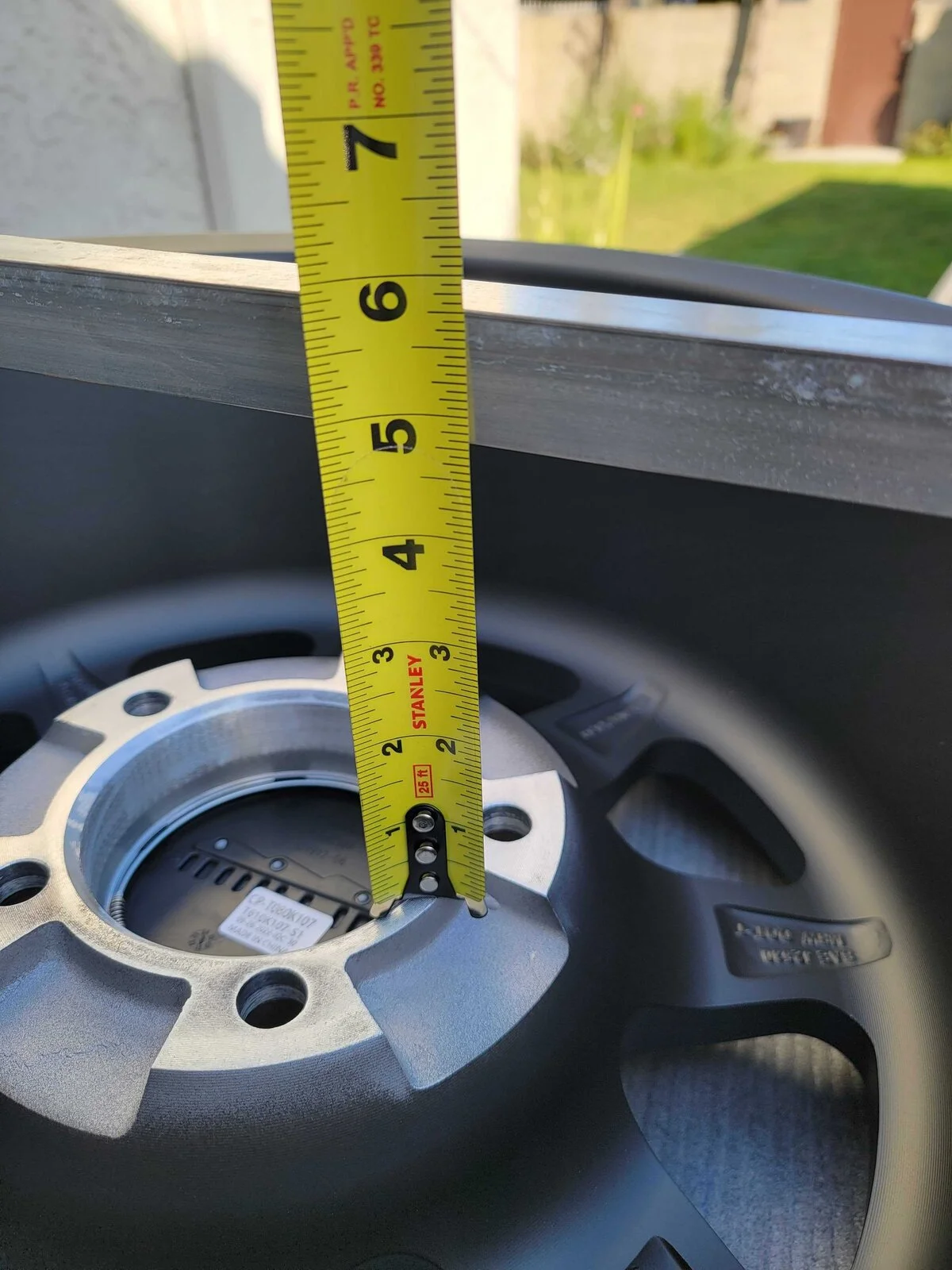

Since I didn't go with beadlocks, I settled for what I thought was a good alternative and went with Method Bead Grip rims, MR701s to be exact.
The problem is they didn't have the right backspacing, so I have a bit too much (4.75) and will probably end up with 1" some wheel spacers.
Here is my spare wheel... waiting for a tire. You can see the ridges inside the wheel where the bead sits. The intent is those provide some extra resistance to the bead slipping off. But as you can also see, it is just over 4.75" to the outer face of the inner lip.
I guess the nice thing about these rims with 1" spacers, if the lugs protrude, the rims have pockets so it won't interfere.
