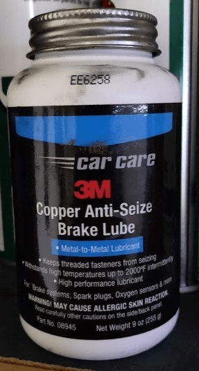

I seem to use a lot of anti-seize on the Jeep. Pretty much any exterior bolt that I don't put lock-tite on I have been using this 3M copper Anti-seize Brake lube on. Anybody see anything wrong with using this on non-brake parts? It seems to do a good job, and other than the copper component just seems to be a high temp anti-seize. I use it because I have it, but was wondering if I should use something different.

Keep using it, not an issue with any fasteners or application.

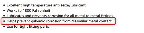

Amazon states that the 3M copper anti-seize prevents galvanic corrosion, but I think to be safe I am going to get some "Marine Grade" zinc based anti-seize and use that on aluminum parts.

The only reason they use zinc for marine applications is because it will be sacrificed before the aluminum in salt water. Same reason it is used for anodes.
