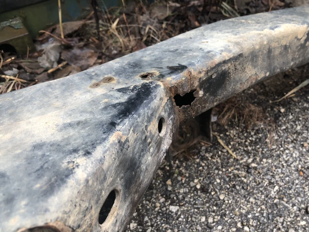

Ok I bought this Jeep a about a month ago for a 2nd vehicle. I should of investigated a little more on how to inspect the frame for rust. I have a ton of scale inside the frame and found this small rust through front driver side on frame were body mounts to it.

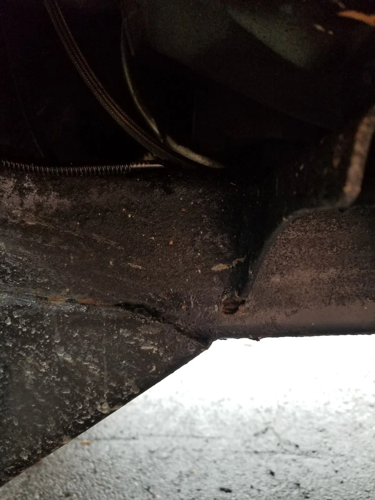

I went around the frame with a small hammer and a screw driver to find more rust through. This was all I found on the frame.
Any suggestions for a remedy I really love this Jeep and would like to keep it repaired for light trail riding in North Ga Mnts.

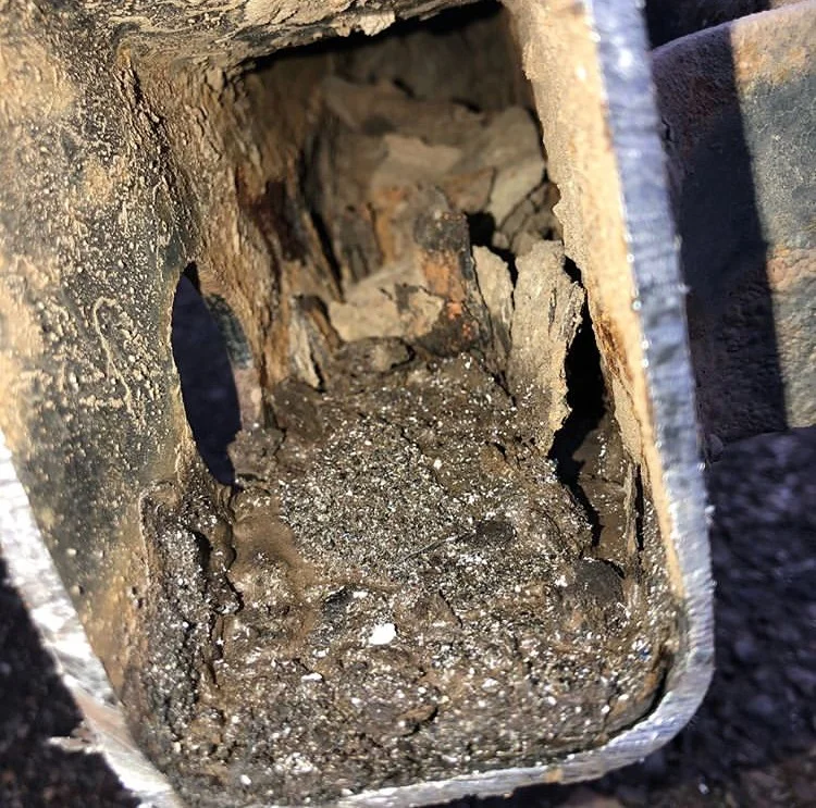

Inside of the frame is shot. Looks very similar to my old frame. You can either weld in repair sections or swap the entire frame. Make sure the body of the Jeep isn't rusted out before you do anything.

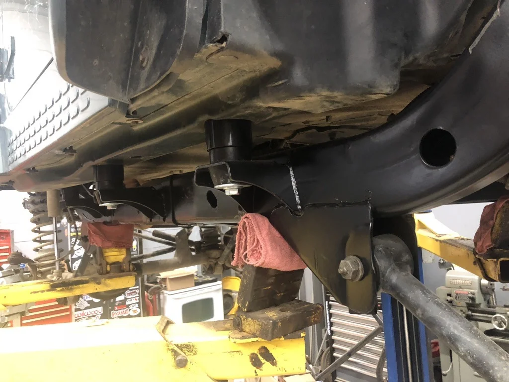

Had a shop swap frames for me. Should be picking it up from them within a few weeks.
Swapping frames doesn't make much sense financially unless you can do all the work yourself. If you were to swap frames yourself, I'd expect $1000 - $1700 to buy a frame. From there you have to decide what you want to replace on the Jeep while you're in there.
Weld in caps are the most popular way to fix frame rust. They will get your Jeep drive-able and will last a fairly long time. I'm personally not a fan of them. I think it is a half-assed way to fix the problem if you plan on keeping the Jeep forever. But that being said many people use them and have no issues.

I used Safe T Caps for my TJ. I don't think it was half-assed; it was a realistic solution. If the entire frame is rusted, then, yes, a frame swap is the logical option. But a frame swap is time-intensive and expensive and simply not realistic for many people. Moreover, any frame you'll be buying for $1500 is used, and might be rusting in the exact same way as your old frame.
If the frame is otherwise fine except for the classic rot spots, Safe T Caps are a good option that can be permanent as long as the work is done properly. That means grinding and cutting out all—and I mean ALL—rust from the frame before welding the caps on. If done improperly, then it is certainly is a half-assed solution.
