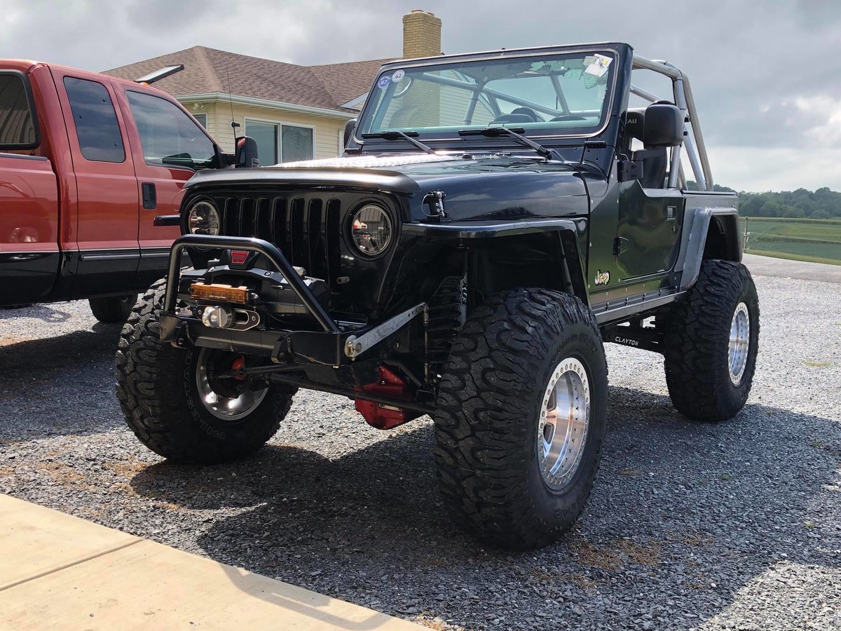

I have the steel version of the ultra clearance front bumper, and added my own hoop. overall a very well made steel bumper, I would assume the aluminum one would be just as nice.
If I go aluminum, I stick with Savvy however.

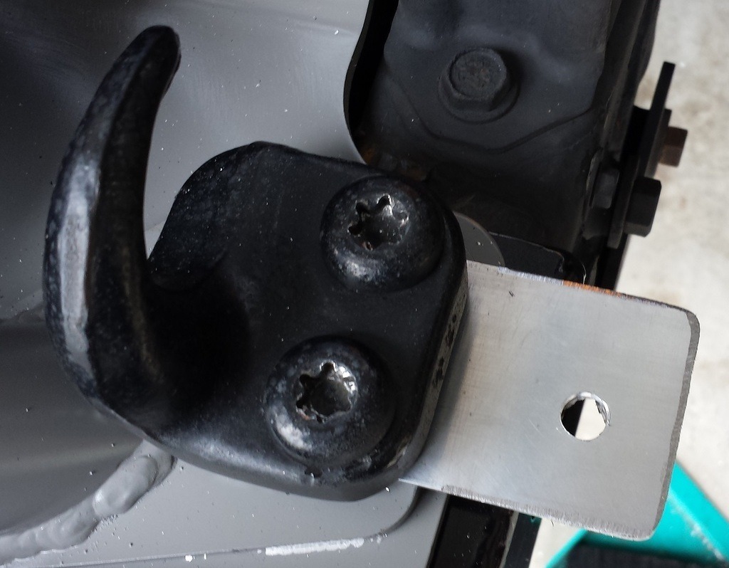

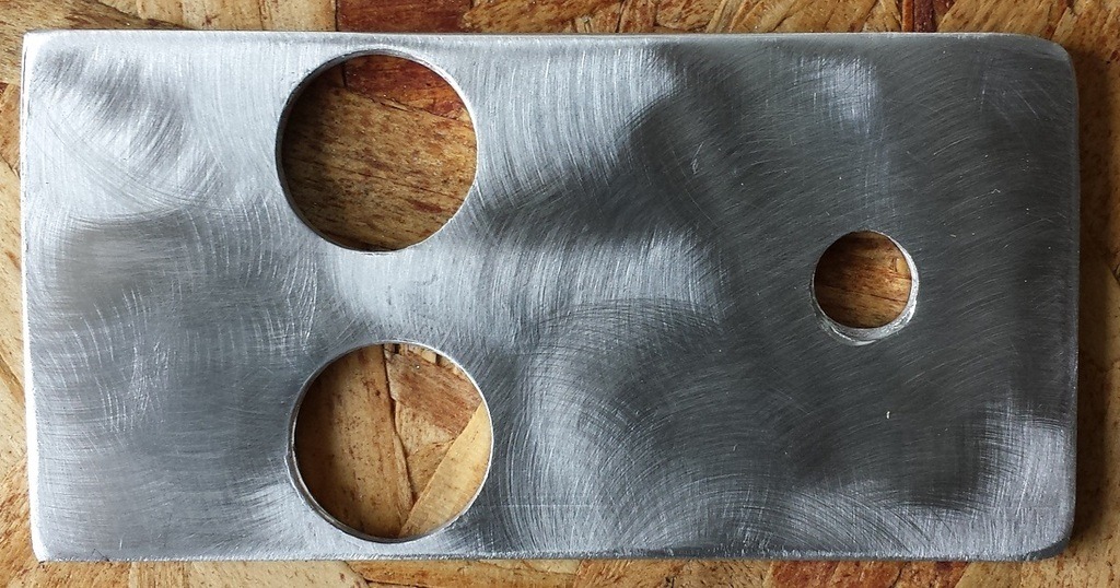

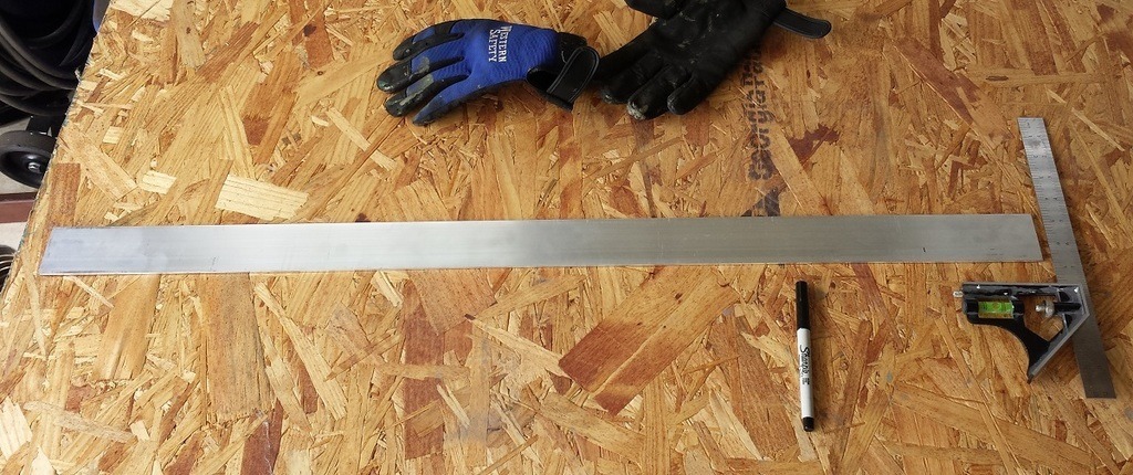

@Irun sorry to bump an old thread but how are your fog/running lights mounted there? Did you use custom tabs or something?
I went to Lowes and picked up a short piece of 2" aluminum bar. I cut it down to a short piece, rounded off the edges, drilled three holes (Two for the bumper bolts and one for the fog light), then painted and installed it.
Thanks that's super helpful. I was ready to just get the wider one and drill directly into the ends of the bumper for mounting points. I like this better though...

I'm working to install my UCF front this week. I was thinking of doing something like your fog light mount, but hadn't considered aluminum stock. Or buy some roll bar tabs and weld them to the hoop. Thanks. I'll copy your idea.
