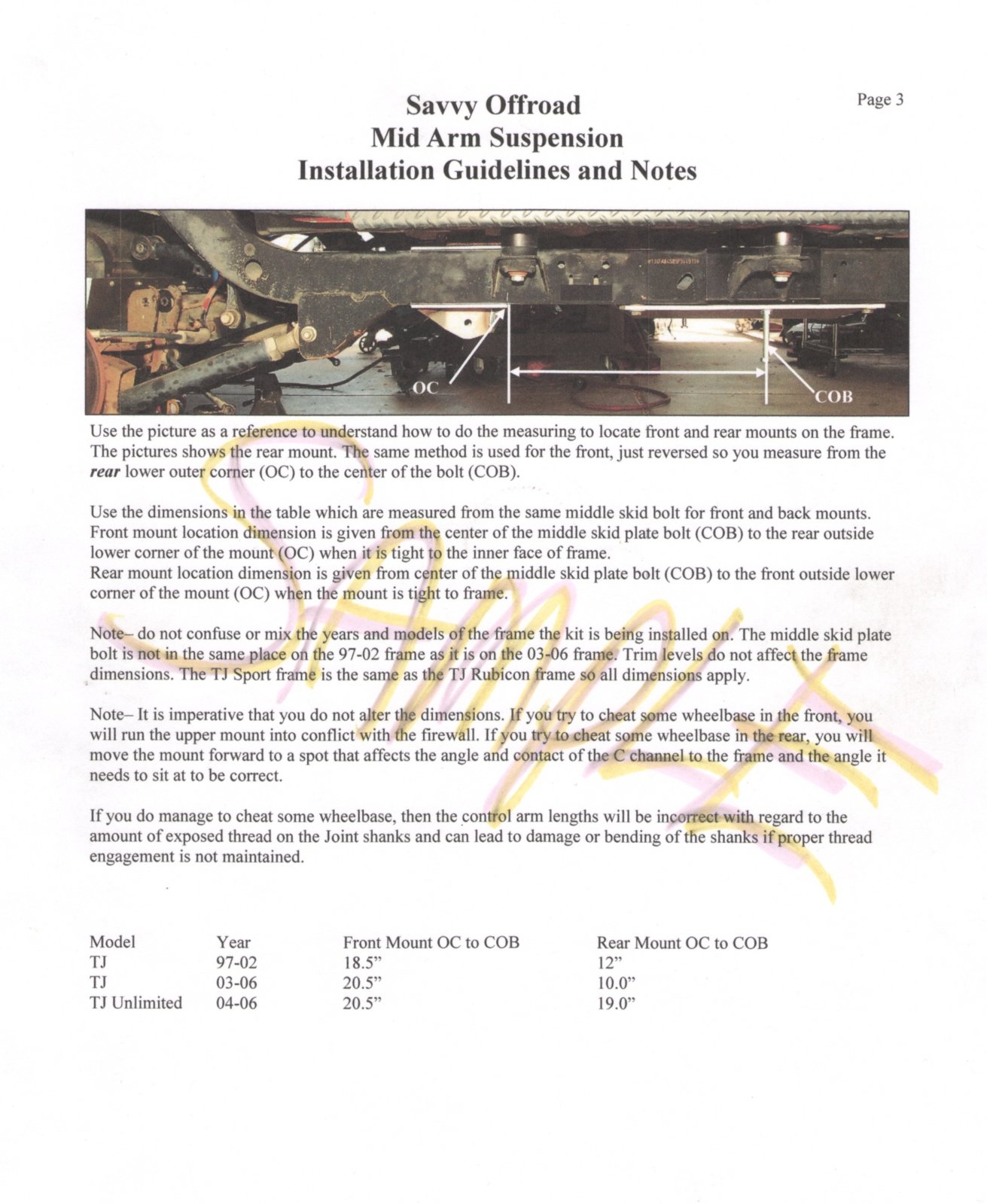

I was wondering what specifically makes mid arm kit so special are the links already cut and ready to go and it’s just up to you to weld the brackets and truss? is it the aluminum links or Johnny joints that’s special? From my understanding the mid arm kit is a no instructions kind of thing and not the best description. Pls correct me if I’m wrong.

Yeah that was just a big question I had reading it and are the link just one size like how about if you want to stretch do you live the brackets or longer links?
You need to do a lot more studying up on stuff. If the consideration for a stretch is to just make the links longer, that implies an inherent lack of understanding on geometry. Not bad, just not knowing.

I do need to study more but what I wanted to know is if you buy the kit are the links a set size? From Chris write up i just don’t see any instruction if you want to install as a stretch. What I’m assuming from the difference between the lj numbers they give is you move the brackets more out? I’m not trying to out build the savvy kit because it’s a good deal and renowned quality I’m just trying to come up with a plan for when I do.

The mounts go in a specific spot. The axle goes in a reasonably narrow range of distance fore and aft and the lift height is within a few bits above and below 4".
If you want to stretch, move the mounts back.

Tommy, to clarify the instruction issue is Marty's fault. When they asked me to turn the mid arm into an installable kit, I told him I would only do it under certain conditions and if those were not adhered to, I was out. He agreed to them. One of them was I would write well illustrated clear instructions and then, only with his help. The last part of that was if he shipped a single kit before the instructions were done, then I would delete all of it.
He again agreed. After he jerked me around for several months getting me parts back that we designed and lying to Gerald about those problems, I told him it was time to get the instructions done since he finally managed after months to get me one complete set of parts. He delayed but assured me that he would be here to do them. I just needed him for a day.
Watching my normal sources of info on the net, a build popped up from Vegas 4x4 with them showing off the installation of the first production Savvy Mid Arm kit. I called Marty to verify that he had shipped a kit without instructions, he said he had. I came in the house, fired up Publisher and deleted all the files I had done, about 10 pages worth. Fuck off Marty.
