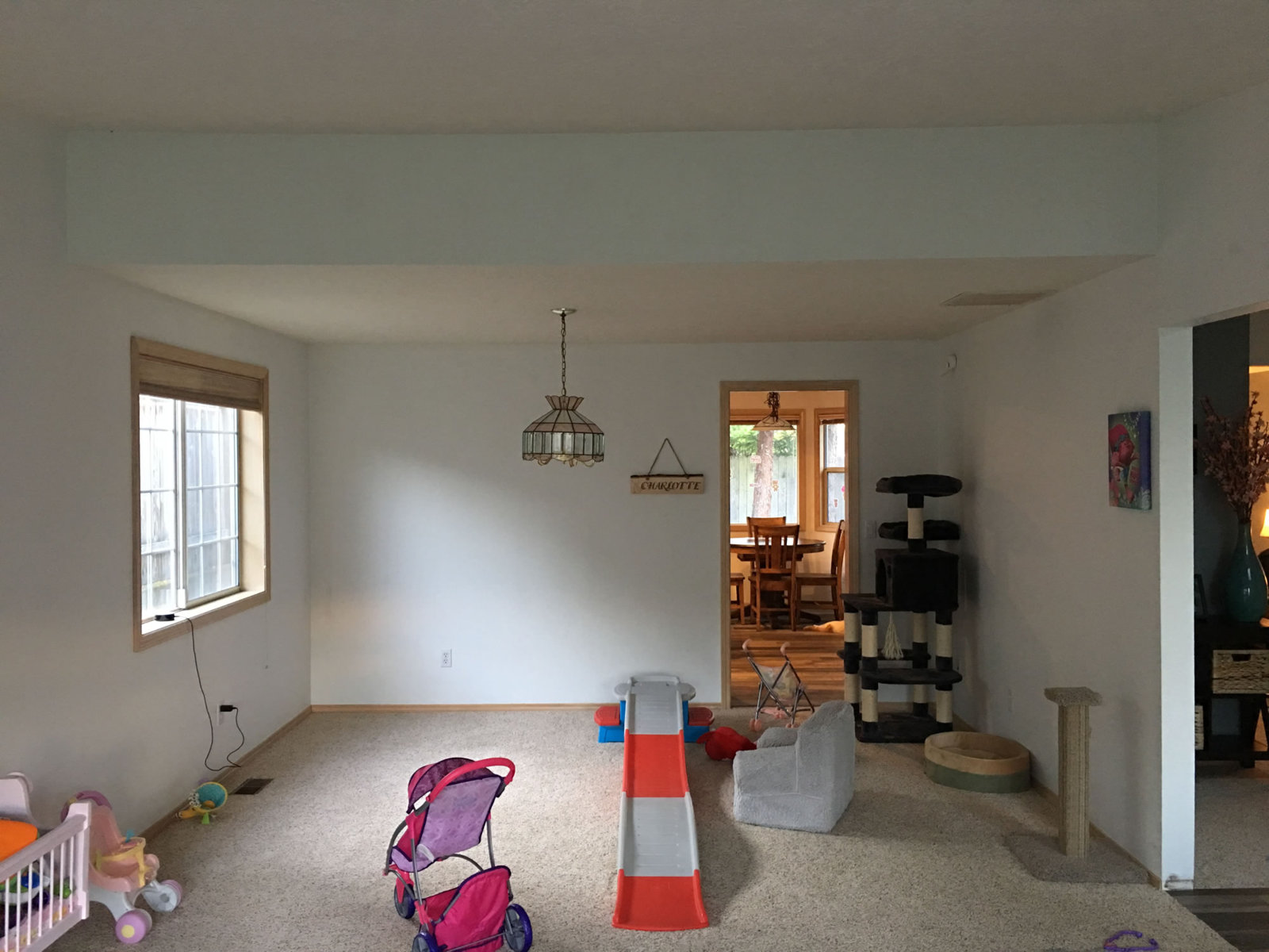

I need some professional input here from someone who has a lot of experience with construction / remodeling.
My wife and I want to turn our formal dining room into a 4th bedroom. We need it for my home office, and the way the dining room is setup makes it very convenient. I've had a number of quotes on this project, but they all came back being a lot more than I want to spend, so I'm going to just do it myself I think.
Here is what we're dealing with (don't mind all the kid toys):
If you notice, there's a portion of the ceiling that hangs down lower in the dining room. What I'm planning on doing is putting the new wall up so it meets the bottom of that low hanging area. The new wall will have a door in it, and that pocket door going from the kitchen to the dining room will be patched up and turned into a wall.
I know how to do most of this. The framing is easy, as is the rest of it for the most part. My issue is I'm not sure what the best way to attach a new wall to an existing wall is, given that the existing walls have sheet rock on them and everything.
If I put up a new wall and then put sheet rock on it, where the seams of the new wall meet the current walls, they are going to have gaps in them (though they'd be small gaps), and that will look half ass. My thought was that maybe I cut the sheetrock off the existing walls in the areas where the new wall frame will go, and then when I put the sheet rock on the new wall, I can install some of those 90 degree metal pieces that attach one piece of sheet rock on the current walls to the sheet rock on the new wall.
This would also allow me to drill the 2x4s on the new wall directly into the studs on the existing walls instead of going through the sheet rock that currently sits over them.
In other words, I'm having a hard time figuring out how to make this new wall integrate seamlessly with the existing walls in the most professional way possible. I don't want this to be some sort of a hack job is what I'm saying.
Oh, and in terms of the best insulation for letting the least amount of sound in, what would you suggest?

Yeah, that's what I was thinking as well. One of the guys who quoted me on the project said we could just attach the wall at the top and bottom, but I felt like that would be a bit half assed.
I have watched drywall done enough that I know what you mean about the tape and then the mud. That's one more reason I figured the better idea was to cut the drywall off the portions of the existing walls where the new wall will meet it. That would allow me to attach the drywall tape where the new drywall intersects, and it would keep the mud from cracking, which is what I want to avoid.

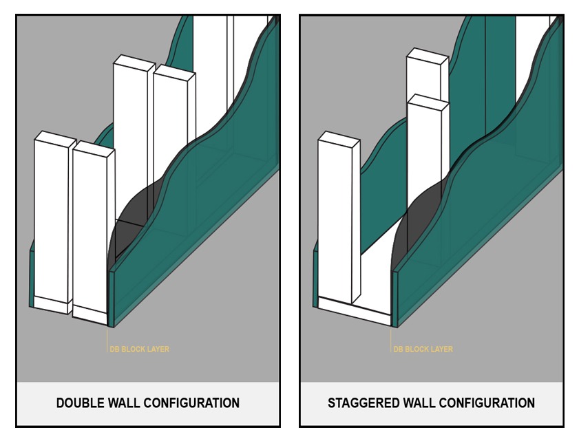

http://www.everblocksystems.com/wall-kits/
If you know how to do the framing then you know how to attach it. If you don't know how to attach it, then you don't know how to do the framing. Run the wall full height up to the higher ceiling if you have room between the opening on the right.
Plumb down at both ends of the soffit to find the location of the bottom plate, get some Simpson screw anchors, the correct size bit and screw the bottom plate down. Using Liquid Nails run the top plate and glue it to the ceiling. Pressure block and stick frame the rest but also glue the two full height end studs to the existing drywall. You'll be able to toe nail the top and bottom to the existing framing behind the drywall.
I'll get you a picture later to show you how to do the pressure block and stick frame stuff since I am doing it right now to fix a totally FUBAR under deck enclosure that was done.
Stop thinking right now. All your existing drywall had small to large gaps when it was hung. That is what mud and tape are for, to fix the gaps and trick the eye into not seeing all the bigger imperfections.
Your chances of there being studs right behind the new wall line are about zero so don't count on it or plan on it and for god's sake, don't open up the wall to put backing in. Once you get sheet rock hung on both sides of the new wall, it becomes a shear panel (albeit light duty) but a shear panel nonetheless and will be plenty strong for an interior partition wall.
The drywall finisher will take care of that. Hang the rock, have them come in and do the mud, tape, and texture and once you paint it, in about a week you won't even remember what it looked like before.
That isn't a suggestion type thing. There are proven methods. Best insulation is a party wall. It is commonly used between two apartments type situation and consists of top and bottom plates that are wider than the stud width. Then the studs are staggered to the outside on both sides so there is no common stud between the two side of the wall to transfer sound. If you don't want to do that, then just do normal insulation and live with it and be aware that you likely have no insulation interior walls elsewhere in the house.
Makes sense, I'll lose that train of thought!
There's a stud at the top soffit, a stud on the right hand side, but none on the left hand side, so you're right!
Interesting, I didn't know about those "party walls" until now. That may be overkill. I just wanted to keep as much sound out of the room as possible, as this "room" is right next to the kitchen and entry way to the house, so I wanted it to be as quiet as it can be. I'm going to use a solid core door for that reason. I think however that a typical wall should probably keep it quiet enough in there. No one here has parties, so it's probably going to be fine the way it is.
Looking at the picture again, I notice a large register in the ceiling on the right side. Is that just an normal HVAC register that feeds conditioned air into that area or is it return air for the HVAC unit that is in the attic? Is that dropped area (soffit) for the ductwork or is it just for aesthetics?
That is a return air vent for the HVAC. What I believe I'm going to have to do there is go up into the attic and shorten the tube for that return vent by about 2 feet. If I do that, it will then come out on the other side of the wall (so it wouldn't be in this new "room"), which is right in main hallway.
I've had 4 contractors come quote me on this room project, and each one had a different solution.
One guy said to leave it where it is, it's fine. The other guy said to leave it there but install another return air vent in the main hallway by tapping into that duct in the attic.
The other guy said to move it to the center of that soffit so it's above the new door to the room.
Basically everyone seems to have a different opinion on this.
