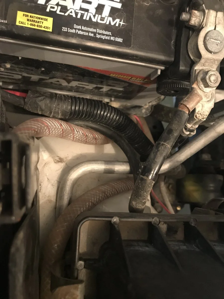

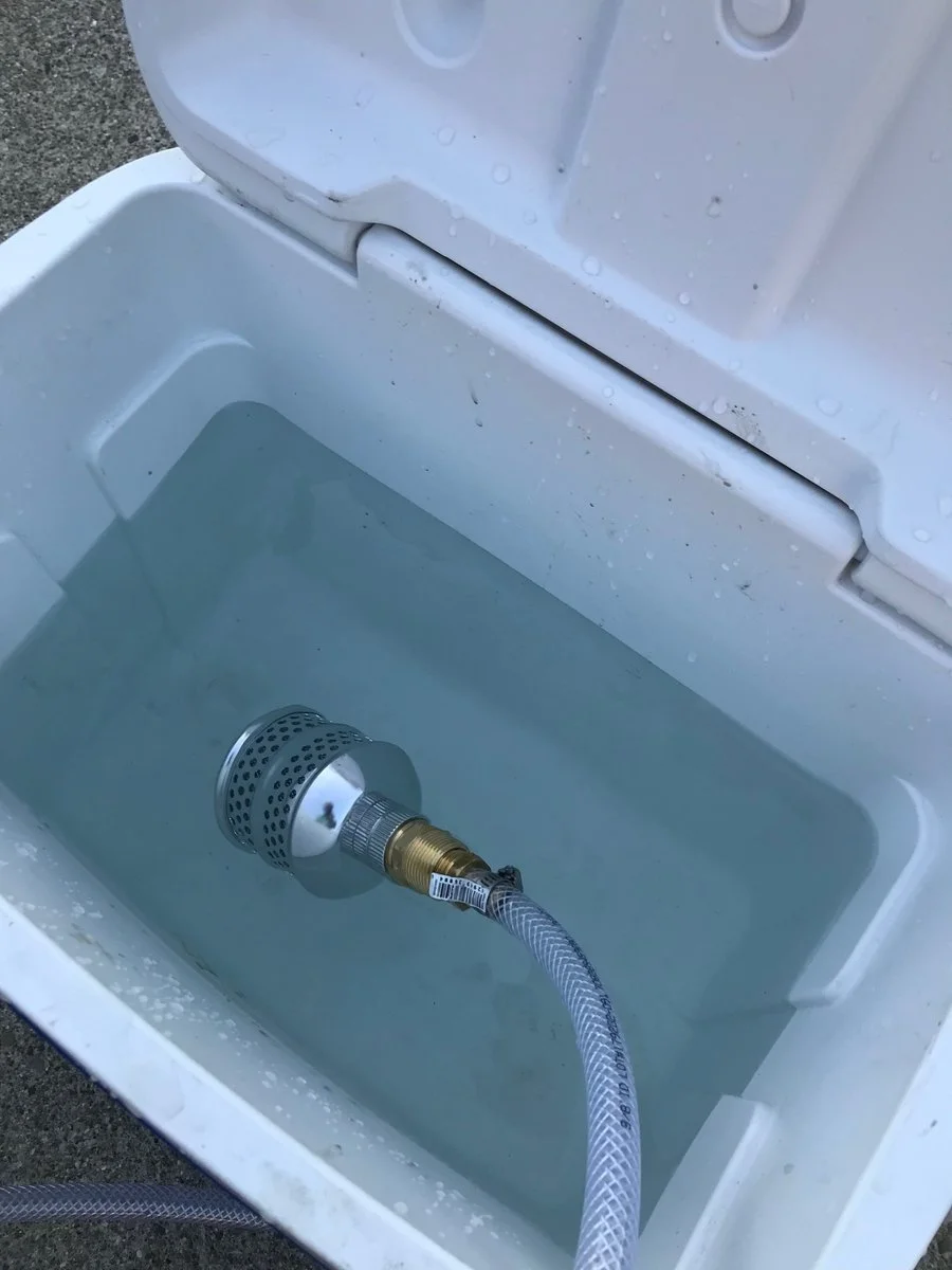

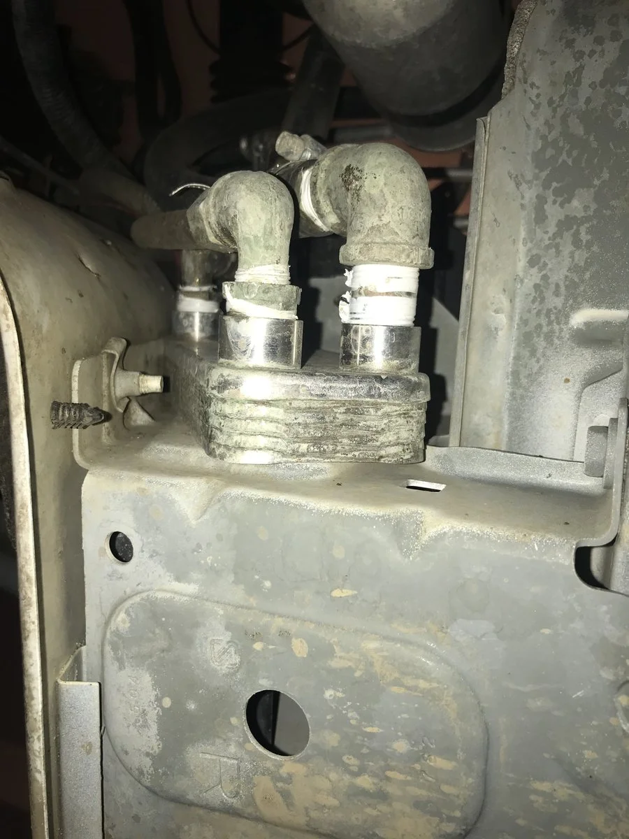

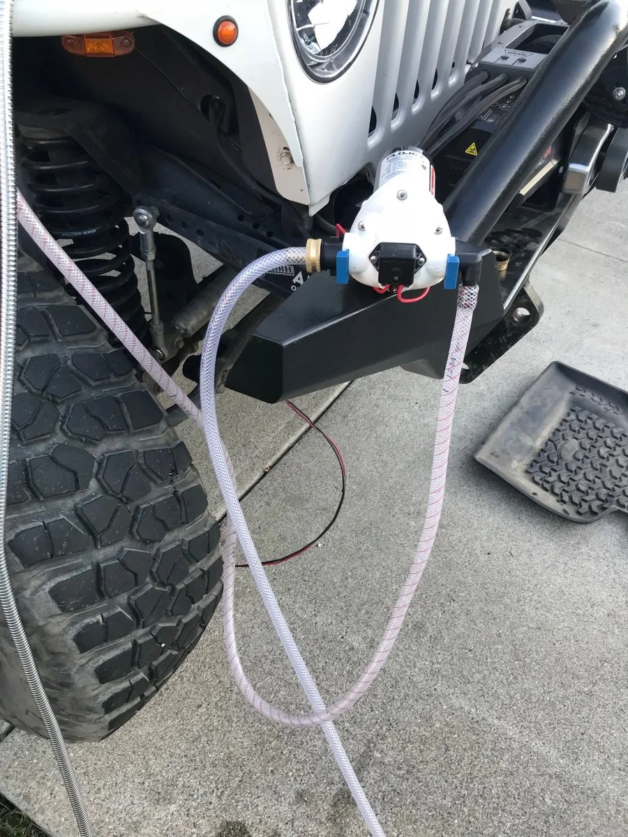

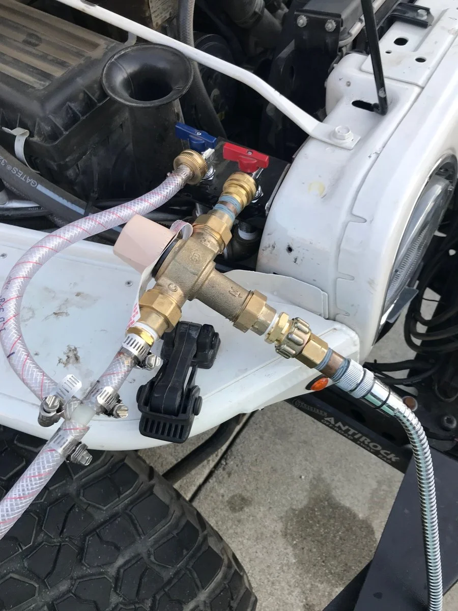

I wish I would have taken pictures as I installed it. I used a 10 plate heat exchanger mounted under the battery. I bought the braided hose from West Marine as I wanted hose that could withstand the temps. Right now I have my pump connected alligator clamps but I may mount it. I filled a ice chest with water to simulate a lake water source to do the testing. During the first few tests the water actually to HOT so I had to add a mixing valve to add cold water and now works great. I mount my connection points under the hood.
You can use this link for some info also
Then my son and nephew took the jeep to the river on the Rubicon and removed the mixing valve, then took a tarp and made a pool out of it. Then pumped cold water from the river through the system and had hot water filling the pool and making it into a Hot Tub. It did fill up higher than this picture shows. You should have the looks we got from everyone :)

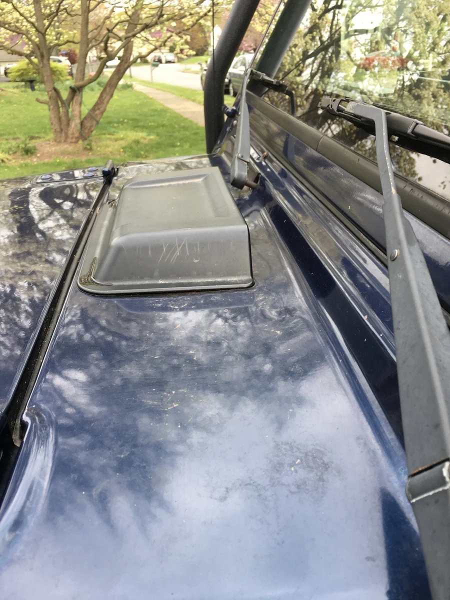

Any thoughts on air intake covers? Previous owner installed this cover, but I'm not sure if it is more of a hindrance and a help. I'm constantly having to stick my hand in there to pull out leaves, twigs, etc. I can't help but to think that all that build up in there must choke off the air supply.

I had a cowl vent on my other jeep. My takeaways are:
1) it was supposed to help re-direct airflow into the vent- it didn't.
2) it was supposed to help keep debris out of the vent- it didn't (in fact, it made cleaning it even worse. It's held on by double-sided sticky tape).
3) it may help keep water out on deeper water crossings- I never tried.
jack.haefner
Mar 29, 2020
17
Herndon, VA
It seems we have the same experience and conclusion. Thanks very much, @dbbd1

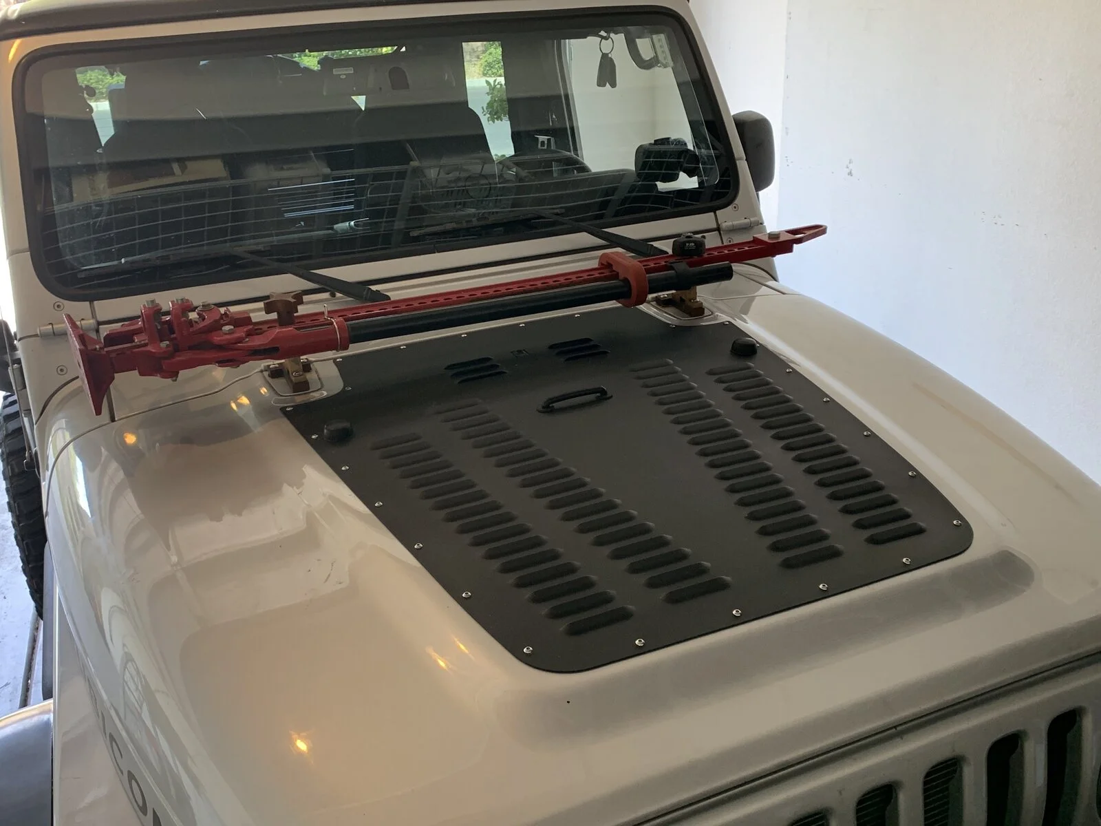

Im fighting a little overheating and hot engine bay, mostly due to an aftermarket radiator the first shop stuck in my Jeep and the second shop left in place despite my wanting it changed for a factory part they claimed it looked good...not. I just picked up a new radiator from the stealer-ship that is going in soon, in the meantime I also installed a set of Eoctric Louvers off Amazon for $103 they look very much like the poison spider. Instillation was straight forward and took me 4 or 5 hours taking my time following all the suggested steps. The operating temp runs around 5 to 10 degrees cooler helping the crappy aftermarket radiator with air flow and the engine bay is staying cool after shut down so all in all I’m pleased with both function and how they look on my Jeep. The quality seems good as well, the sheetmetal louvers seeming equal to the factory sheetmetal and the black powder coat looks good now at least.
Had my doubts it would work for the price but I did buy a cheep $27 air nibbler while at harbor freight, surprisingly it went through the hood sheetmetal like butter, this made cutting out the vent holes a breeze.

Something no one directly mentioned is the airflow … yes this will cool down the under hood temperatures but also help in radiator cooling. Not noticeable in water temperature but the high pressure in front of the radiator will flow up to the louver, which is a low pressure spot, this SHOULD flow more than factory which flows into the engine bay which is high pressure.
Greater differential of pressure = more flow … more flow through an exchanger = more heat removed … win win.

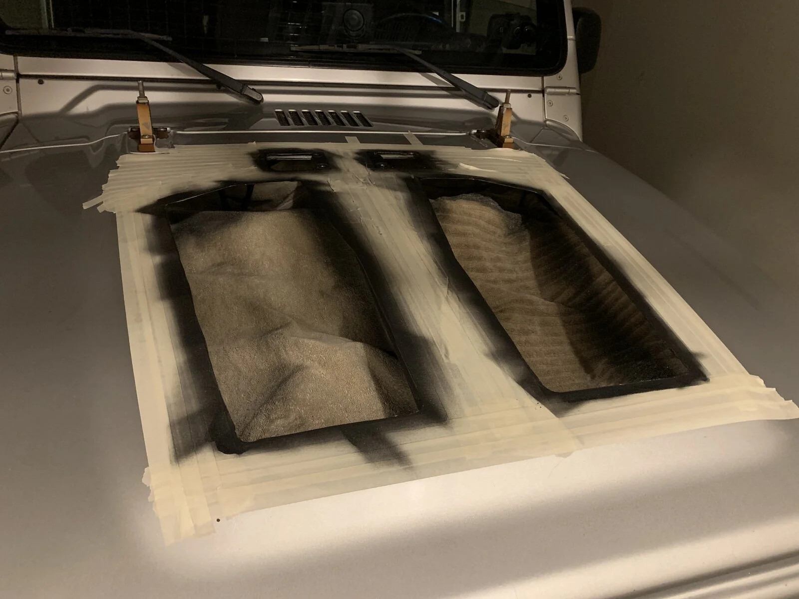

Wondering if anyone has installed hood vents on their Jeep.
I know it is said that the cooling system is adequate on our TJ's but when I open the hood after driving it's hotter than hell under there. The engine may be OK but what about all the other stuff under the hood? Wouldn't some venting help?
