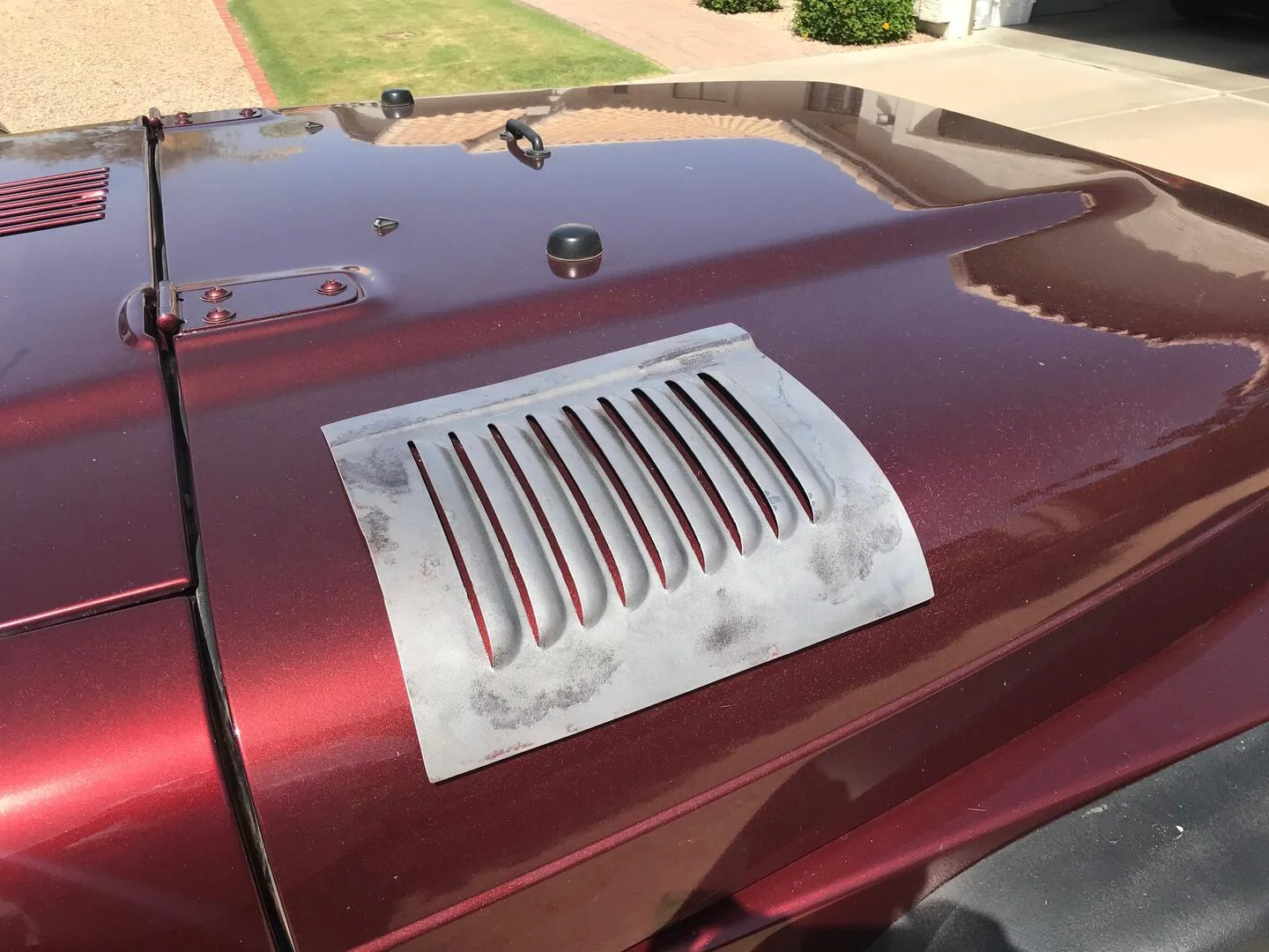

  • MotoBuilt Hood Vents_-_Assembly_Instructions.pdf
These are the worst mod the prior owner did to my Jeep. Enjoy water in your engine compartment when you install them. I'm removing them and putting a solid aluminum plate over the hole until I get a new hood.
No reason to have them if you leave your cooling system stock and maintain your Jeep.
