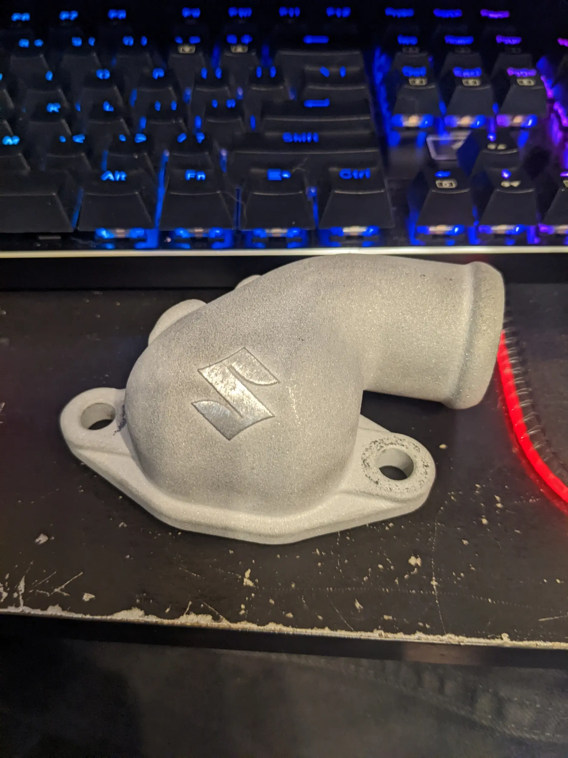

As for 3d printing, the tech has come a long way but the end products are roughly the same, just higher quality, easier and faster. but the materials used today and 10 years ago are all pretty much the same for the most part in the FDM world. though I have a printer in my house that would easily compete with a high end $20,000 printer from 15 years ago, if not beat it. what blew my mind recently was metal 3d printing services have gotten cheap enough to actually be worthwhile. I had this little intake elbow 3d printed for a diesel swap in my samurai for about 200 bucks, shipped and with tariffs included. that was mind blowing. feels, looks, machines and functions just like a casting.

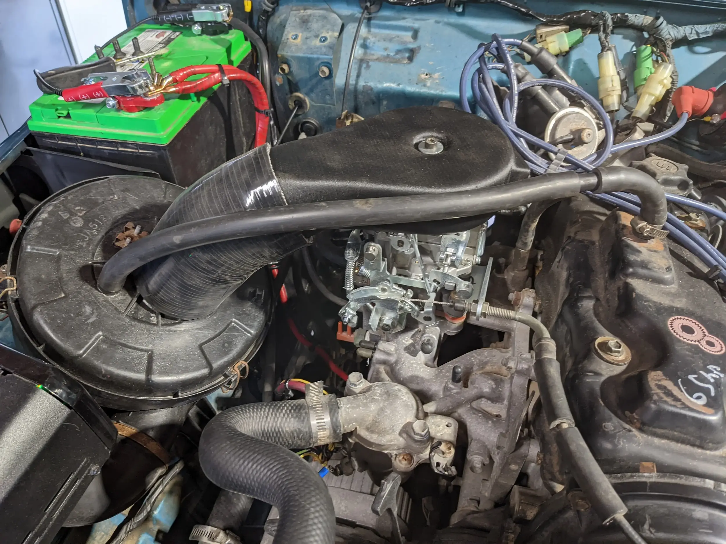

Also did a carb hat for that same samurai on the first iteration of the build with the stock 1.3L engine. printed that from carbon fiber filled Nylon. put a few thousand miles on it offroad and it the carb throat is still clean as a whistle.
