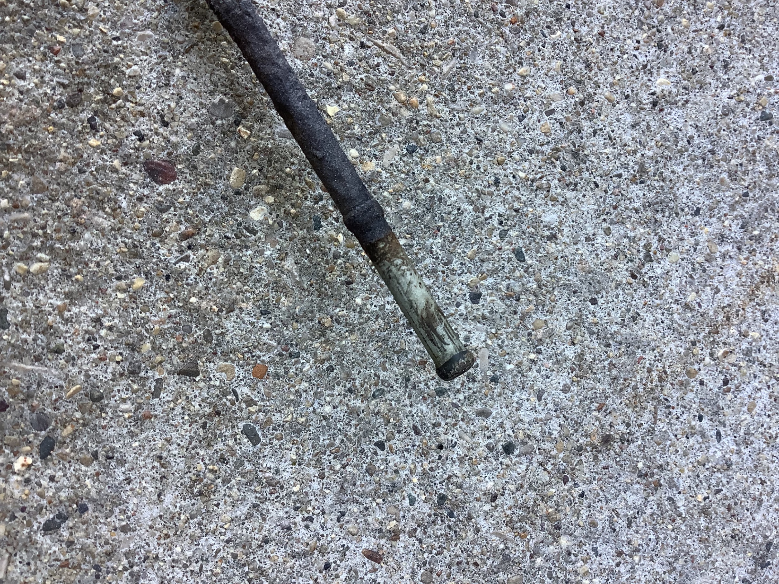

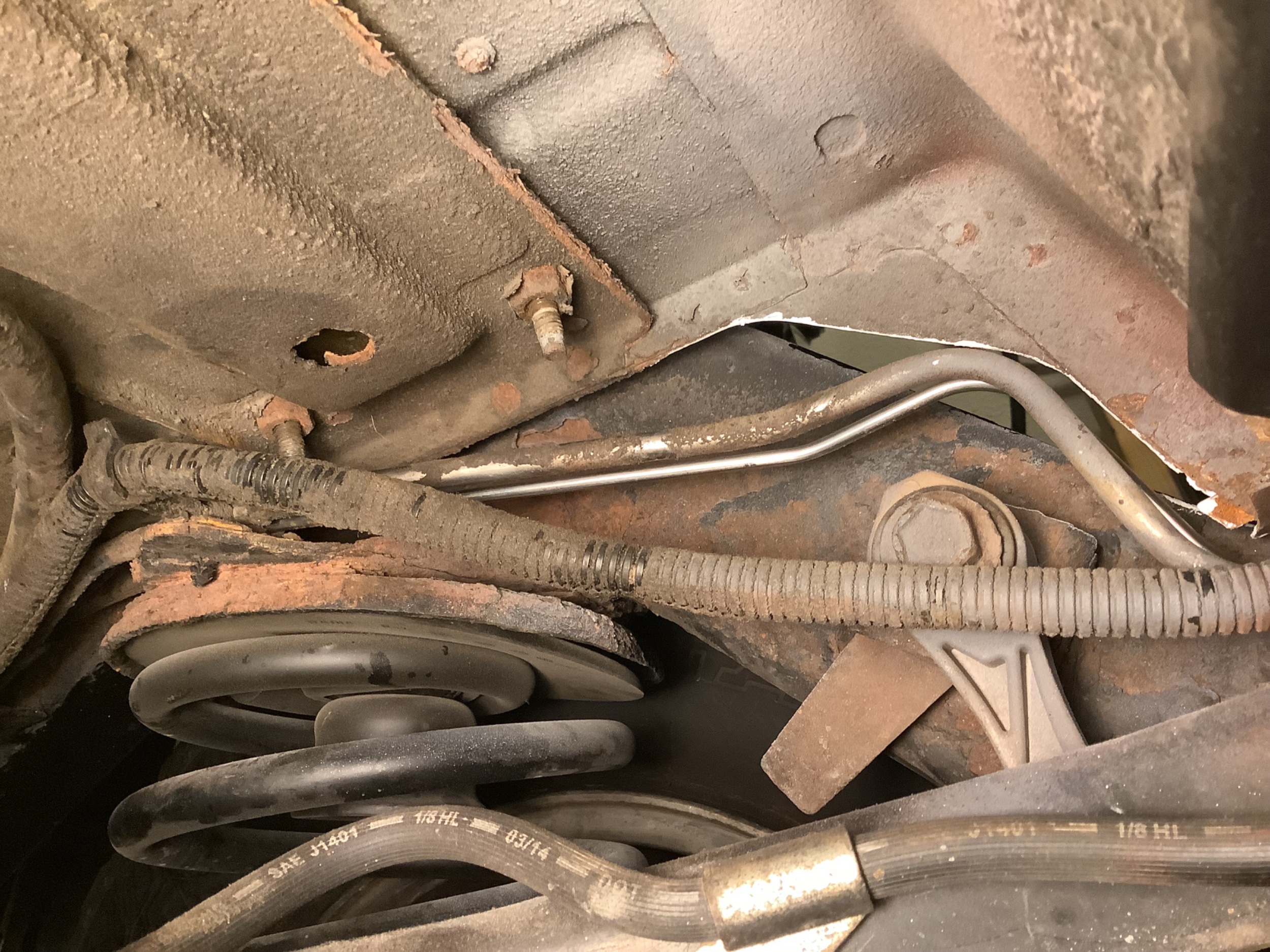

I got P0456 last night. Amazed I never got it sooner. The charcoal canister on my 2002 is under the hood. It is connected to the fuel tank by a long hard line along the frame rail that is rusted out pretty bad. Confirmed it has leaks with a smoke tester.
So I need to replace this hard line and I can't find any part numbers or specific replacement. Surely I'm not the only one to have this happen. Do you use generic brake line? Copper tubing? Something else?

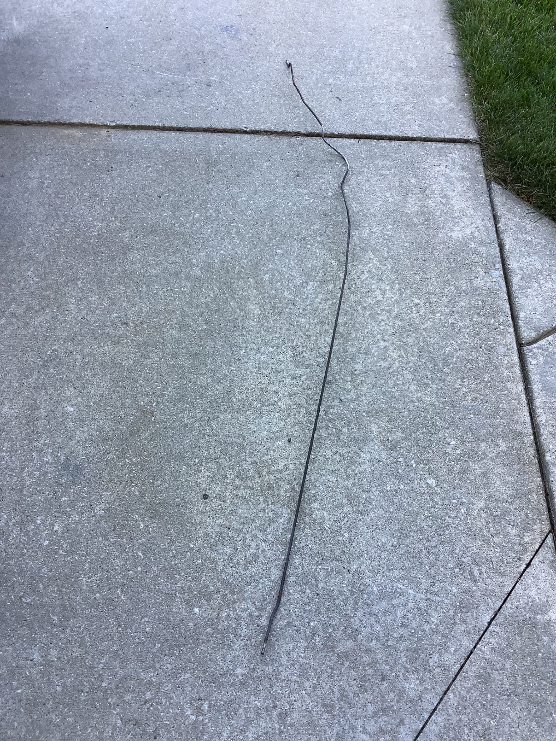

Update:
I guess they sell two different versions. I didn't even realize there were two. They both say fits 97-06 Wrangler but that is not accurate and customer service on the phone isn't any smarter.
They offered a refund if I send it back on my own dime but return shipping cost was $50+. So I have an extra set of fuel and evap hardlines that I think fit 03+ if anyone local sees this and wants a good deal.

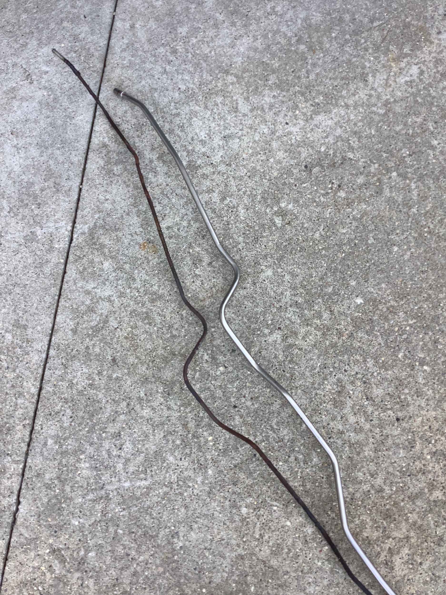

I must be dumb because I took a chance again and ordered the other set of lines with low expectations that I would end up out more money and have two useless sets of lines. To my amazement, the new evap line fit really well. Very happy with it.
Side note: the evap line is discontinued through the dealership.
It took a long time to get this sorted but turned out better in the end than trying to bend lines myself - it would have been difficult to get it right. This would have been very easy if I had ordered the correct lines from the beginning.

Ya, the diameter was smaller 3/16" vs 5/16" (which is odd because their measurements were OD for tubing) and I think the line was longer and slightly different bends possibly.
