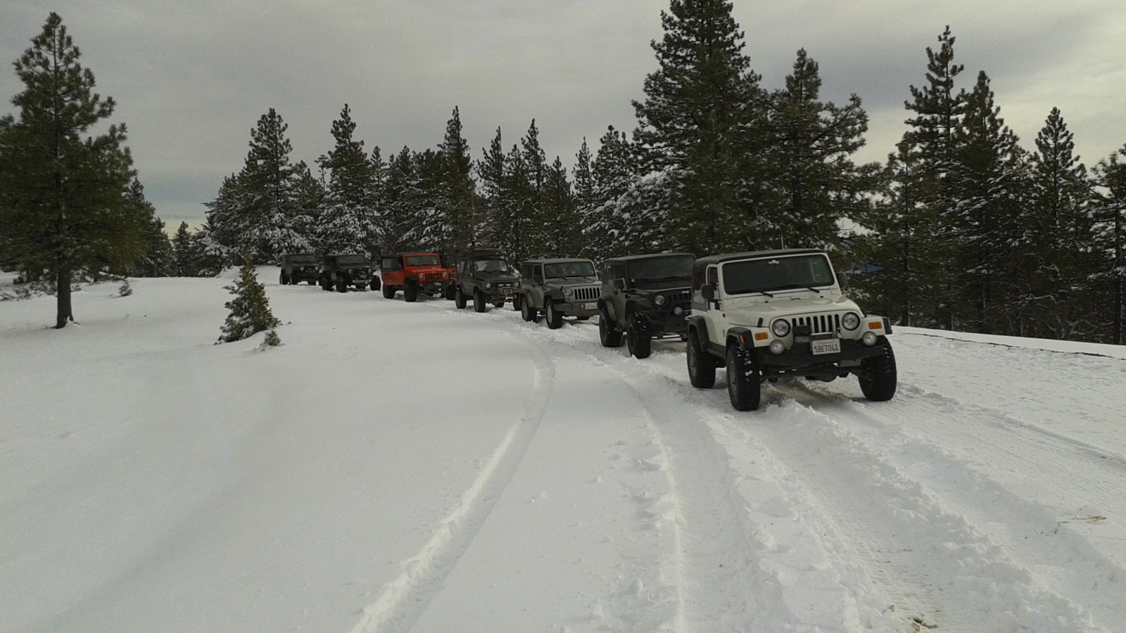

I didn't seem to have too many problems hanging with these guys open front/LSD rear.
