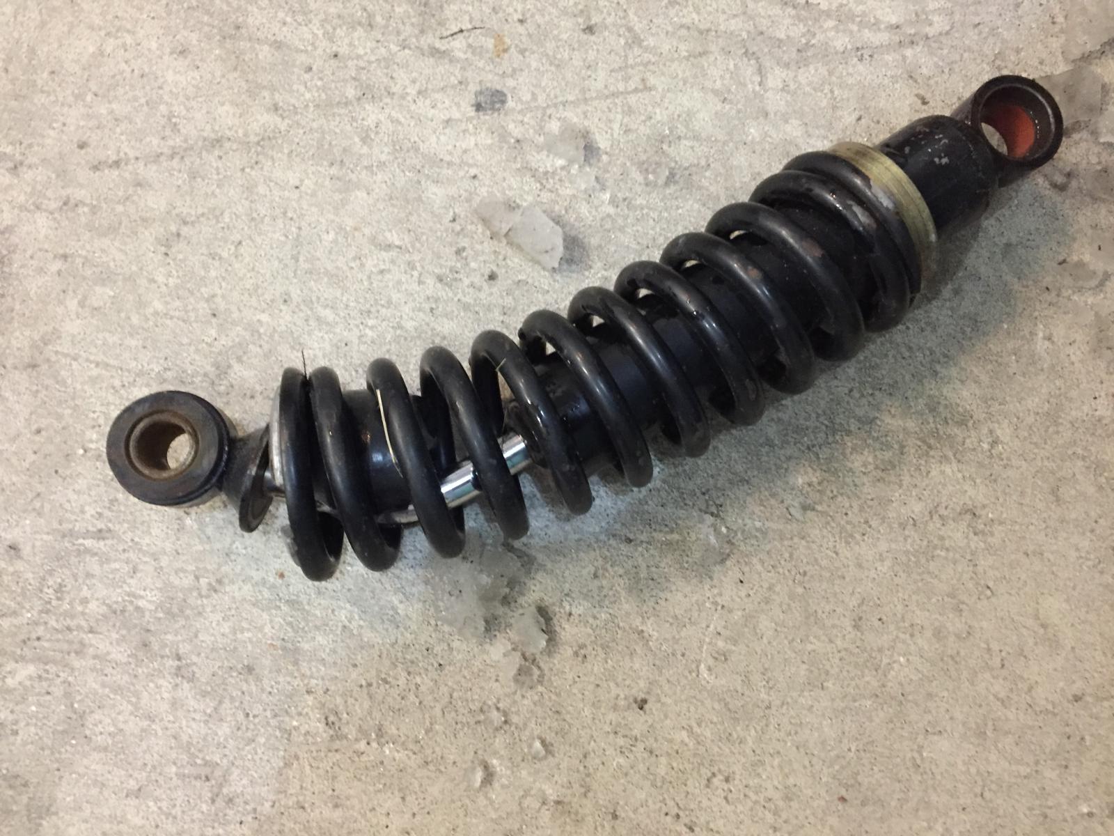

Anyone tried modding a shock?
I bent mine to get better clearance around the rear spring buckets. :sneaky:
