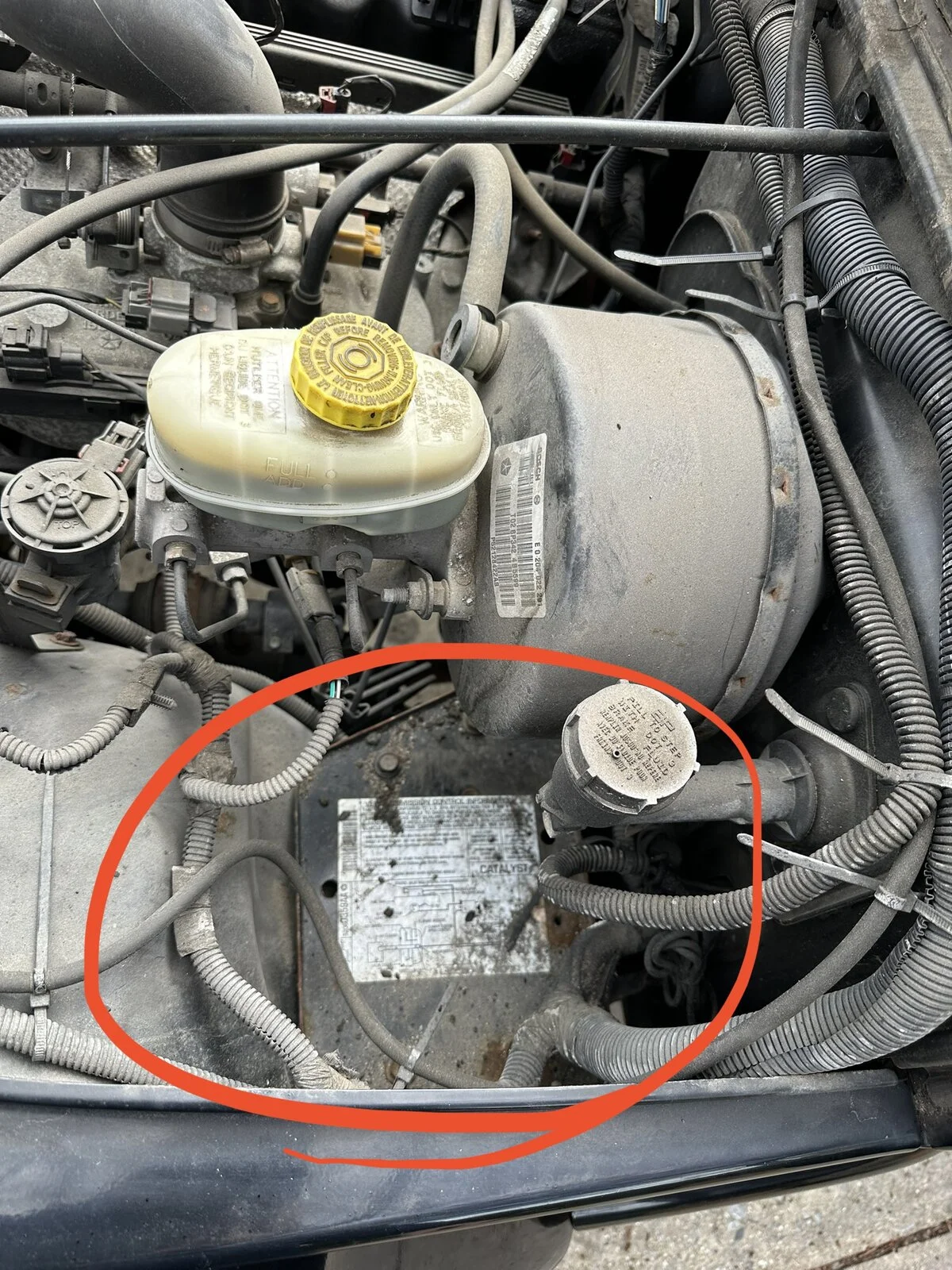

I’m planning to add an ARB compressor, for (yet-to-be-installed) lockers and for airing up. (I don’t and won’t own air tools.) Is the twin just a matter of convenience, or is there a functional difference that I should care about?
I can mount the single on the driver’s side of the engine compartment, by the firewall, on this (seemingly) perfect platform. I don’t think I can fit the twin there, and I don’t love the over-the-engine option. Does anyone have experience with it—does anything need to be relocated?

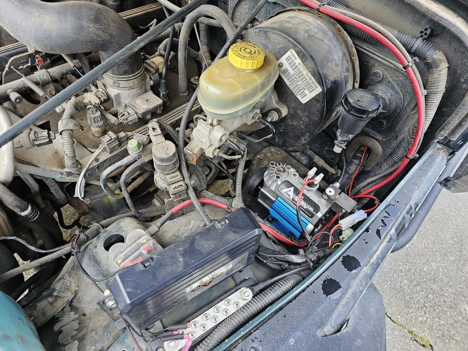

Here is my single ARB in the area you are questioning. I run the single as I only need it for my rear locker the front is a e-locker for now. I use my SB compressor for airing up i transfer it between vehicles

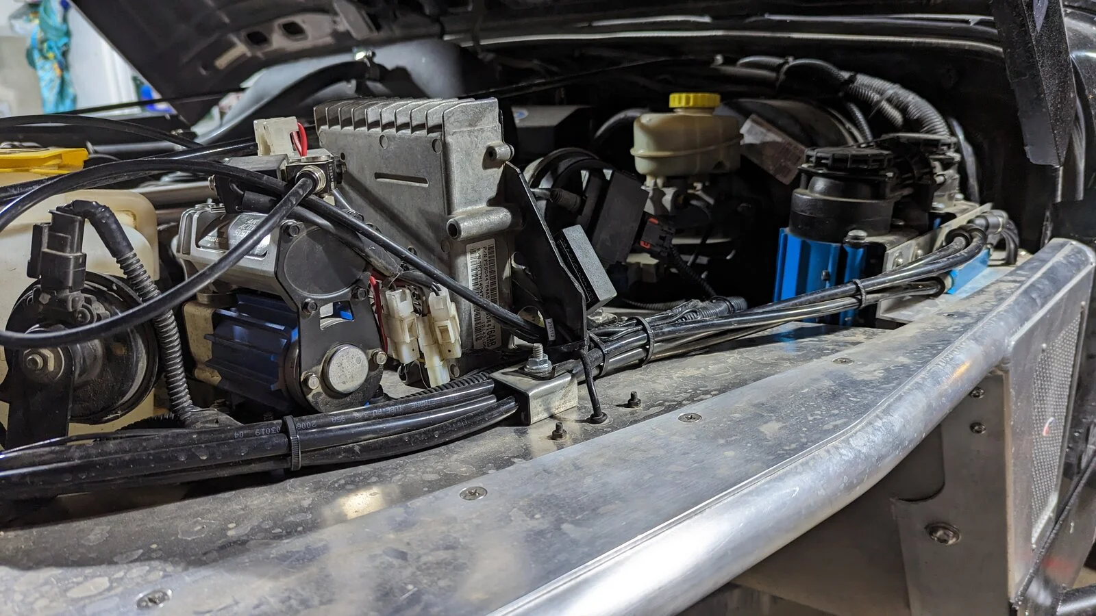

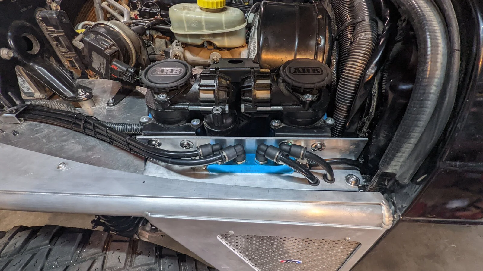

I have both, small for lockers and large for tires. When I was getting my lockers done, everyone said I was crazy to send the extra cash when I already had the dual installed. Not long after getting the new lockers the switch for my dual died on me out in JV. I was able to use my wife's compressor to air back up and had my lockers the working entire time.
Twin fits in the spot you asked about. I used a 2 hole angle bracket attached to the fire wall, attached a piece of angle to that and ran it across and secured it to the fender.
