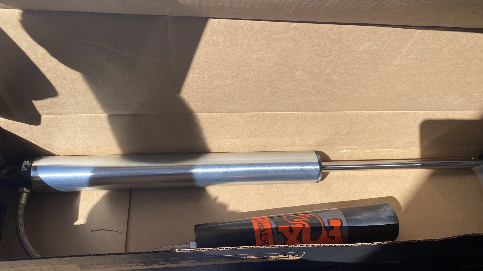

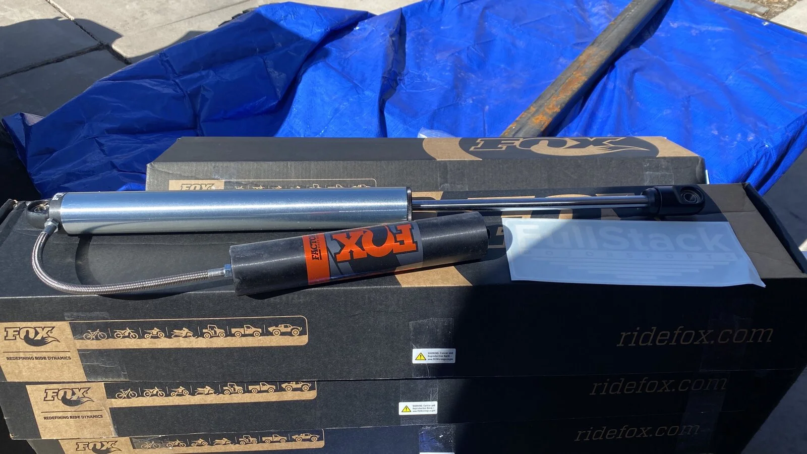

Currently running Rancho 5000x 0-2” shocks with my 2” OME lift. Rides pretty good. Looking to go to a 3” lift and get some longer shocks. Specifically looking at the Fox 980-24-643 and 985-24-086, for 2.5-3.5” of lift. My main question is, are these fox shocks worth the price? Don’t have the budget or the need to outboard and have remote reservoirs and what not at the moment, but possibly in the future. So is it worth getting these fox shocks for now or should i just get some longer 5000x’s, and eventually save for some higher end fox’s.
Also, are these shocks tuneable? I’ve heard some say no and some say yes.
TIA
EDIT: Some info about the shocks in question:
The set i’m looking at is on marketplace. It is a set of 4, completely brand new. The owner bought them, but totaled their jeep before they could install (have photos to prove it). They are listed at 400$, could possibly go even lower. This may help others advice my decision. Thanks.
