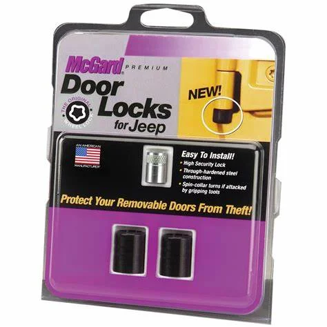

I just undo the two nuts form the pins and lift, install the other doors and reinstall the two nuts. I change back and forth a couple times each year depending on the weather. I do the same with tops, Bikini, full soft top and hard top
I also use these Mcgard locks each time, since these doors are so easy to steel, this is cheap insurance
https://shop.mcgard.com/jeep-wrangl...hread-size-set-of-2-locks-and-1-key?sku=76058
I use those also
They keep me from stealing my own doors
