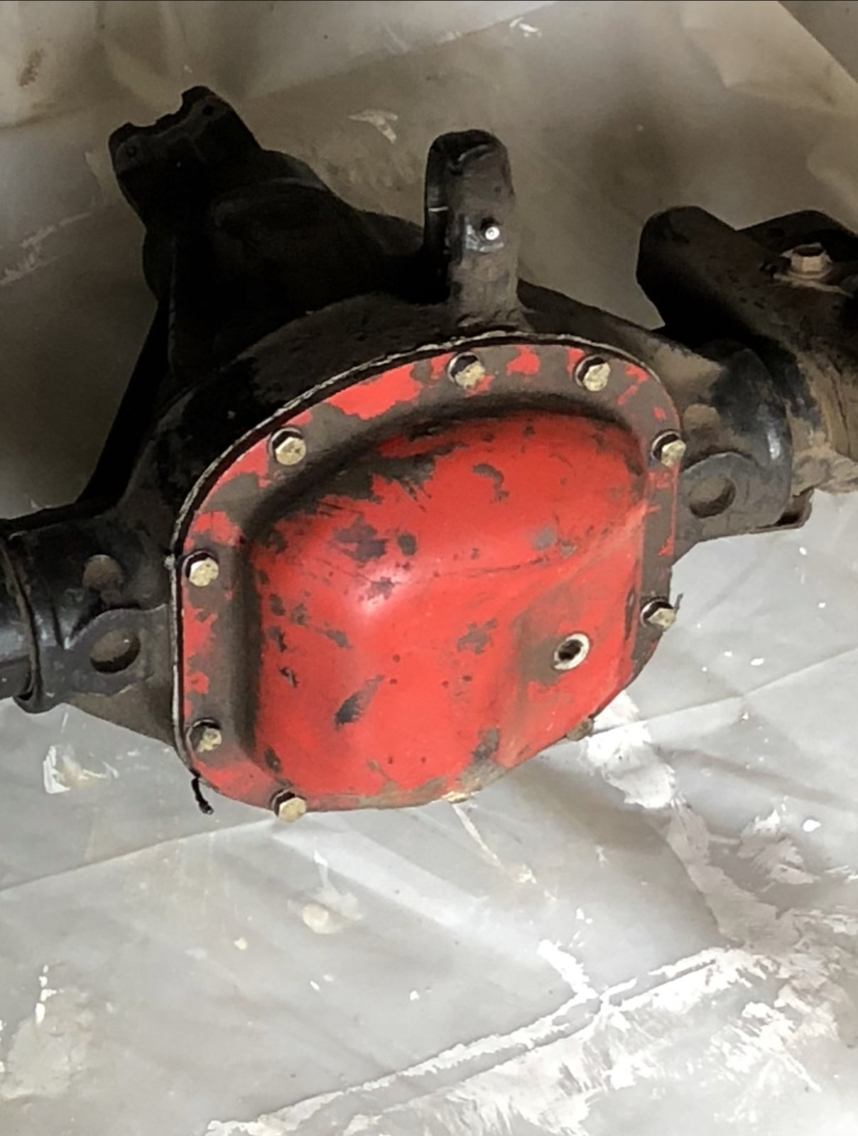

Hah...This is a timely thread. I've been looking for a fab project as winter sets in around here. I'm trying to keep my self from going nuts and pulling the engine on the TJ to paint it or some crazy shit. I found a guy selling front and rear factory D44 covers today, so I bought them. Figure I'll buy some 1/8" plate and build up some Barnett Copy Cat covers. I got them for 40 bucks, shipped, so no big thing if I eff them up.
