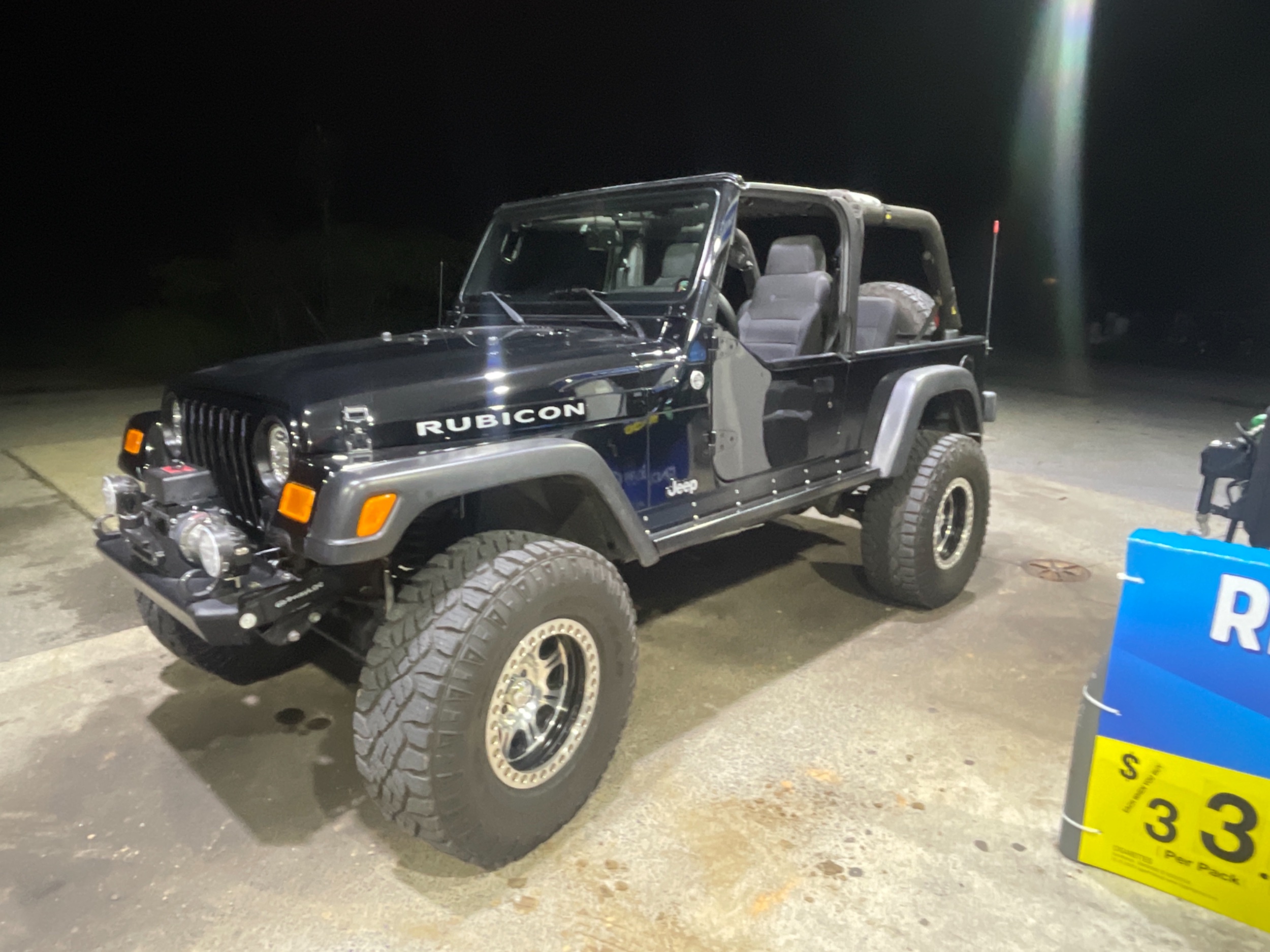

This Black LJR is all savvy aluminum- and built for 35’s all the way
They both drive so good you can’t pick one over the other-I say that because I believe that control arm bushings play a considerable part in the ride and handling equation- any excess axle movement will defeat good steering typically.
The 33 inch tires on the white rig have taken me pretty much to the limits of my nerve- the black one just makes the same obstacles a lot easier- like something sketchy on 33’s is a speed bump to the ljr on 35’s.

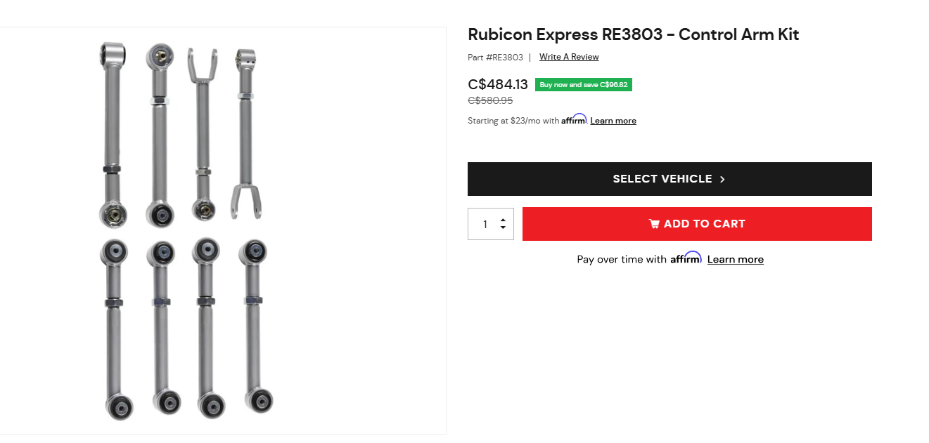

There were issues with the RE bushings many years ago. I'd keep searching
So just because there was an issue many years ago, someone should abandon a companies product? There have been several issues with Jeeps, yet people still buy them. A company can fix an issue.
In this case your statement is correct. Many of us had problems with the bushings in RE control arms. Maybe you've had a positive experience.
Reactions: mjonesjr84
I've not had any experience with RE. I just don't like blanket statements like that when it includes "many years ago." Every company on the planet goes through growing pains or issues from time to time and to just completely abandon them is not good form IMO.
OK SO questions. clayton is gonna take fooooorever to ship to me and the shipping is insane.
are these any good?
If your still looking I posted a set of used rough country arms, 4 inch springs etc. I was looking for $100 for everything but really just want it out of my garage. You could put joints in them and have something serviceable for fairly cheap. I have the track bar also but would recommend a JKs or Rock Jock.
I said no because they are using a bushing with a solid arm. There is not much torsional flex compared to an arm with a JJ or even the stock control arms which flex more than you think. Those arms can lead to ripping off stock control arm mounts. I've seen it plenty of times.
I wouldn't mess with anything that had anything except a Johnny Joint, unless you wheel east of the Rockies and have more clay in your soil (like me) and then would use a DDB like Synergy or the Girro. Clevites are good in stock arms, and I've had success using them in aftermarket arms with a flex joint on the opposite end.
