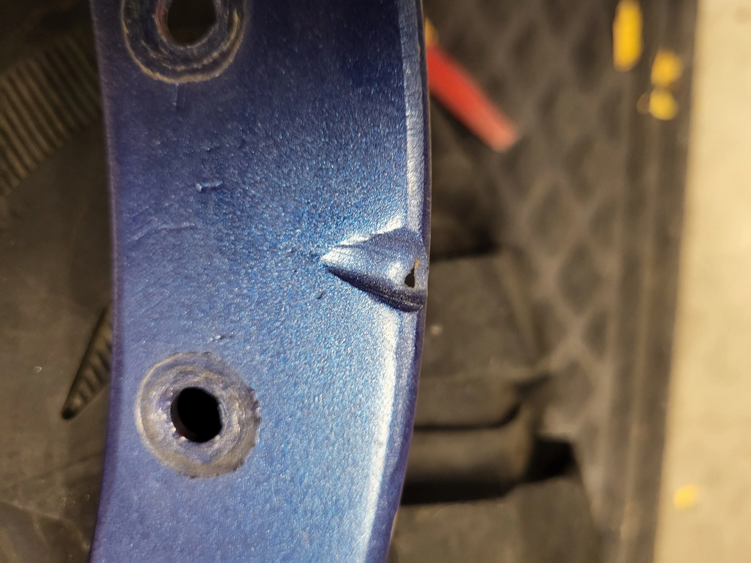

I popped the ring off one of the Walker Evans beadlock wheels on my vehicle, with plans to replace the valve stems with stems that have a ~85-degrree bend and and a hardware clamping mechanism. I want the bend to make it easier to air up/down without pulling the stem away from the beadlock ring, which currently blocks it. I want the hardware clamping for additional assurance against air leaks around the valve stem.

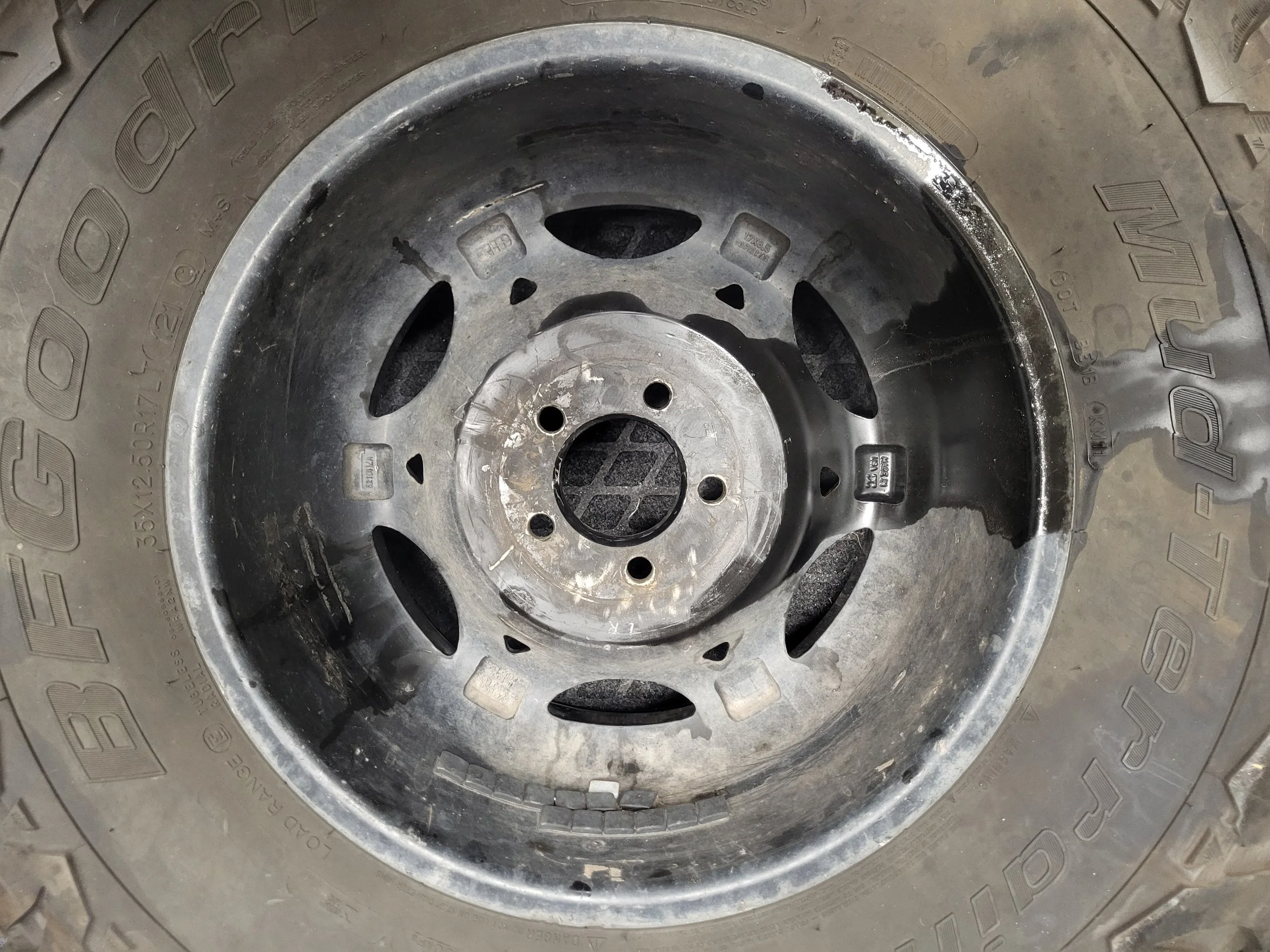

I assumed that when I pulled the ring off I would see the tire bead between the ring and the rim. However, the tires are installed "normally" (inside the rim like a non-beadlock wheel) rather than using the beadlock ring. I'm now debating whether to use the beadlocks as the wheels were designed for or leave them as-is. I'm leaning toward leaving them as-is for now, but still want to replace the valve stems which requires breaking the bead.

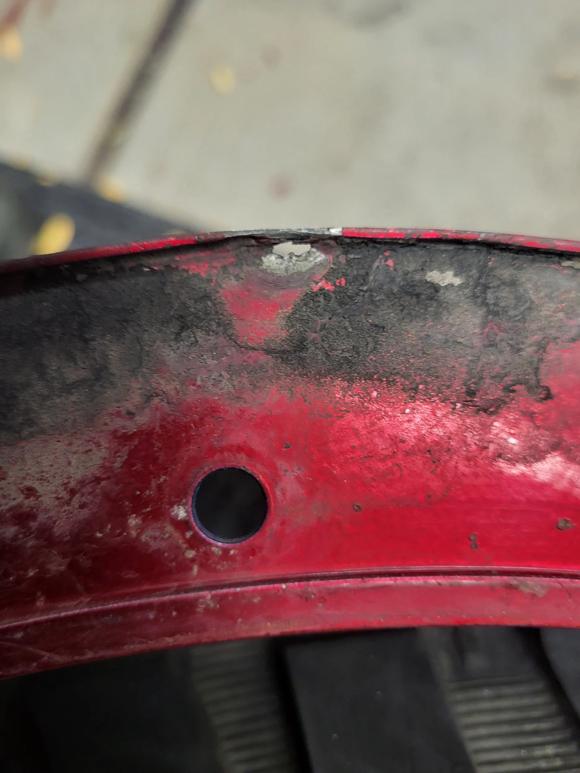

The rings are also abused enough that I would consider replacing them before I attempt reseating the tire using the beadlock functionality.

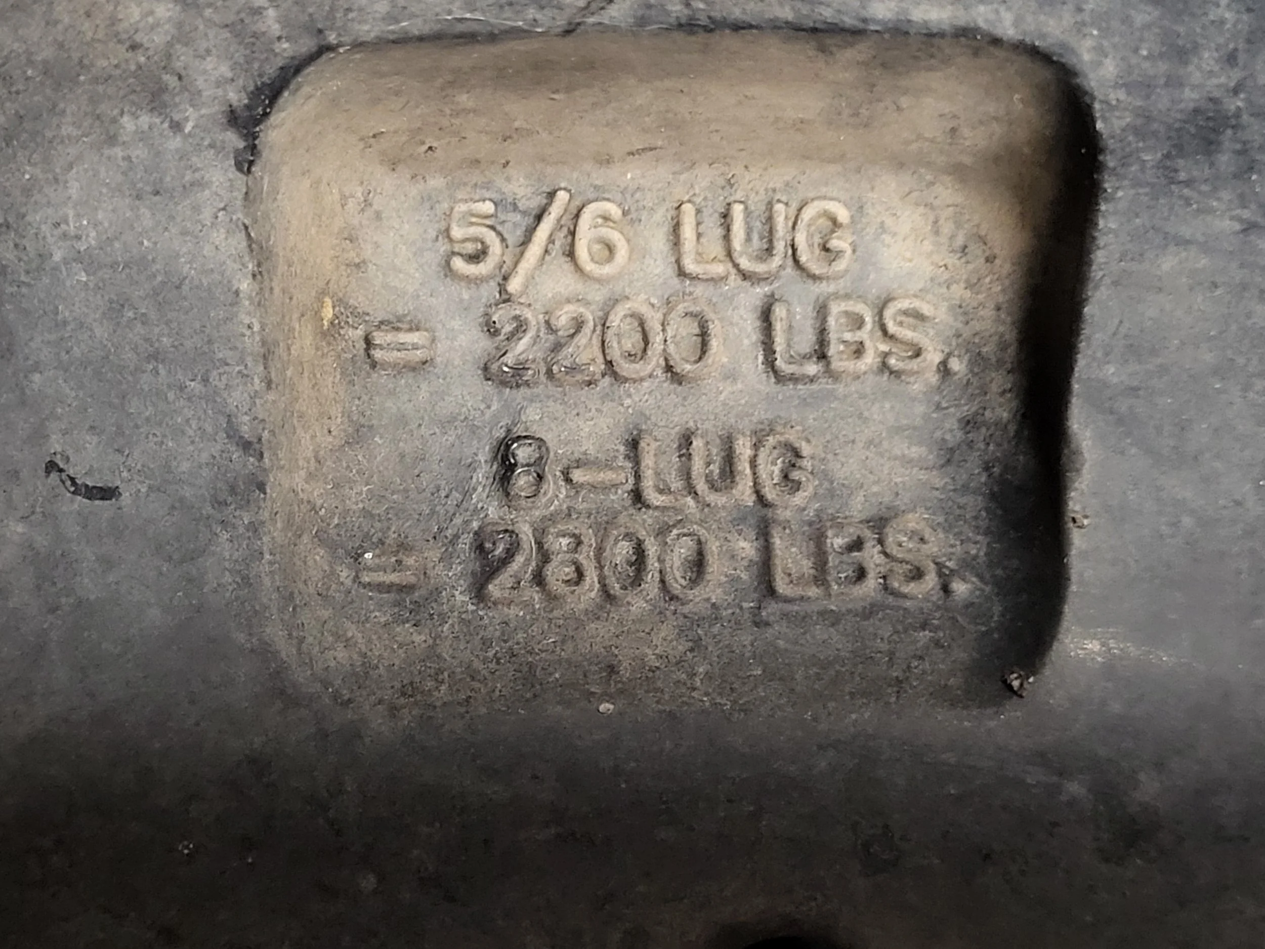

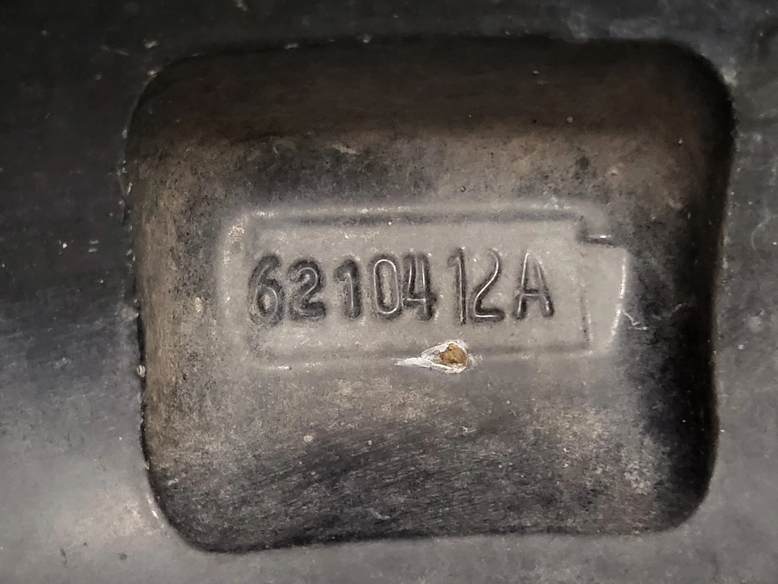

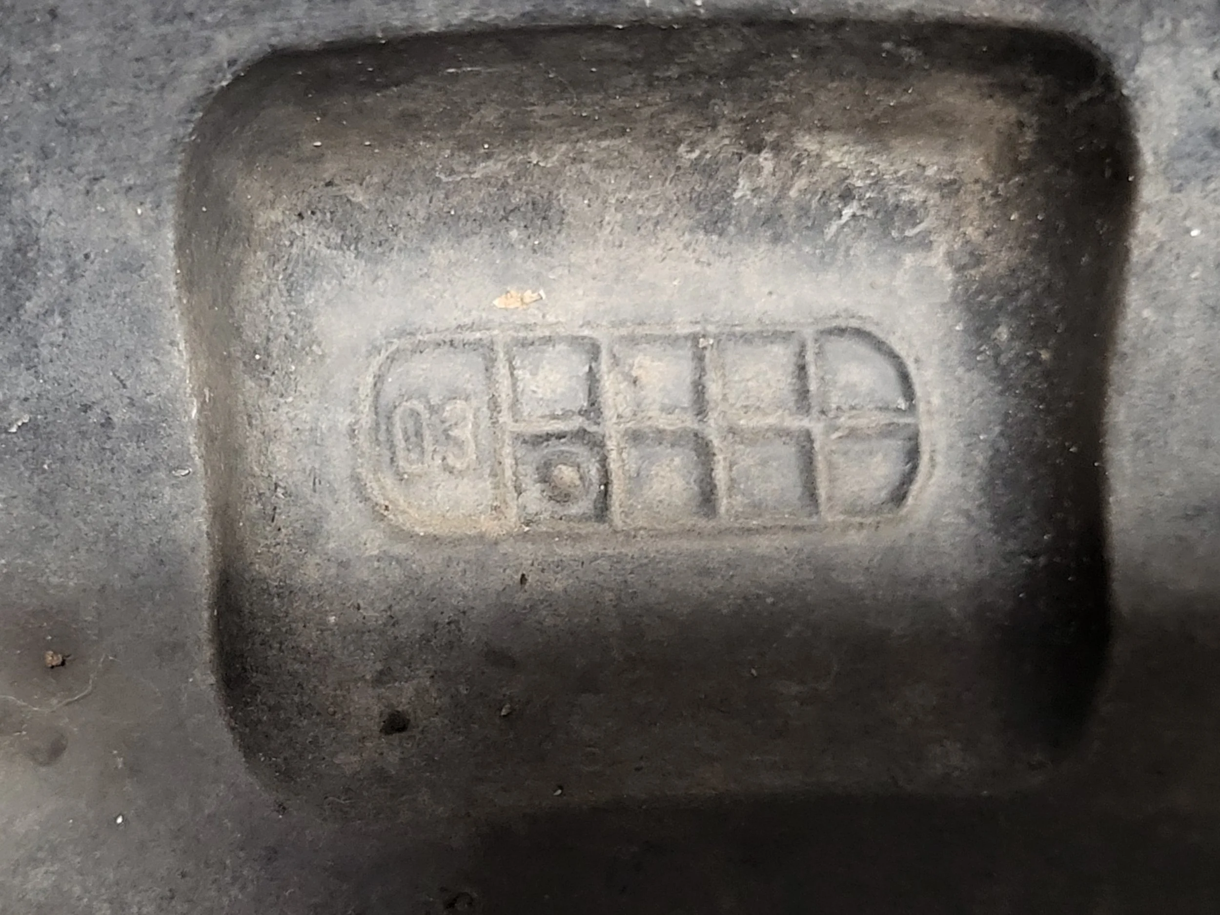

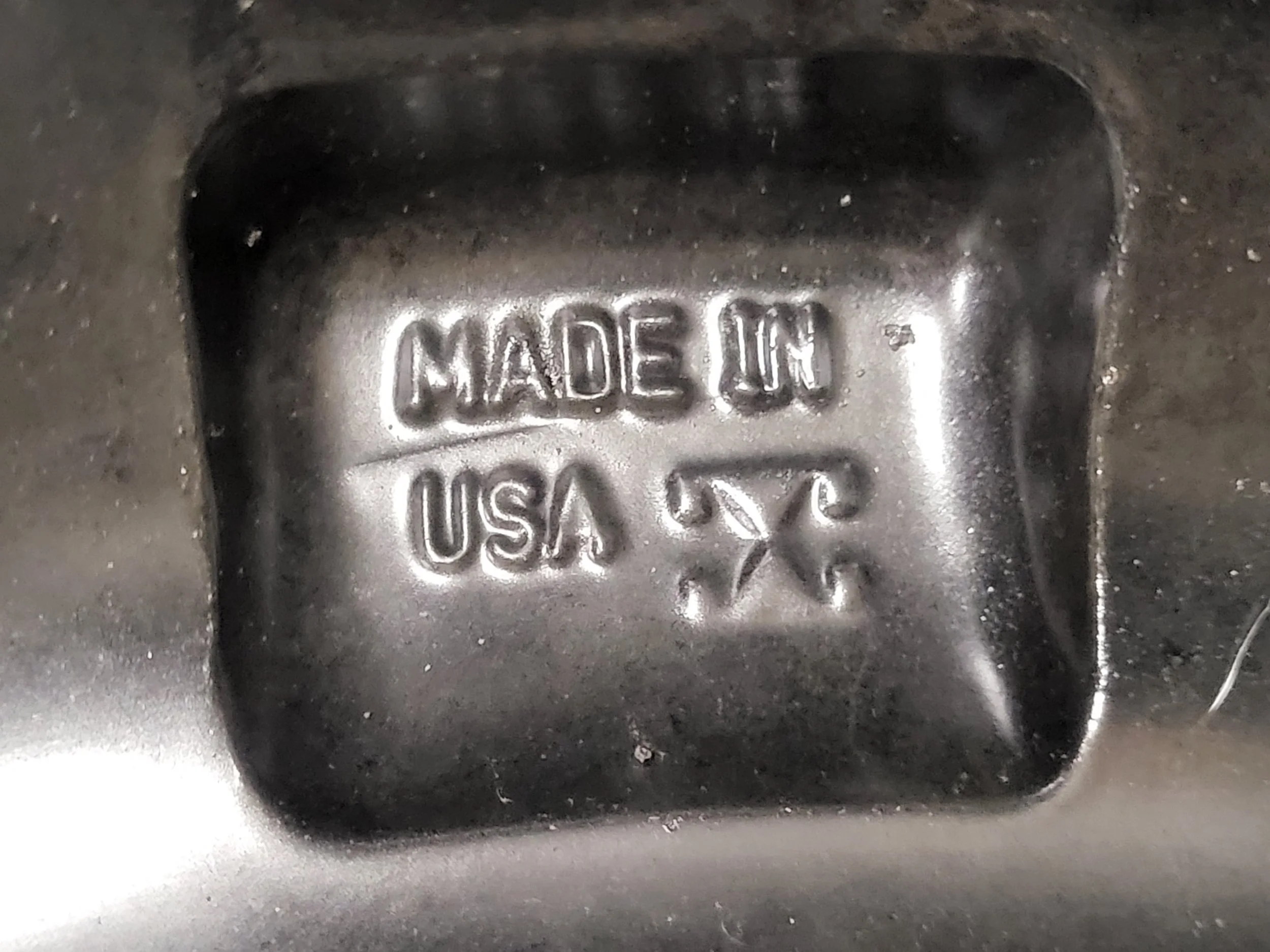

Here's some pics...
It looks like the rings were originally red, then abused, then painted blue. I'm tempted to repaint them (another shade of blue to match some other paint on my Jeep). I assume painting both sides of the rings is OK (the paint won't effect the beadlock functionality if/when I ever re-install the tires using the beadlock ring as the wheel manufacturer intended). However, looking at the abuse on these rings, I might just replace them (buy new rings, and probably bolts too).

If you can fill them to street pressure without the ring installed, then those are not beadlocks.
Reactions: mojowrangler
Those look more like trim rings.
Some wheels you can swap the trim ring for a beadlock ring but I’m thinking those don’t have that option based on the design.

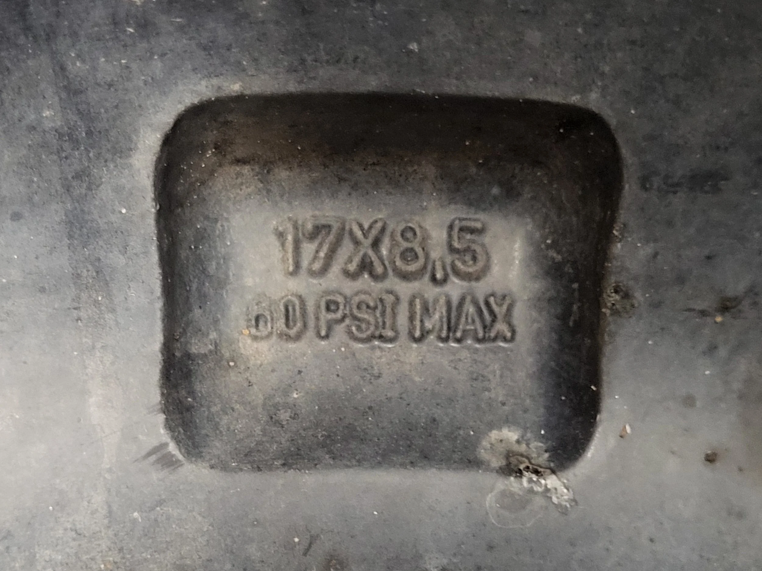

Well, I've spent way too much time looking at these wheels. I tried to positively identify some kind of wheel "model", but that doesn't seem to be easy to do. I found a lot of wheels that look just like mine (usually in different finishes, but similar wheel design from photos. All the wheels that I saw that look like mine claim to be beadlock wheels. So, I'm guessing these are beadlocks, but the tire was mounted inside the rim (like a normal tire) instead of outside the rim. I could be wrong. It's a moot issue for me in the short term since the wheels/tires seem to perform well the way they are setup now (except for a recent leak that I think was related to the valve stem). I have a minor concern that the tires are not "supposed" to be installed inside the rim on these wheels, but I also figure they wouldn't have held up this long if that was the case (which is the main reason I want to positively identify the wheel model, specs, etc.). In the long run, if I decide I want beadlocks, I'll take these into one of our local 4X4 shops, see what they say, and go from there. If I can use them, great. If I can't, new beadlock wheels look pretty damn expensive, so I'll have to "really want them" (emphasizing the "want" over need here).

I saw some other examples googling around and could never find an example (in pictures) of the so called "streetlock" wheels. I was hoping to compare and see if they went to the trouble to use real bolts on these (again, a waste of 24 bolts that serve no purpose, so I suspect they just use some kind of "bolt head facade".
