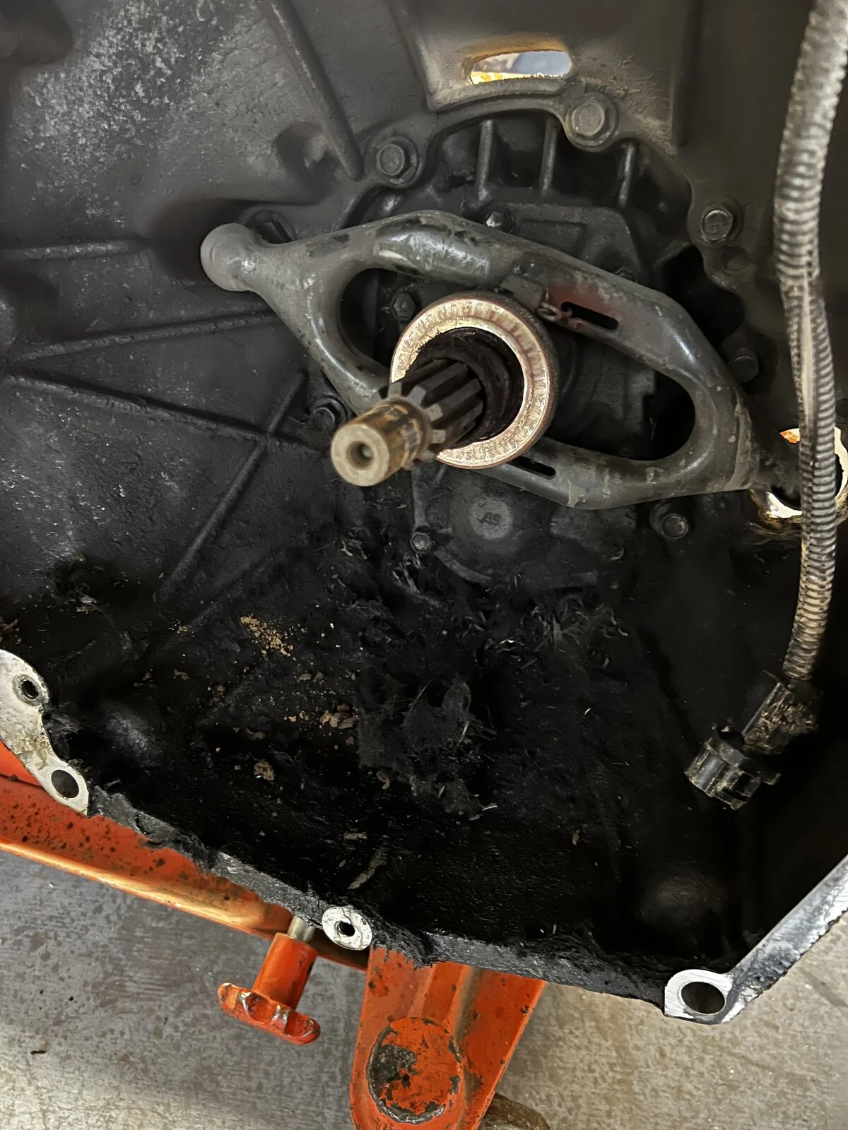

I have a feeling that auto swap aside, I would have been pulling this trans in short order anyways….

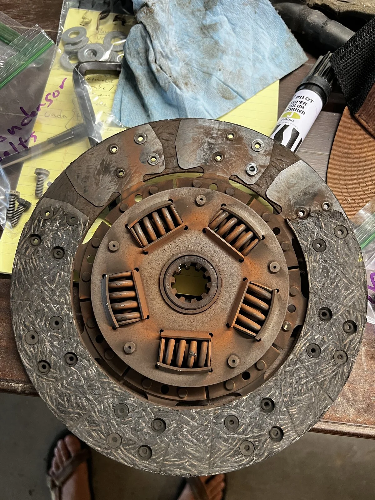

That wasn't balanced at all. I'm guessing PO that didn't use the centering tool or tighten in a star pattern... Was there any noise?

Honestly the clutch worked fine aside from a little shudder on takeoff. I really do need a build thread for him

The alignment tool had nothing to do with it. Once the input shaft goes through the clutch disc and registers in the pilot bearing, that is as straight as it will ever get and it won't do that unless it is straight to begin with. That and the first time the clutch pedal moves the pressure plate to disengage, the disc is free floating on the shaft and any misalignment would be instantly corrected at that point.
That is just wear and tear, nothing more.
Today I learned, I'm just surprised how lopsided it is. But I've only changed a few clutches in my life.
Manuals are funny beasts. We all see the same reports of noisy throw out bearings and that's how we know they need replacement. We did a manual to auto swap, had to move the rig around several times so we were not aware of any evidence of a bad throw out bearing, no noise, no rough engagement or disengagement, worked just fine. Pulled the trans and all of the ball bearings out of the throw-out bearing were laying in the bottom of the bellhousing. Given the amount of greasy goo that stuck them in place, they'd been there more than a few days.

I found the rest of the clutch!
I've seen similar but a lot more of it. Moving company I worked for was towing a medium duty gasser over to the shop to work on the brakes which were completely shot. Somehow they neglected to consider how the rig would stop. The owner's daughter was driving the towed rig, was about to run into the back of the tow rig, dropped it in 3rd gear and dumped the clutch. It fully exploded the clutch disc into a very large pile of fur.
