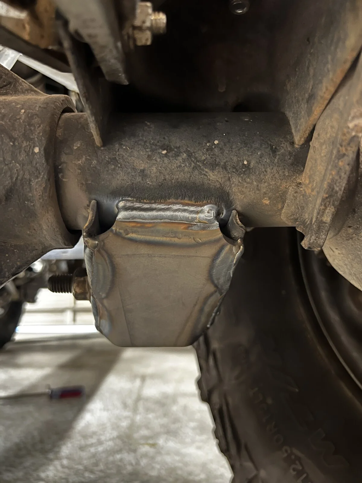

Forgot I still needed to weld on an exhaust hanger and mini skids for my dads Jeep. The weld to the tube isn’t perfect but it isn’t horrible swirly twirly gumdrop shit either!

A tiny bit warm for that position. Next time, instead of pointing straight in, angle upward slightly holding right at the edge of skid.
