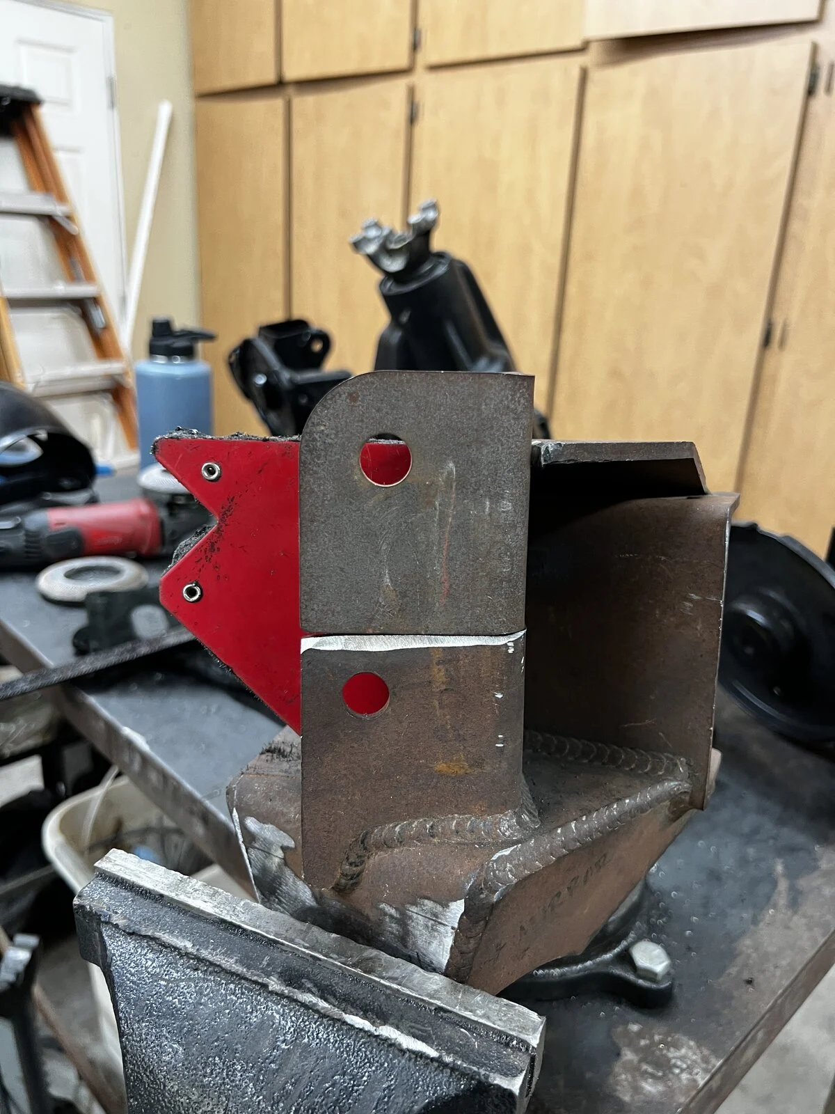

And done.
To summarize, I used a 2.5” holesaw because that’s what I had into 3/16” steel. Then shaved them down to around 2” diameter. Weld them on and trim up to the weld. You now have 5/16” thick material getting drug through rocks instead of 1/8”.

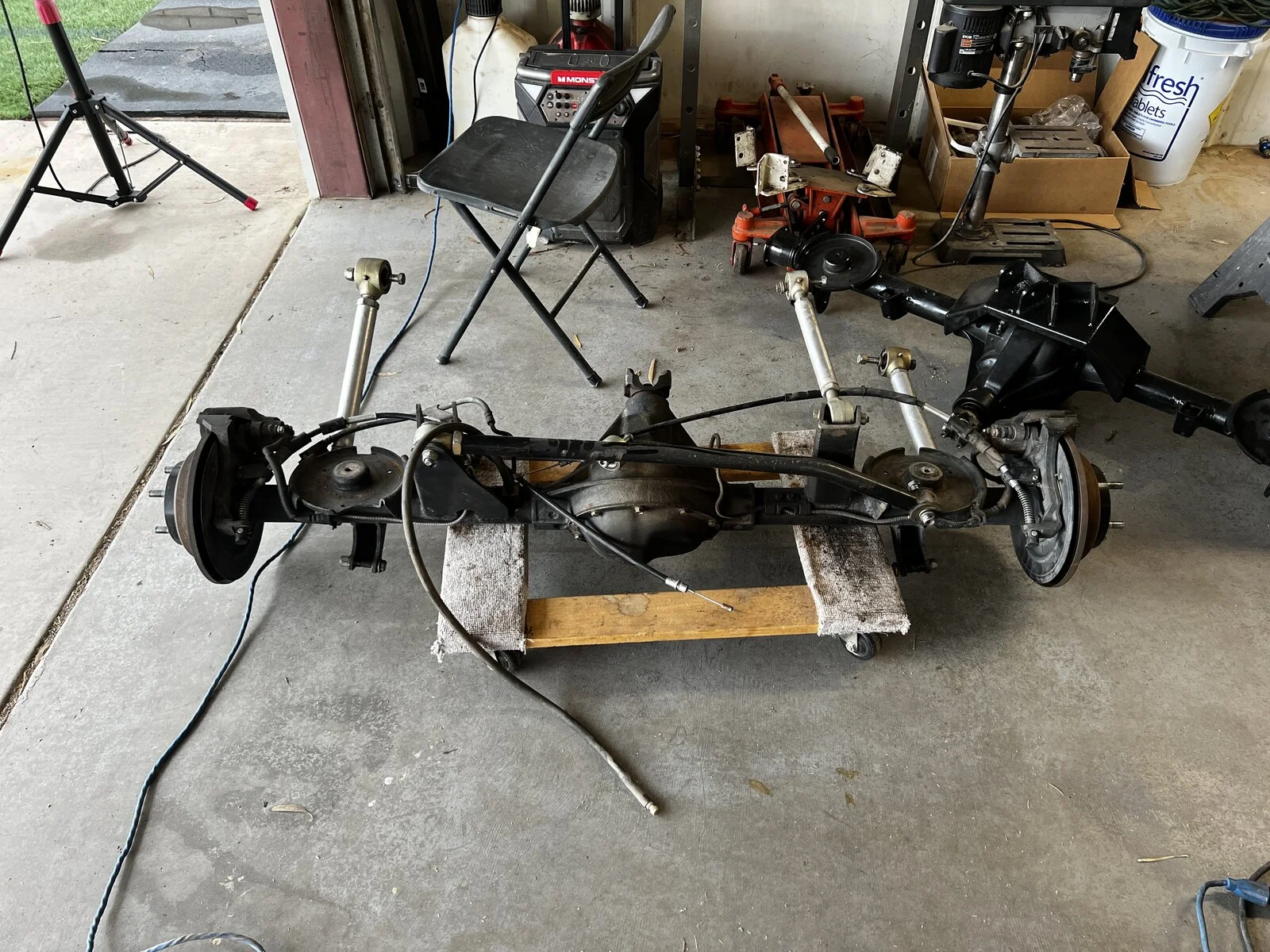

Correcting the geometry on the brackets that will replace my geometry correction brackets and give me correct geometry
This is as far as I got today. Extending genright 4 link brackets to match savvy’s midarm brackets.
Is this on the DCSD project axle?
