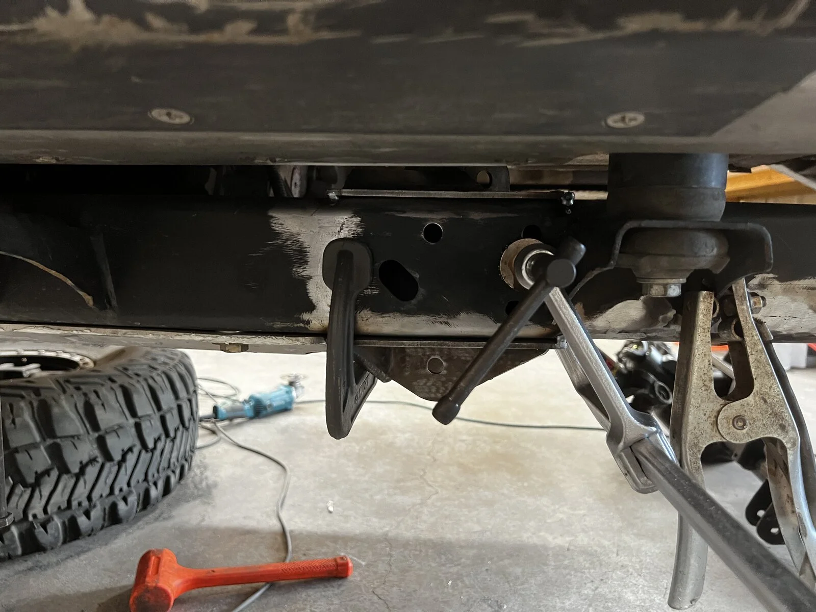

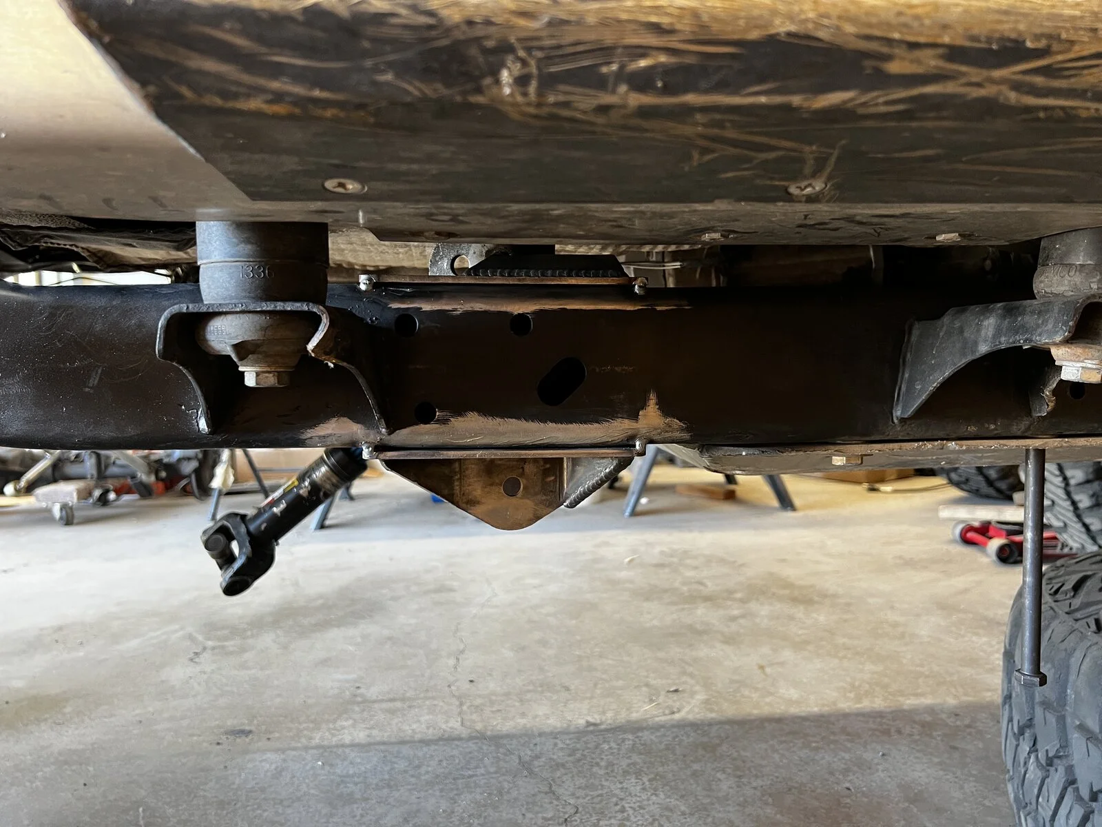

Pretty neat, by using a mini air powered die grinder with a cutoff disc, I was able to easily get the spring perch off without raising the body. I used a standard cutoff disc with angle grinder wherever I could, the die grinder on the inboard rear most horizontal weld, and I also used a sawzall for the inboard rearmost vertical weld.

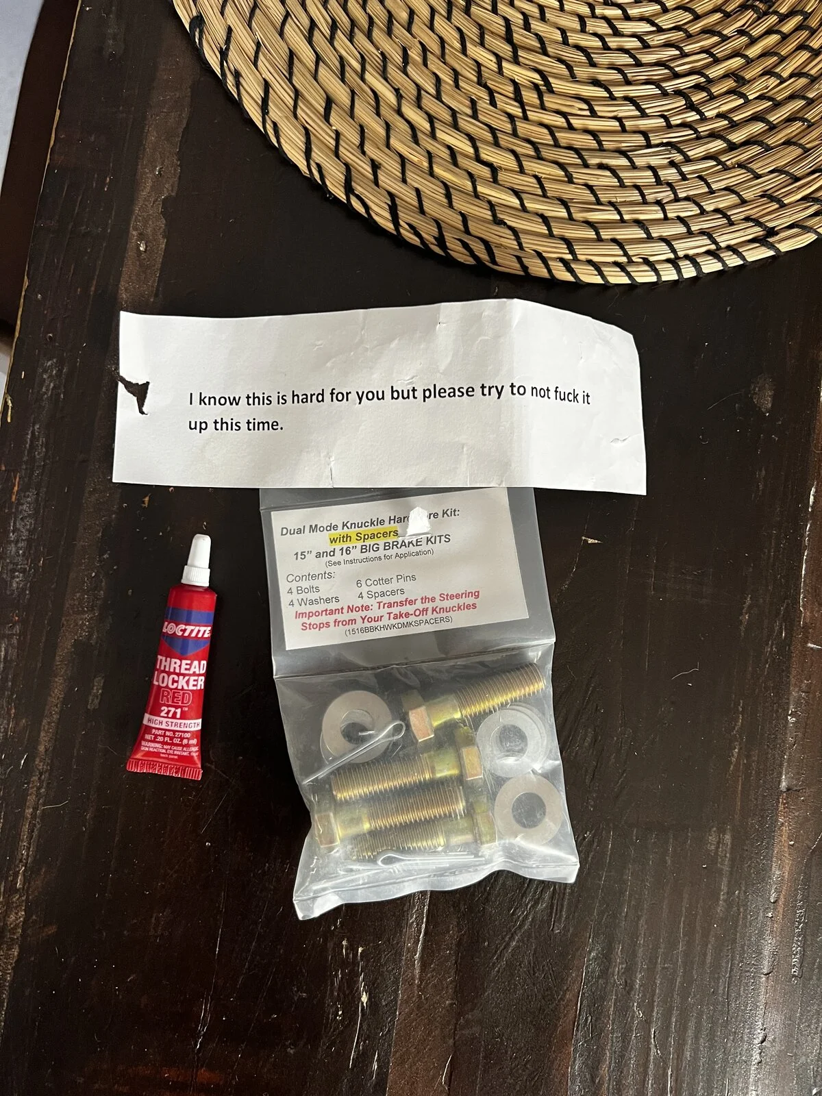

The customer service at blackmagicbrakes.com is unparalleled. Clean your threads and loctite your knuckle to saddle bolts each time you take them off and on kids!

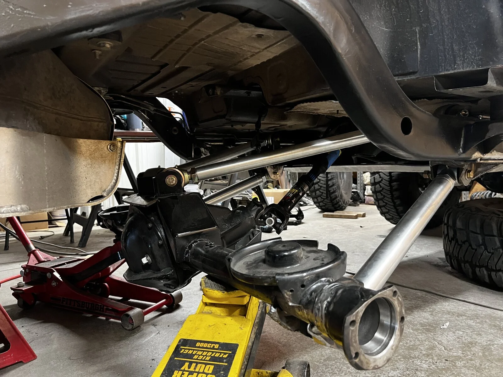

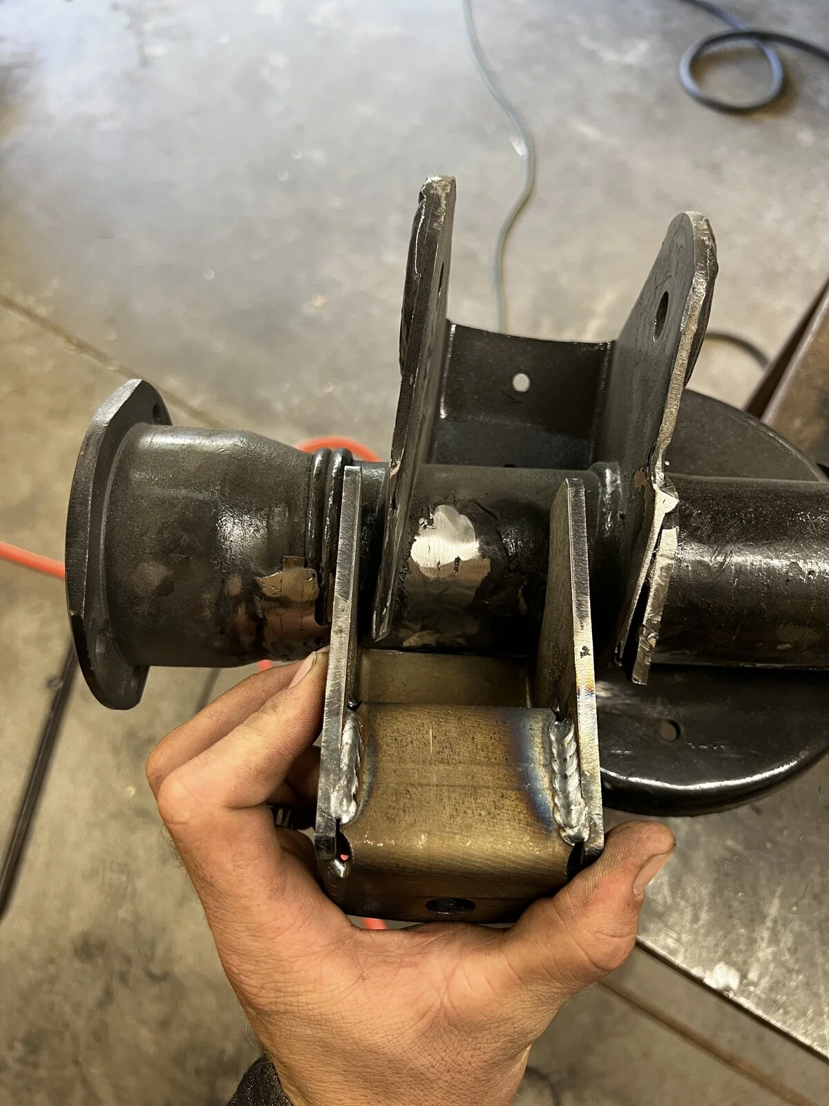

I’m cutting off this outboard shock mount and anti rock tab. The reasoning is that these were one of Blaine’s first outboards and he has since changed where he places the lower mounts. They now go all the way outboard to the rings. This makes it so you don’t have to tip the upper tower out at all and creates more clearance for the tires.
This side done
This is where the shock mounts will live
