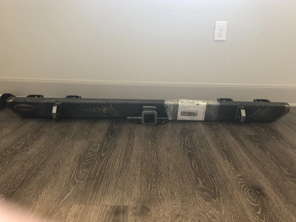

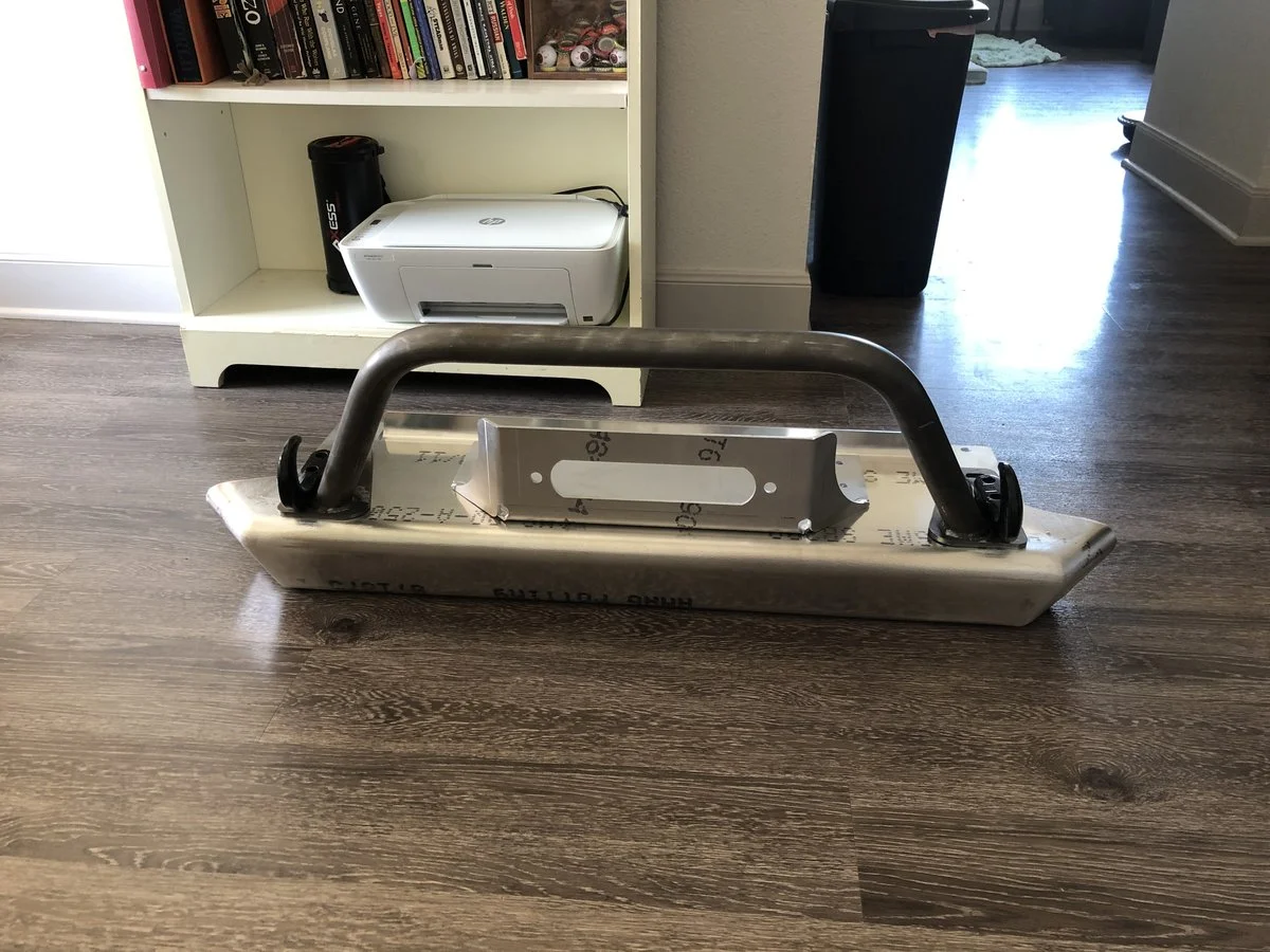

Dirtworx rear bumper came in the mail today so hopefully I’ll have time to paint it soon. Still waiting on the Savvy front bumper and it’s been 4 weeks already...

Put the rear bumper on today! The previous owners left me some very poorly placed holes in the frame from the last bumper for the inside mounts. Going to have to drill the holes on the bumper a little bigger but the bumper is solid for now so just going to enjoy it for a few days and take a little break from working on the TJ

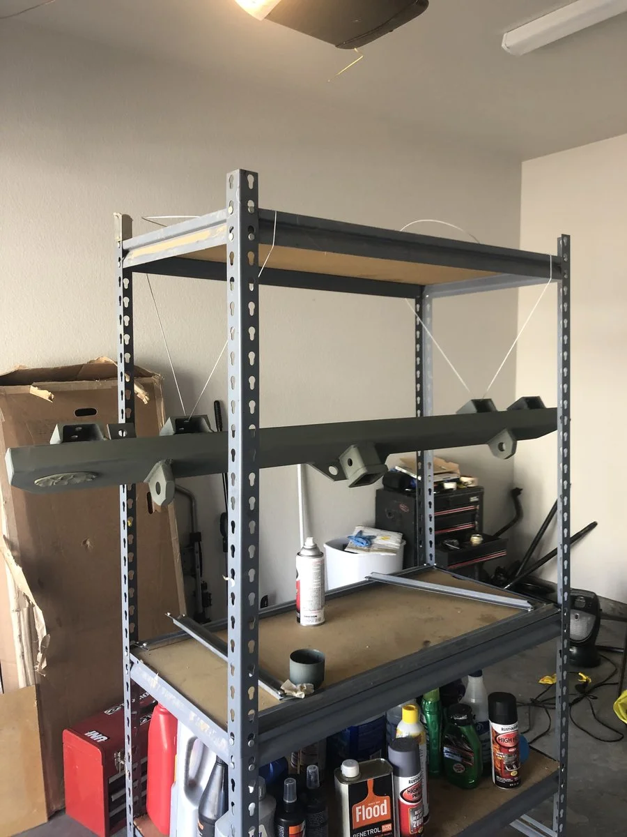

This was my first real paint job and I have to say it looks just as good as powder coating. I primed it with 3 coats of rustoleum self etching primer and then wet sanded with 400 grit paper. Then 4 coats of rustoleum satin black and looks great!

Have to cut off the welded on hitch post to put on the bumper. Previous owners never make it easy on us do they... anyone want to do some overhead cutting? 😂
