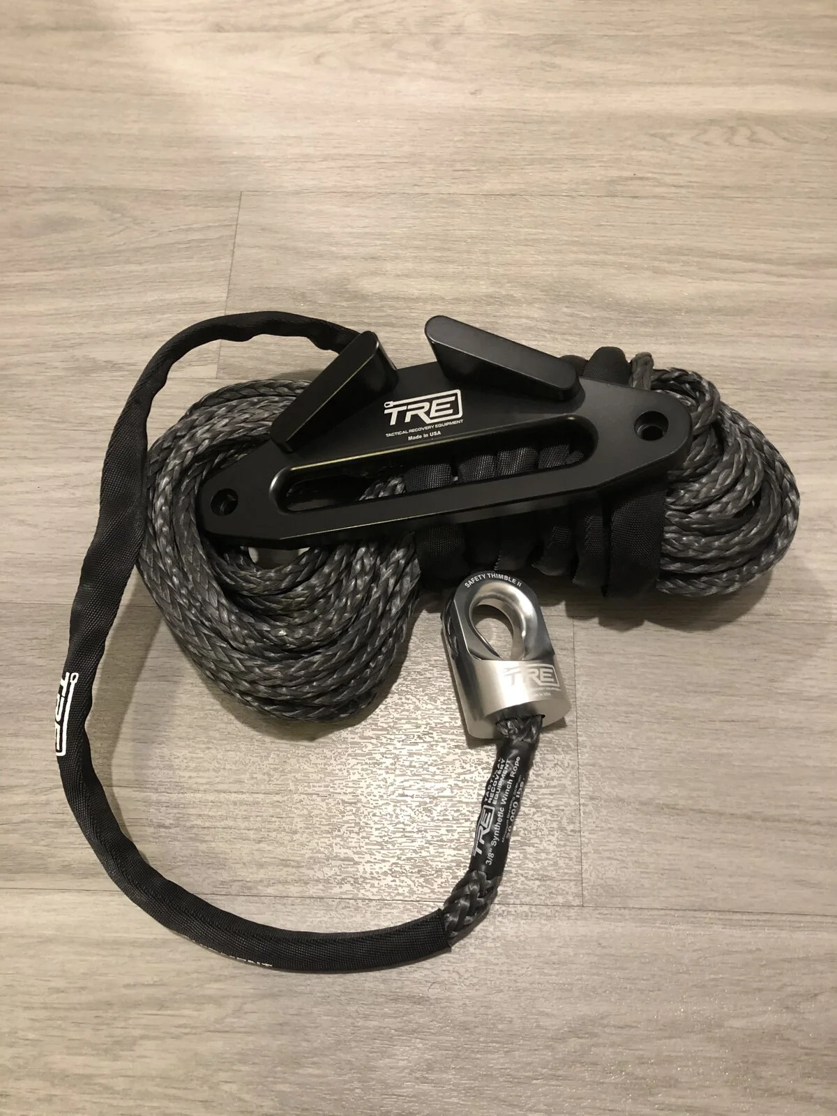

I like my TRE synthetic, though I haven’t used it in a recovery yet. It has been a lot easier to deal with than my old steel cable during the couple times I’ve used the winch for odd jobs since installing it.
First thing I did with the TRE was cut off the shielding with a drywall knife.
