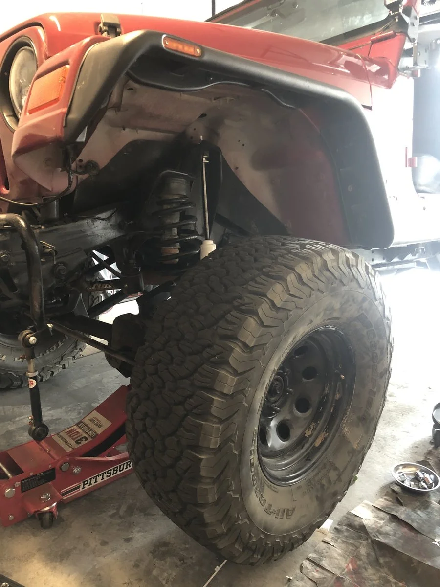

well I decided that while I really want a tummy tuck and Currie lift I should be saving for a house right now... there’s plenty of stuff I can do with my 3 inch lift still. But to compromise a little bit with myself I went ahead and got some Rancho 5000X shocks that fit my lift much better as my old Bilstein 5100s were way too short. I got the Ranchos for a 2-3 inch lift or sometimes advertised as 2.5” and they fit my 3 inches of lift, 1.25” inch body lift, and 33s perfectly with 1 inch bumpstop extension up front and none in the back. I cycled my suspension and at bumpstop contact there is exactly 1 inch of shock left in both front and rear. The shocks also droop to just when my front coils start to unseat but no further. It’s like they were made for my setup lol.
The ride quality on road is noticeably different from my bilsteins but not by a massive amount. Definitely softer.

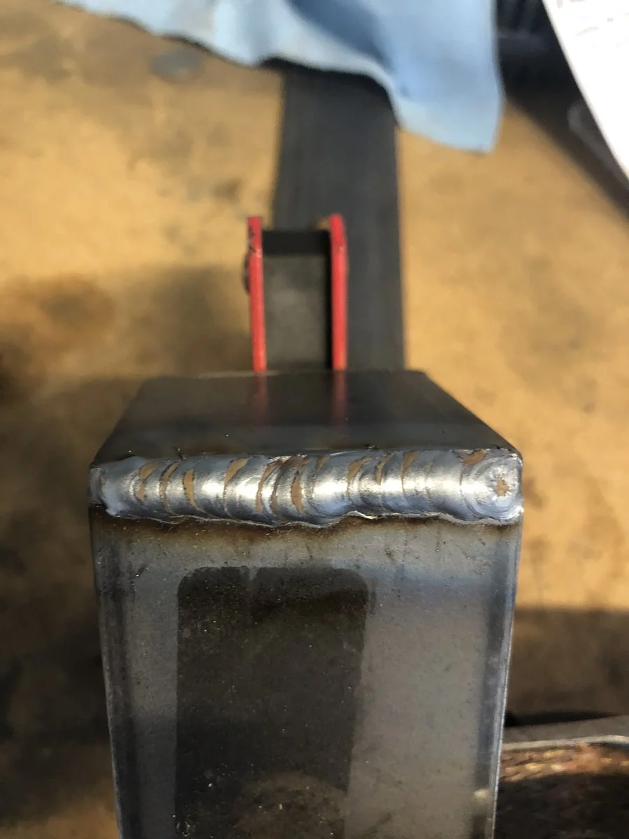

Edit: oh and another life mod I’m working on is learning to weld. My dad has a welder but isn’t really experienced so just going to self learn. Made my first welds for some simple 90 degree brackets to hang stuff on in the garage yesterday. So if anyone has any tips for a barely knows anything welder I’m all ears!
