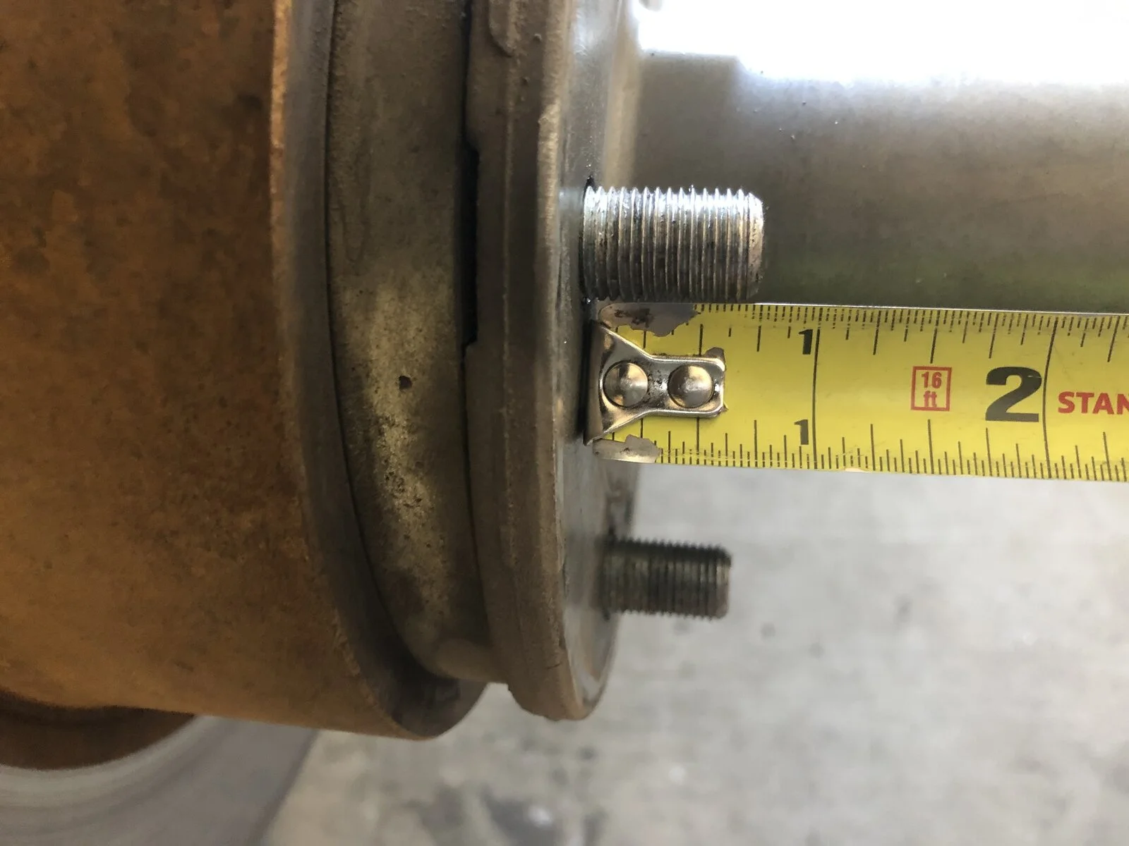

Test fit them in the rim before you use them. You need to make sure the extended nose does not extend past the flat face on the back side of the rim. Or if it does, it can easily go down inside the hole in the locking hub flange.
Got it. 👍
Ordered these. I'll test fit when they arrive.

Thank you. It's exactly the thread I have exposed. Like Blaine said, there's only that one length of stud that properly fits in the hubs. I'm only getting seven turns of engagement on my standard lug nuts, that's why I ordered the ET lug nuts. Are you running extra thread lug nuts?
I’m using normal lugs. I never counted the turns but it seems far more than 7. I have pretty thin steel wheels
