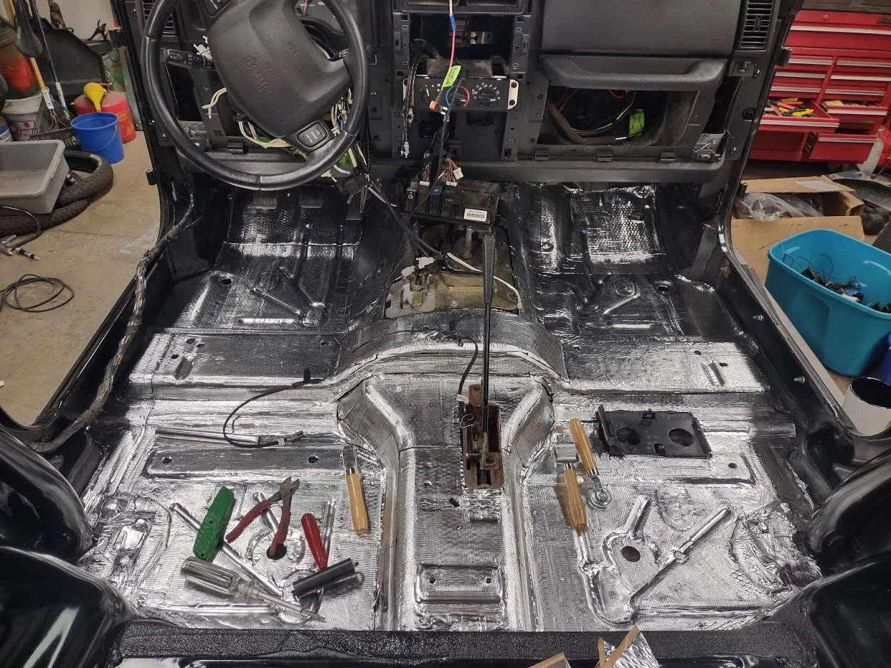

No. Its 100% butyl rubber with an adhesive. Its the same stuff they install RV doors and windows with. I just did my tub with it. I bought two 36 sq in boxes and had PLENTY left over. For a standard TJ, I bet you'd get by with a 36 sq in box and an 18 sq in box. The LJ would probably need 2 36 sq in boxes.
Its not a fun job though...One way only.

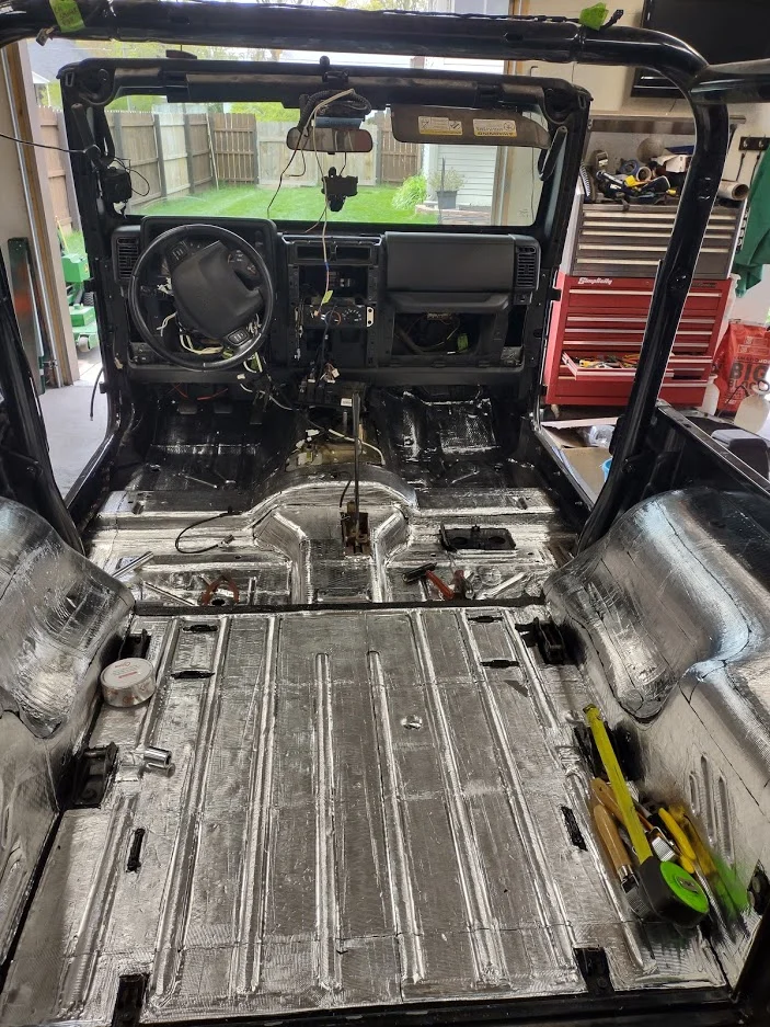

Killing the panel resonance should do WONDERS for the low frequency "noise" that the jeep makes. This stuff is 80 mils thick, and its creates a mass damped system so the panels just don't vibrate anymore. I threw in a set of bedrugs over top and I'm pretty happy with how it looks...I'm looking forward to having better climate control, the radio should be "better" and its just going to be a more comfortable place to be. I'm the guy that will throw the hardtop on for any trip longer than a couple hours though. Working in mfg my whole life, I'm pretty sensitive to wind noise and a top flapping will drive me batshit!
