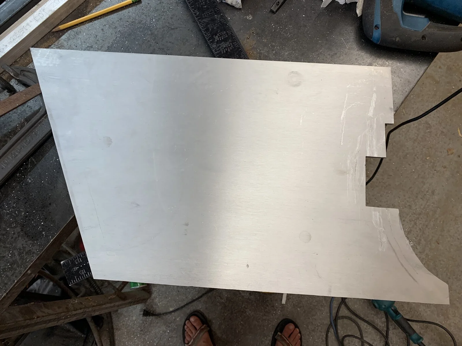

What did you use for the cuts? It looks clean!First rough cut fits pretty well. Still need to bash in the Jeep logoView attachment 267289

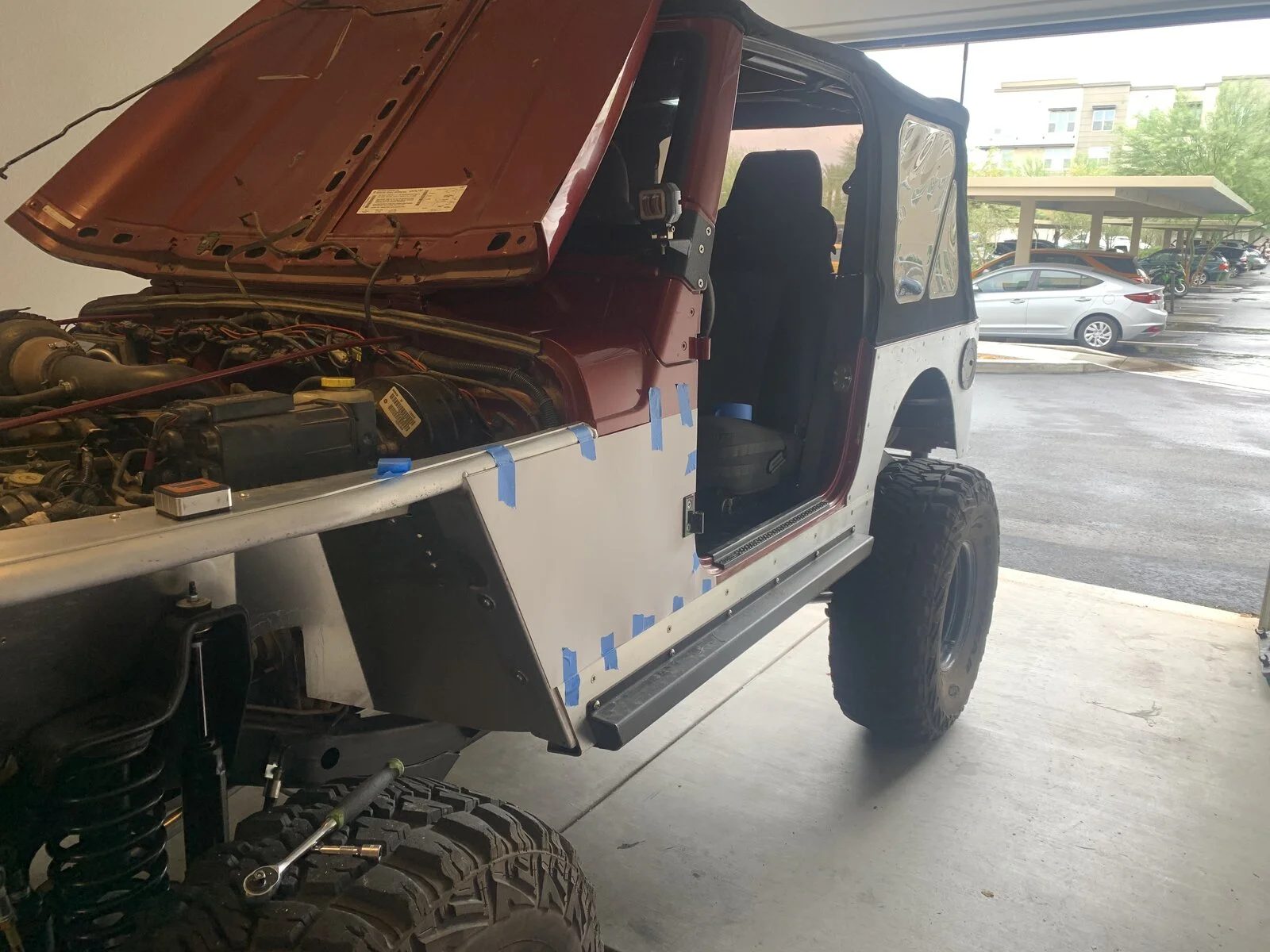

Iām seeing that now. Will have to cut some more!looks good ...............dont forget to leave room to slip the hinge up,
Circular saw and carbide tip blade for the straight cuts, a jigsaw with carbide tips for the curve and hinge cutout.What did you use for the cuts? It looks clean!

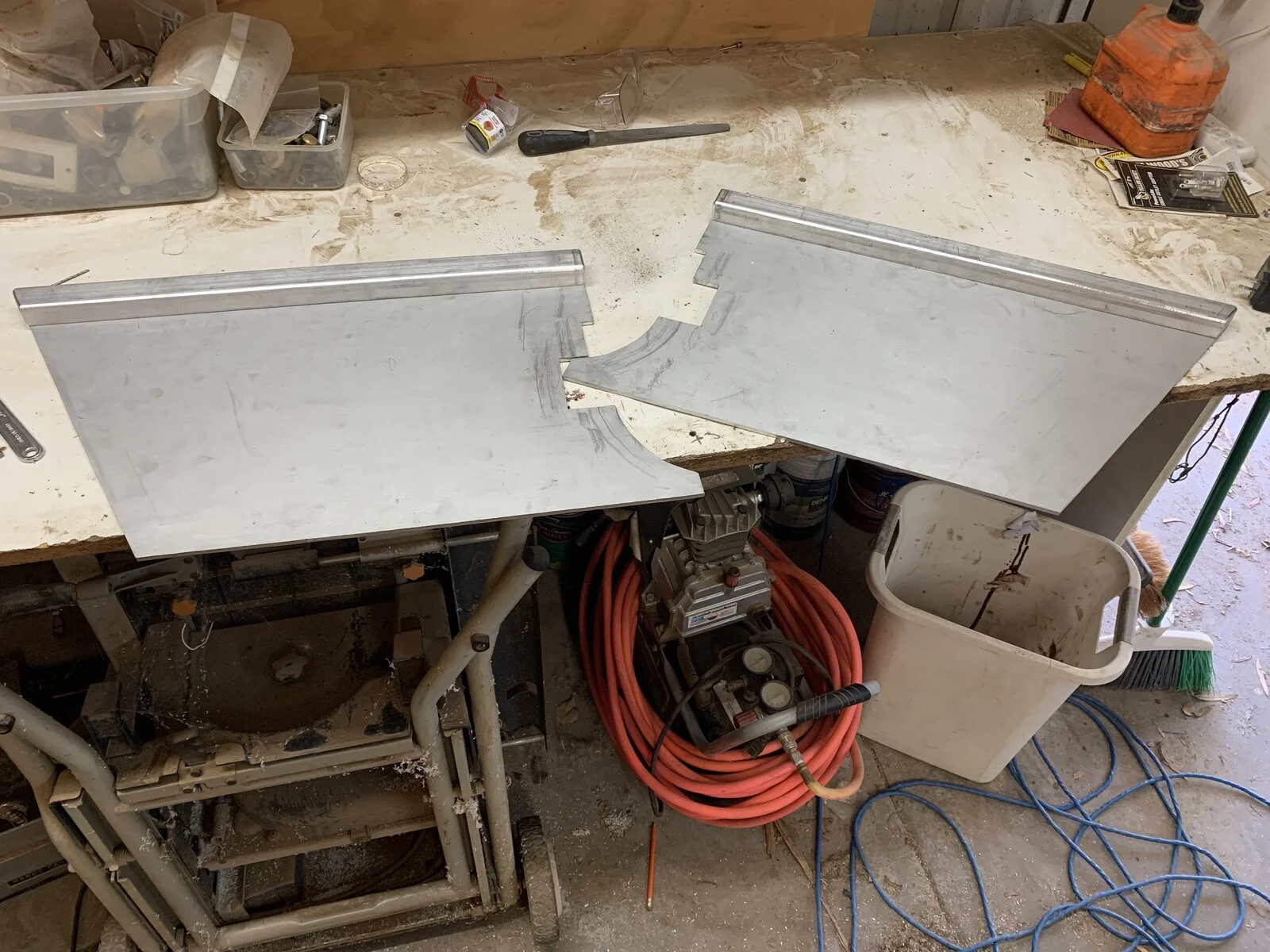

Slide rails? Oooh, Iām making some of those.Got the other side cut today. Will move on to making the slide rails tomorrow.
X2, what are the dimensions of the aluminum rail? And where did you get them?looks good.......... where'd ya get those rails?
The rails I made from 1 X 1.5ā flat bar. Cut with the circular saw, and beveled the edges with a 1/4ā round over bit in a router. I ordered all of the aluminum from Midwest steel and aluminum.looks good.......... where'd ya get those rails?

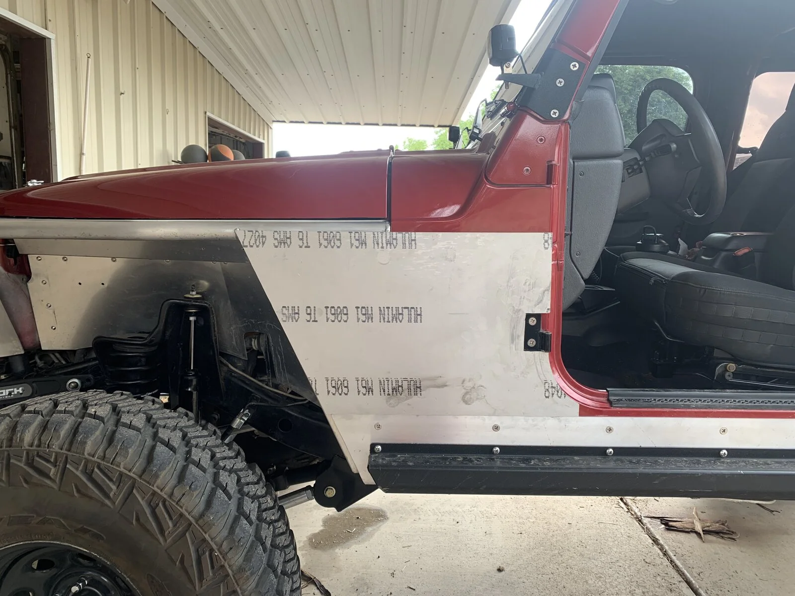

Are you going to work the edge of the Al panel to smooth them out a bit? File might work good for that.The rails I made from 1 X 1.5ā flat bar. Cut with the circular saw, and beveled the edges with a 1/4ā round over bit in a router
Yeah it all fits. Iāve still got some finishing touches to doAre you going to work the edge of the Al panel to smooth them out a bit? File might work good for that.
Looking really good. You probably know, but if you used one panel to sketch the other and then cut on the line, it will tend to be slightly larger, so you have to accommodate for that extra ~1/16". You may have already test fit the panel and be in good shape.
