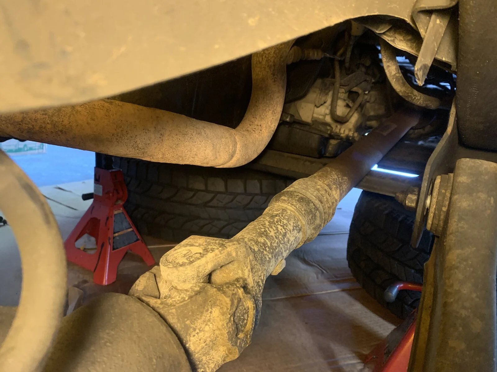

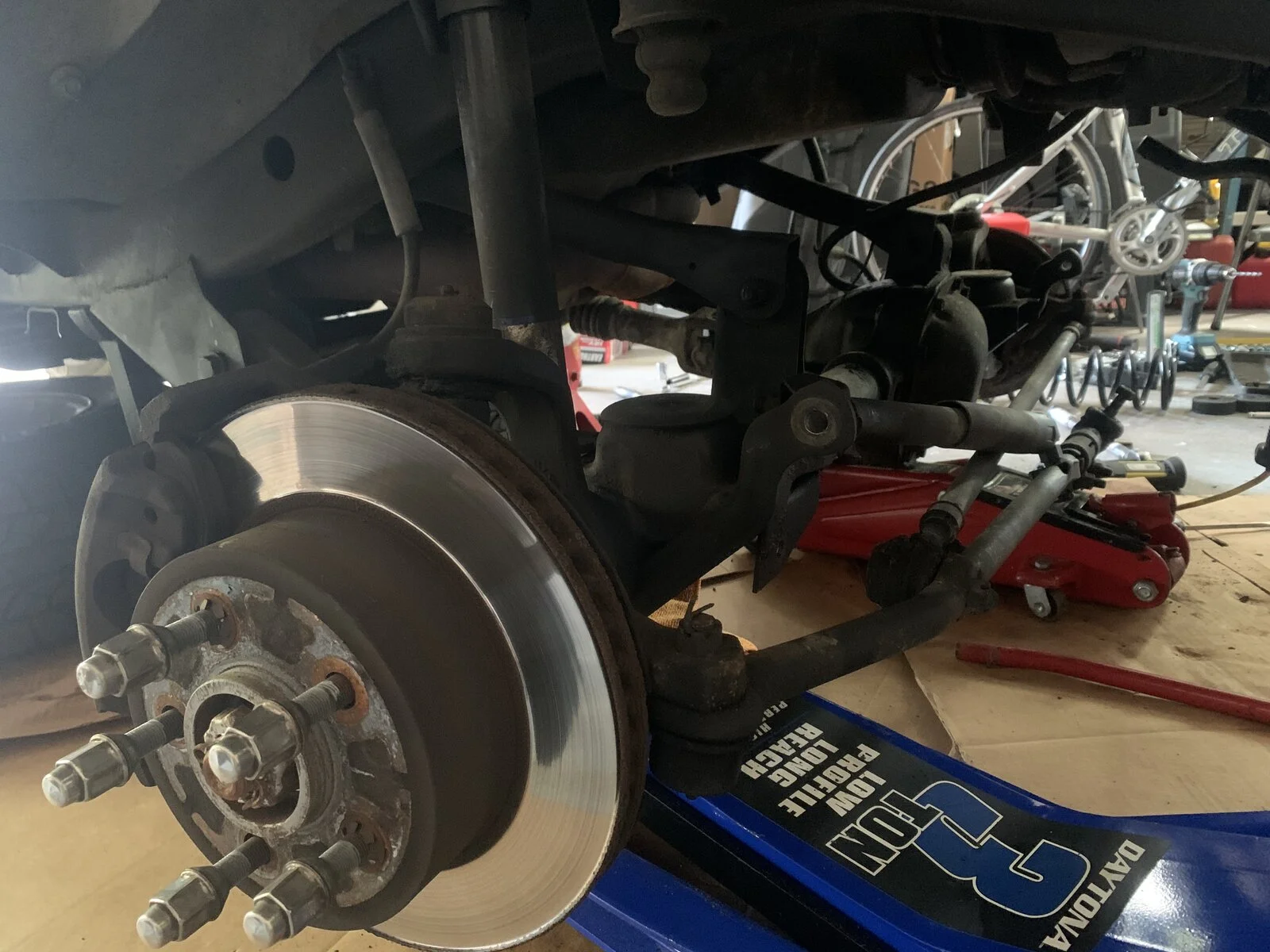

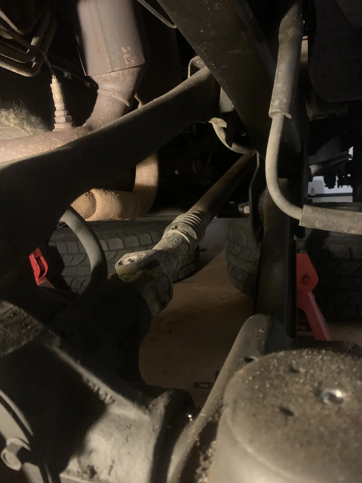

Can’t drop the axle enough to get the new coils installed, looks like the driveshaft is hitting the skid plate and is the only thing keeping it from dropping further. Anyone run into this issue?
Some thoughts...
Sway bar links and trackbar removed/disconnected?
Any chance a jack stand is on the axel providing support so it cannot fully drop?
Good thread to look at.

Yes, sway bar links, shocks, and track bar are fully removed and the drag link from pitman arm is disconnected but still attached to axle side but that wouldn’t cause my problem. I even jacked one side of the axle all the way up until the rubber jounce is against the lower spring perch to lower the opposite side but it still wasn’t enough.
So the draglink is disconnected from the pitman arm, and not the passenger side knuckle...is the draglink connected or disconnected to the steering stabilizer?
I also assume you removed the shocks. Try twisting the springs to see if they are catching on the spring perch.
Post some more pics.

Remove the first 4 bolts on the skidplate, leaving the back 2 half way out and the skid will droop down up front to allow the driveshaft clearance for the axle to hang lower.
Coat all the bolts in antiseize before install. Make it easier should you ever need to remove them again.
Leave all the control arm nuts loose. Even better if you leave all the nuts loose. When finished with install and back on the tires go back and torque all the bolts. This will allow all the bushings to be settled and allow equal up/down movement. Not needed if using Johnny Joints (or similar). After tight use a paint pen (an easy to see color) and lay a stripe down 1 side of the nut and onto the exposed threads. This will make it easy to see if any bolts have loosened. After 100 miles or so go back and retorque them all. Then re-paint them.
That passenger side shock isn’t connected to the axle, I just haven’t removed the top bolt yet to fully remove it

I had the same issue with not enough droop to get the springs out. Just used a spring compressor.

Might be best to go to AutoZone/advanced auto to pick up a free loaner tool, the spring compressor. Will be easy to install with those, and they are free to rent. All Jeeps are different/quirky, and that extra inch one Jeep may have, may not be on another Jeep.
