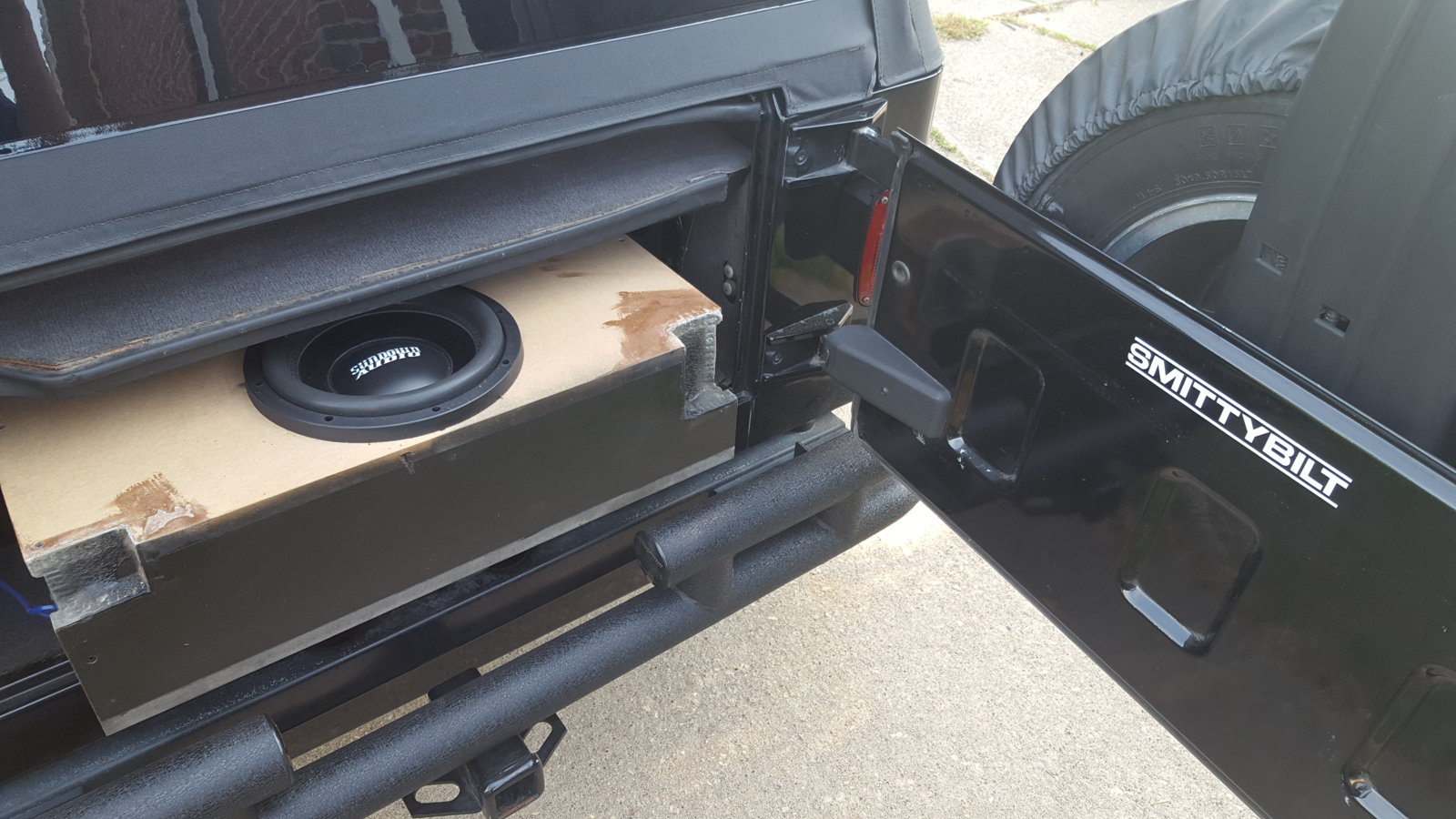

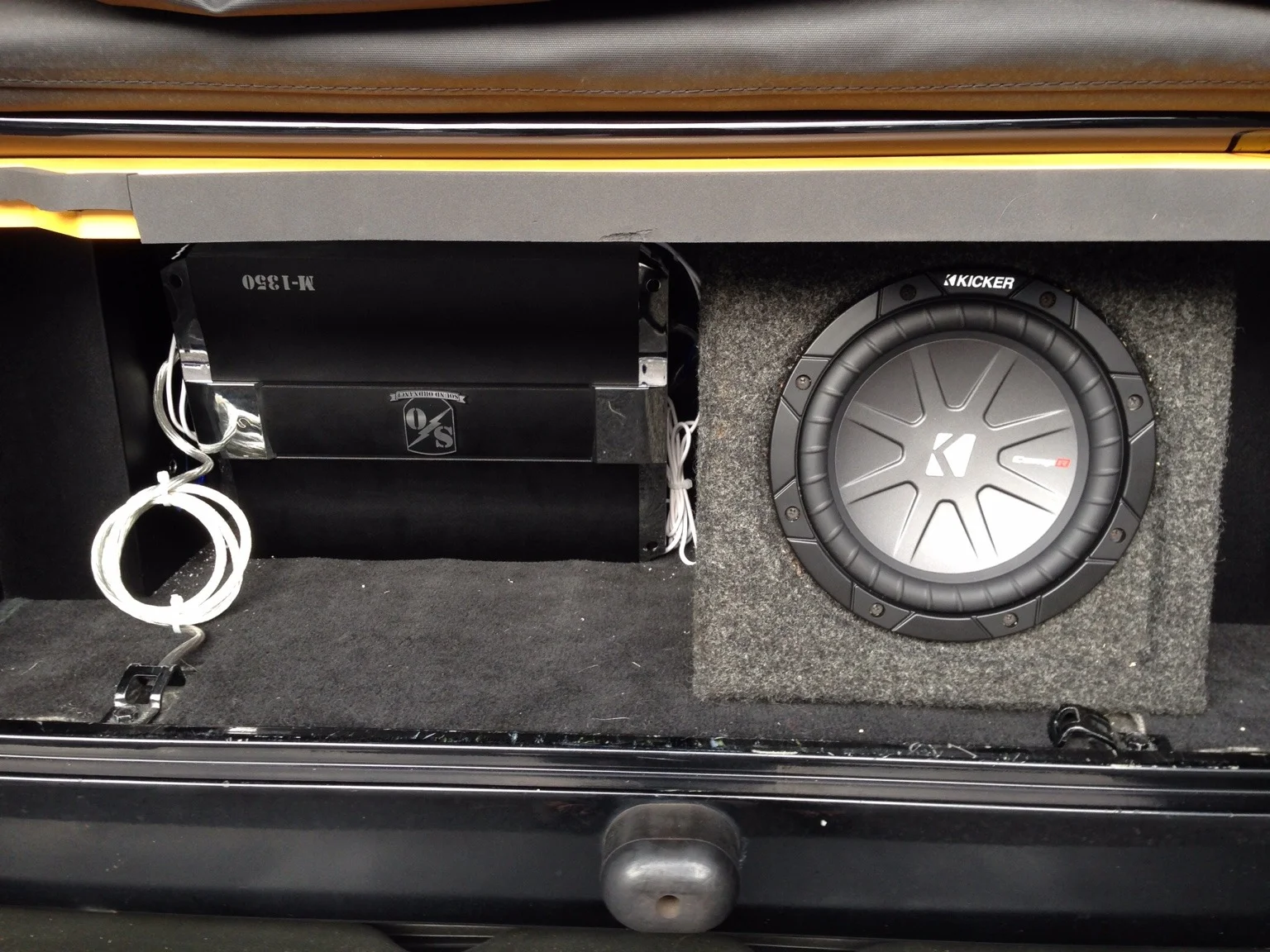

I have my amp mounted to the inside of my Bestop trunk along with an 8 inch Sub. Not tons of room left in there but enough for jumper cables and a few other items.

I have an 8" subwoofer in my trunk, it takes up all of the room tho. My 300 watt Alpine amp is under the back seat, screwed to the tub. I don't have a picture of the amp, and I'm not near my TJ, but I gaurantee it's there. The PO installed this system, which also includes 2, 4x6's in the factory front location and 2, 6 inch speakers in the soundbar. I also should mention that I have the factory installed trunk.
I'd like to modify my set-up, but it's pretty far down on the list. I hate my storage options, but that system sure does sound good.

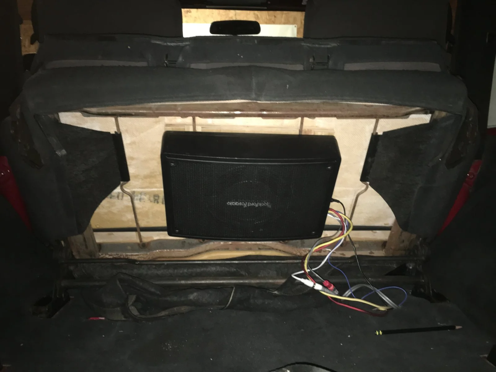

This is a Rockford Fosgate PS-8 with internal 150 watt amp mounted on undersidebof rear seat. It takes up no space in your TJ.
My brother in law, who has run over 3,000 watt amps with 2 gauge wire said it sounds really good. Maybe this isn't what you are looking for. But you mentioned running a sub on a 75 watt amp. That won't do much. This would be far simpler, save space and sound better.

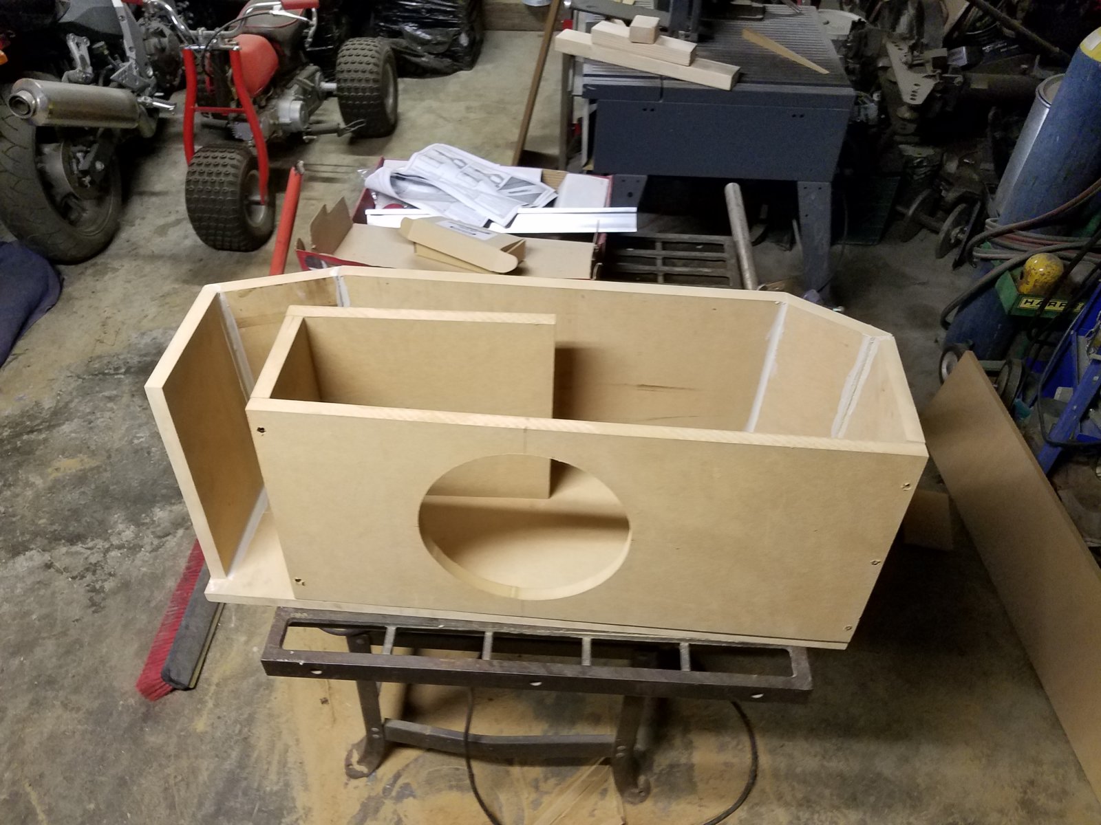

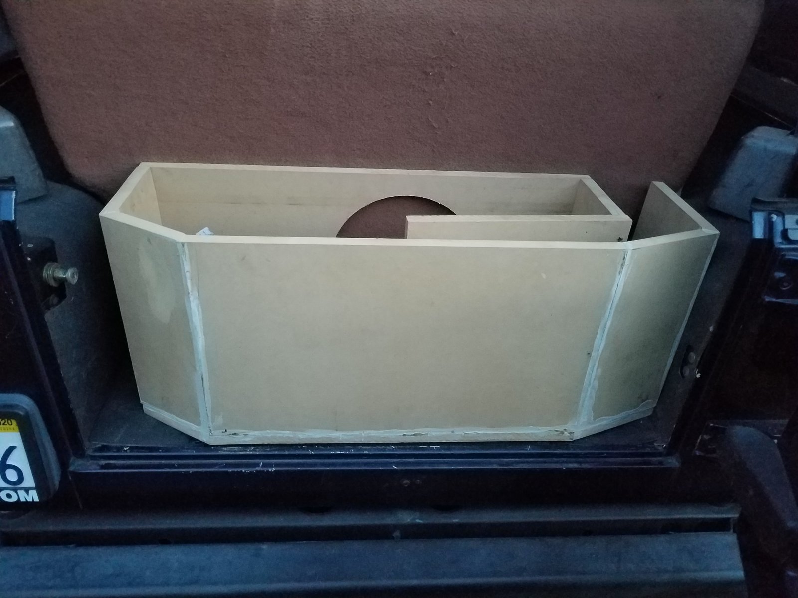

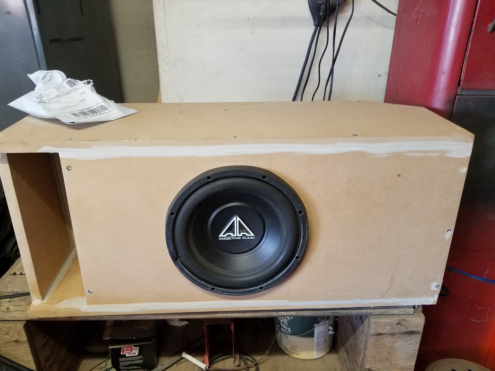

Here is my ported and tuned 10 addictive audio v1 . Does fill up the back .but sounds like a 15 . Running a 1500.1 mono amp
Gorgeous design! Nice woodwork. I haven’t kept up with audio m. I’ve never seen a box like that.
This is a custom design . Ive built a few boxes and this box has what they call a L port .to get the high and low bass . Ive got about $50 in the box and a speaker that was given to me . I might start making these boxes for other jeep owners .
Reactions: JMT
Good idea. If you could make some space saving designs for us TJ lovers that would attract a larger market. Expand into the JK and JL market too.

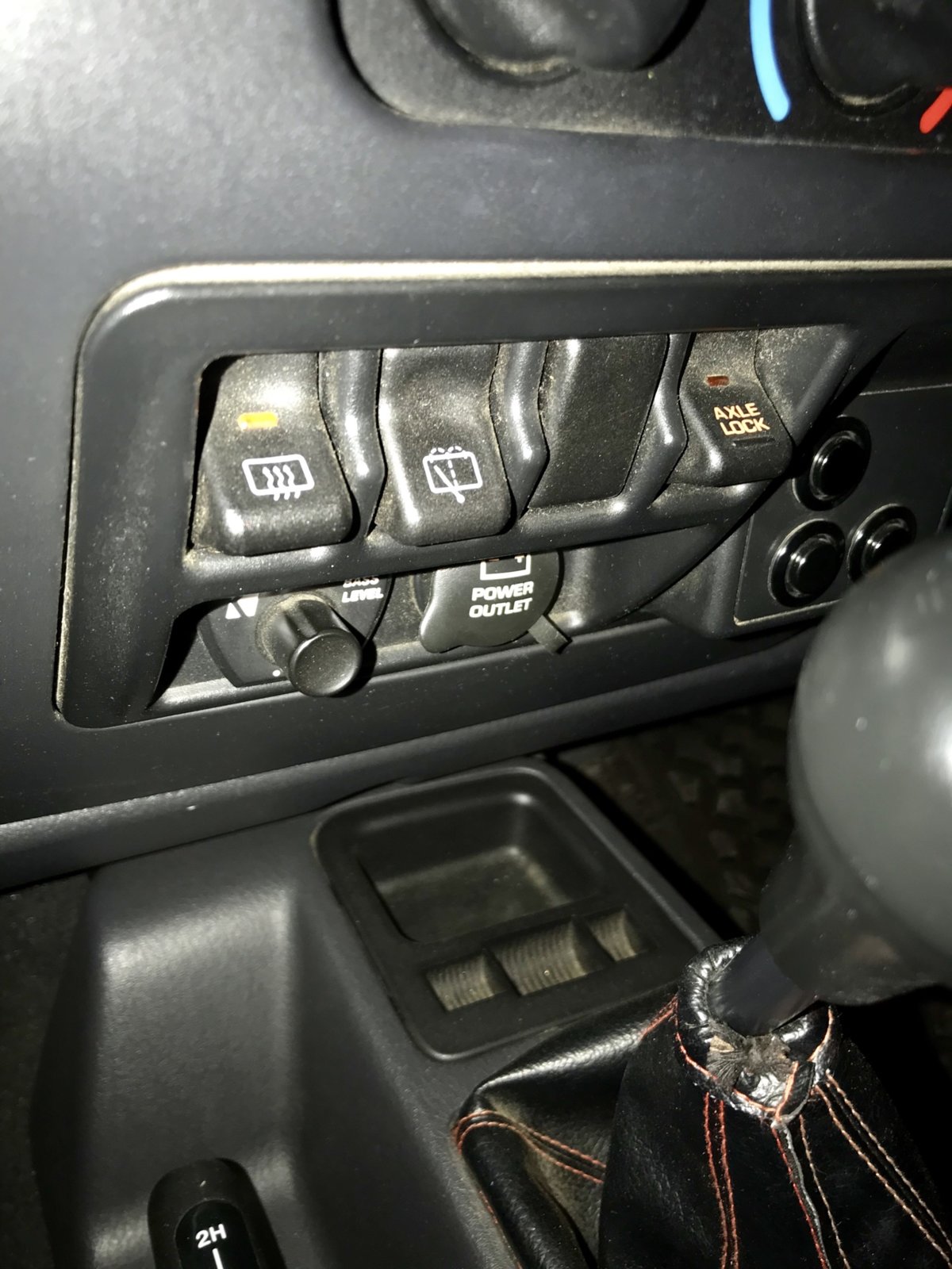

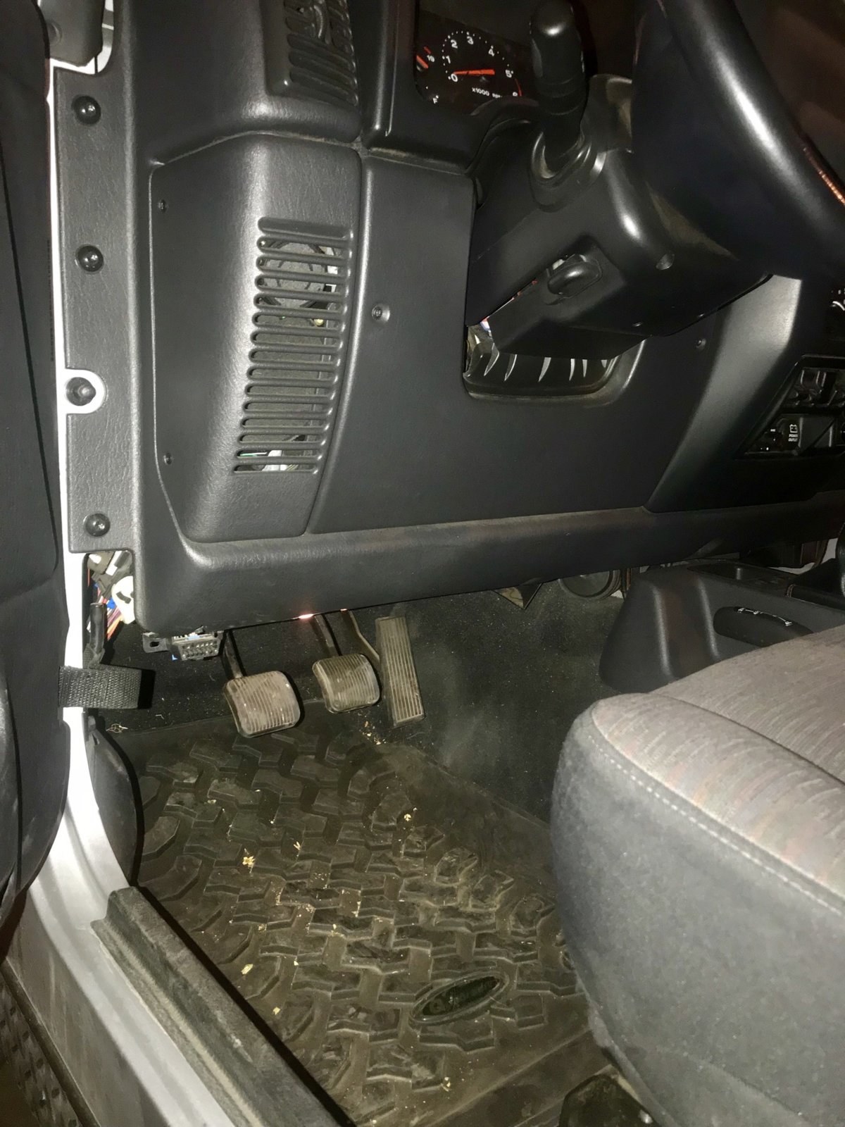

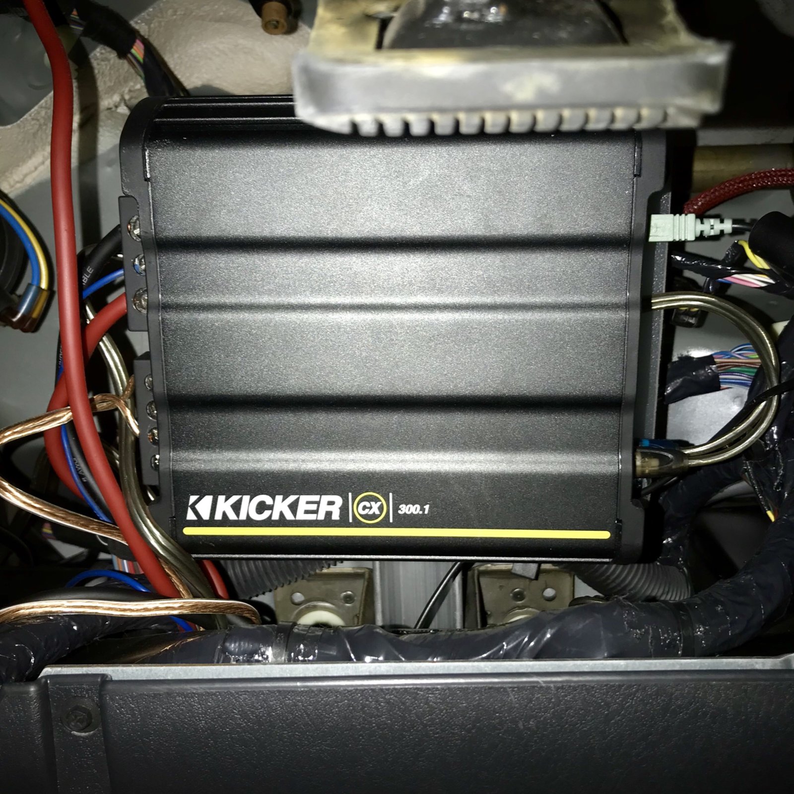

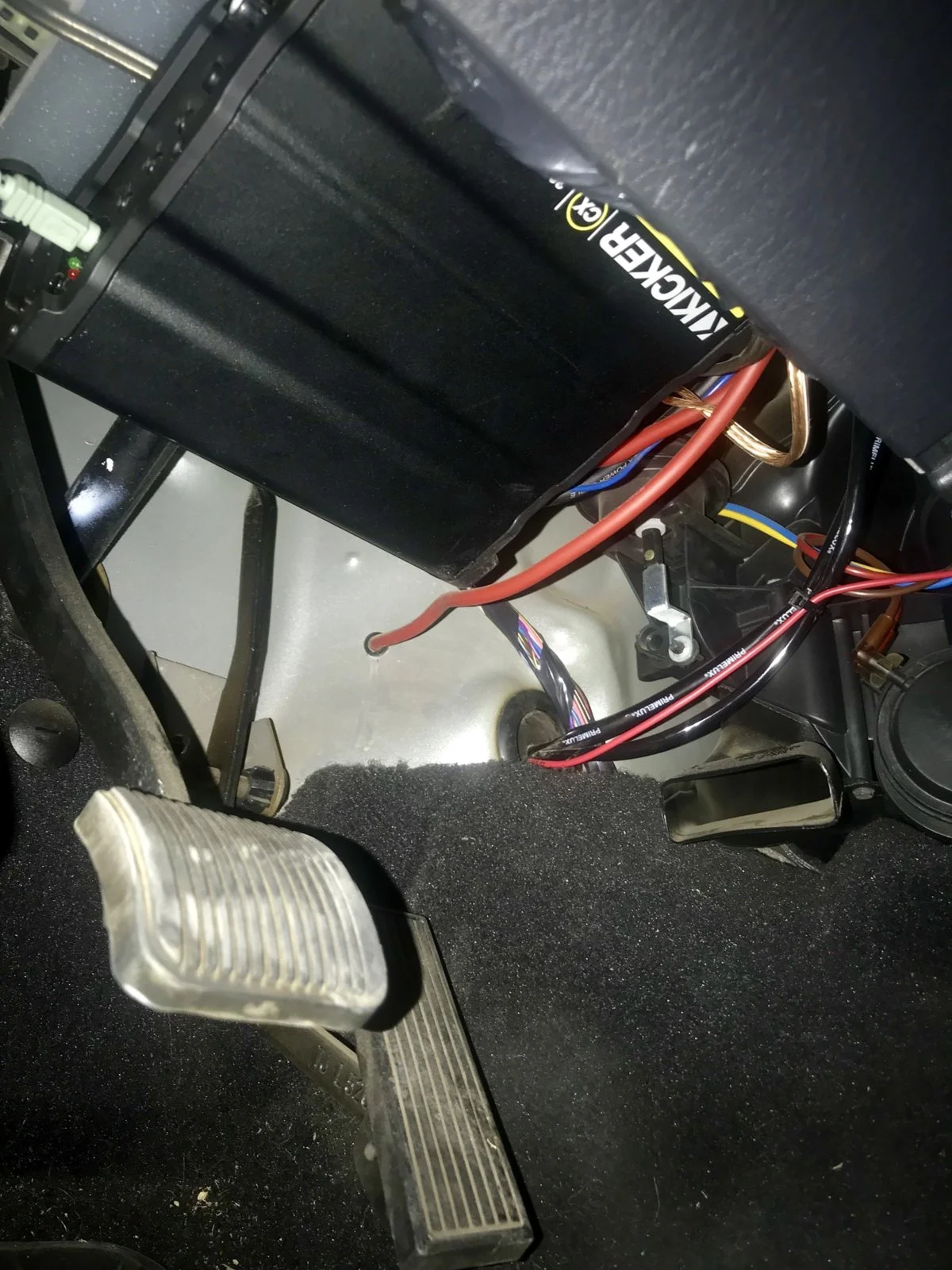

Surprised no one has mentioned under the steering column...
I have a small amp under there that's powering my Kicker sub in the center console. IMO it's the best location for mounting.
Incredibly discreet and protected from any surprise rain.
I mounted the amp to a piece of plastic cutting board and then mounted that to the steering column.
Undetectable without shoving your head under the dash:
Auxiliary gain control:
Nice . I really never thought of hiding a amp there
