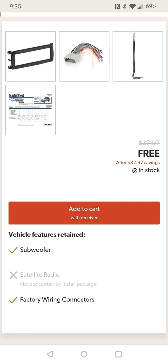

If you order from Crutchfield you get a couple freebies, so factor that into your cost.
