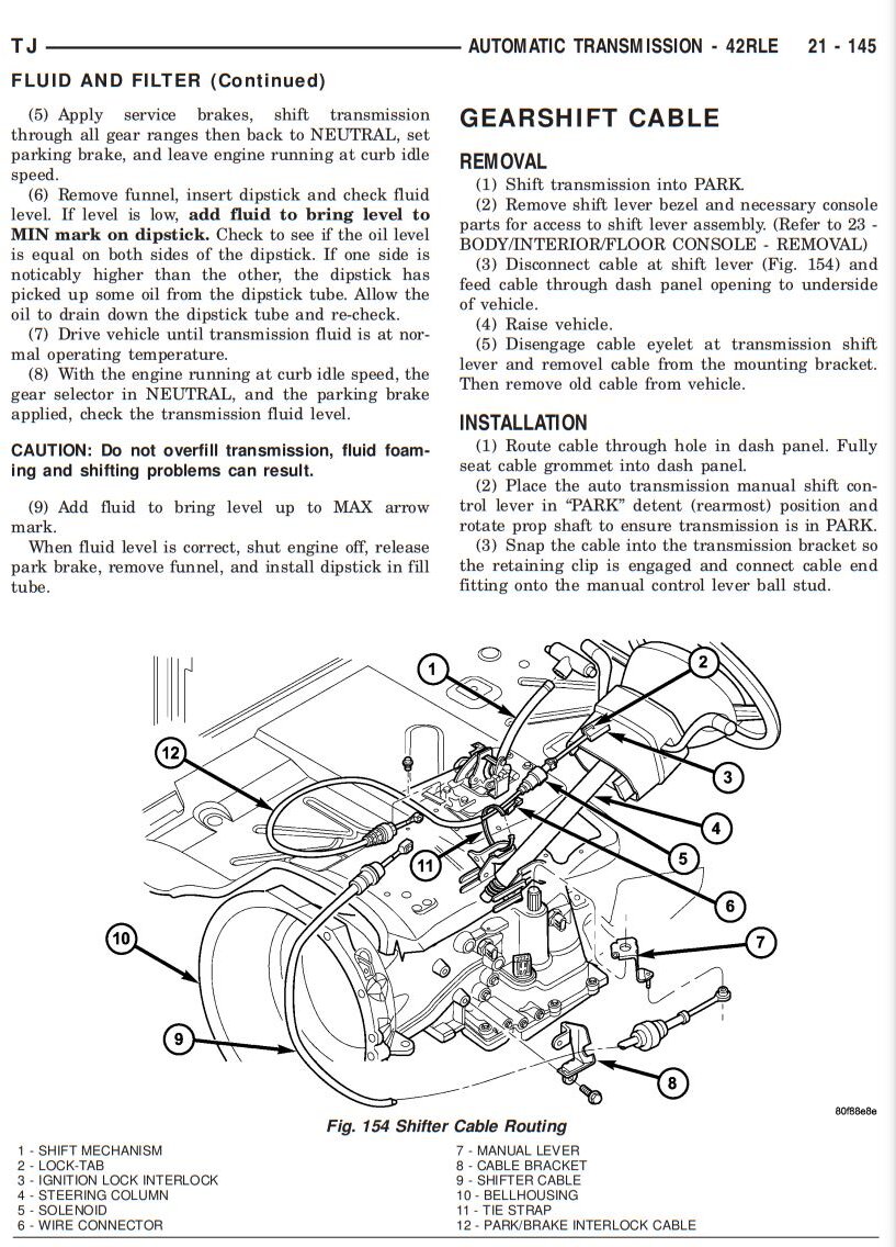

Was quoted $543 to replace. Part looks to be around $125 - $150.
Any have instructions on removing and reinstalling? My mechanic skills are maybe about a 4 out of 10.

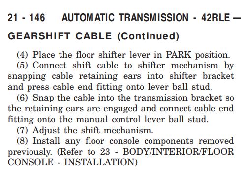

Here you go, I just happened to have copied the two pages you need a couple days ago.
I'd plan on half the day. I've installed a couple shifter cables and they weren't hard but it's not quick job either.
